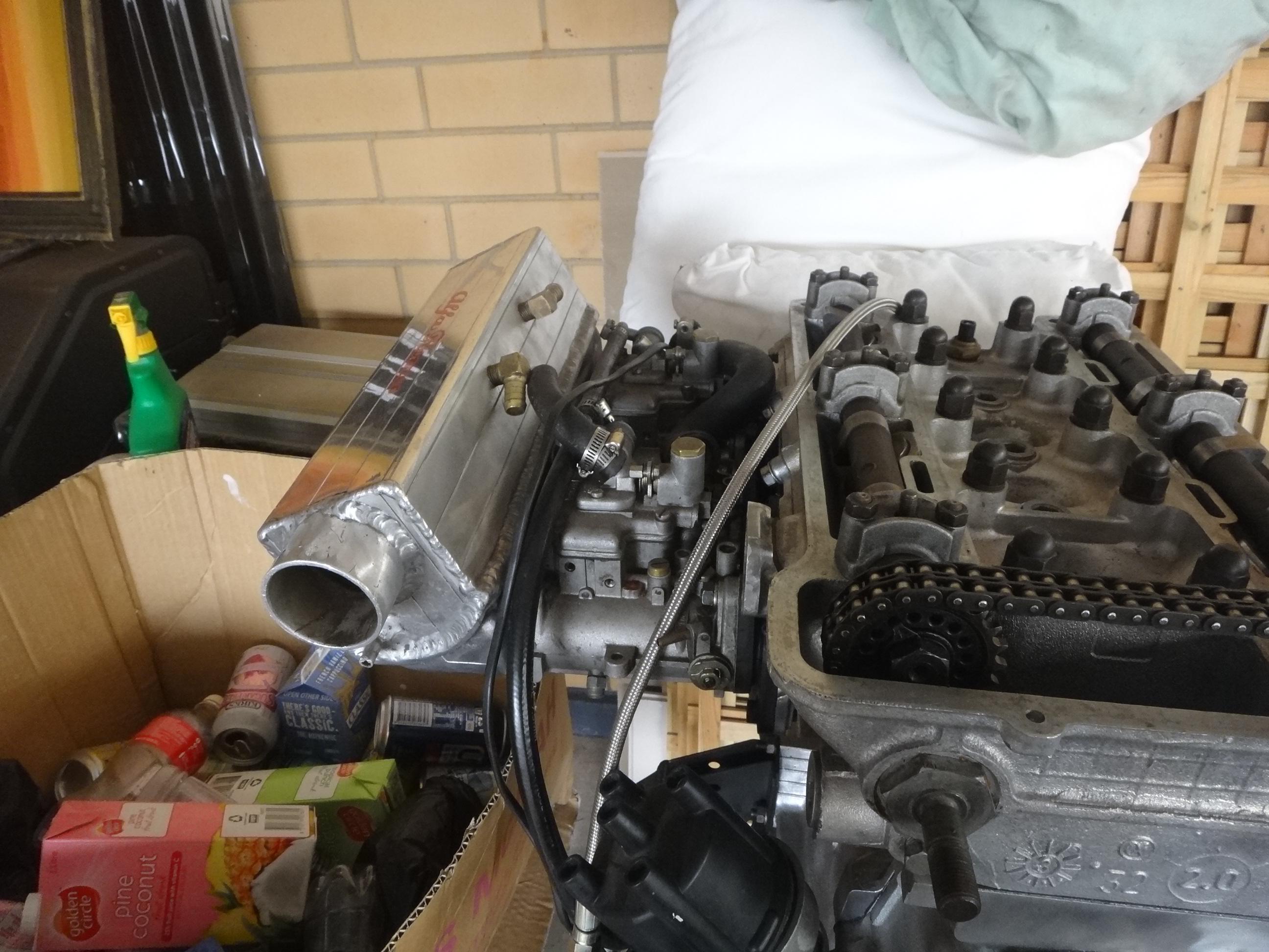

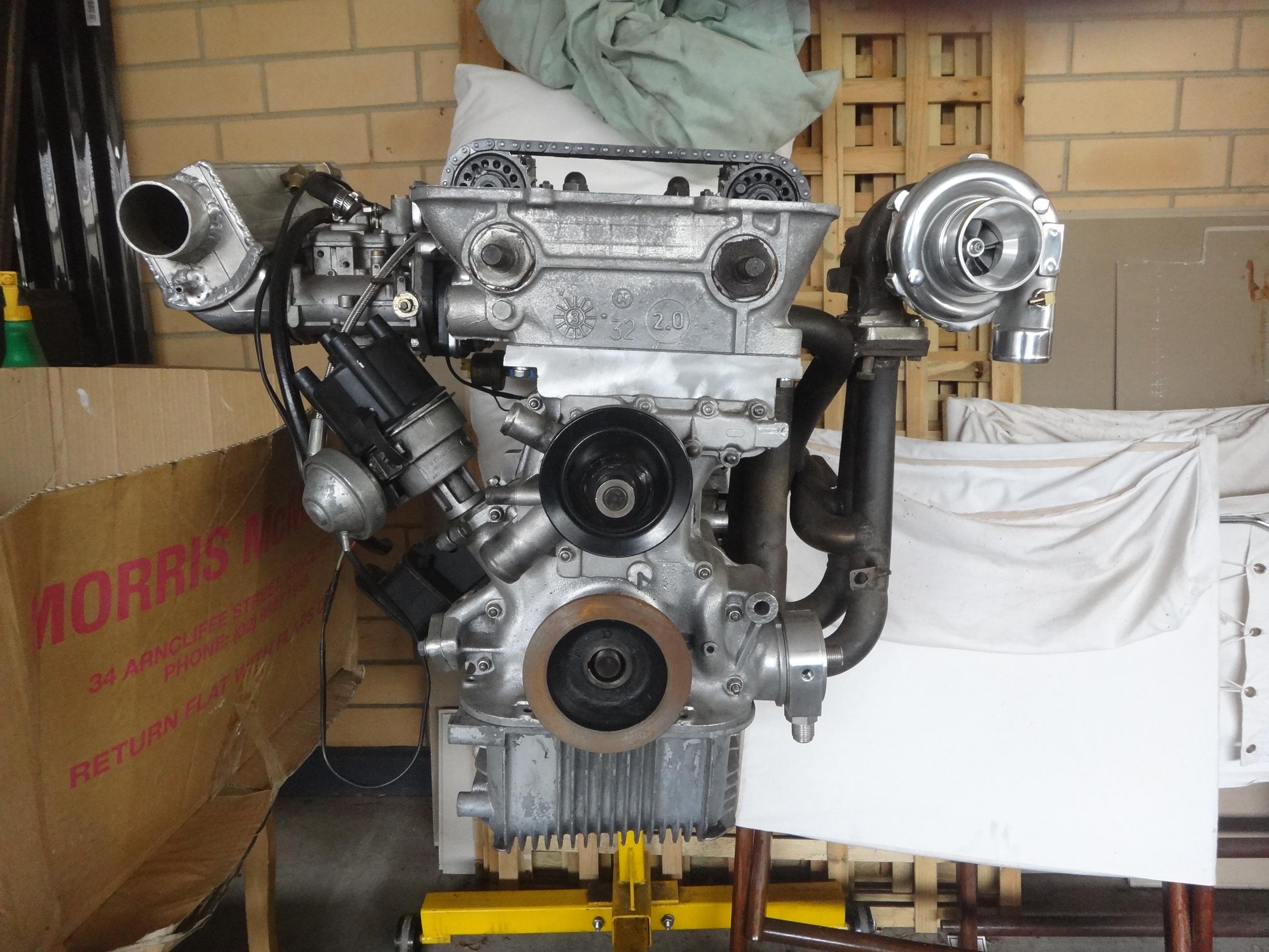

Currently i have rebuilt my 2.0 Alfa engine with flat top pistons to lower compression, water to air intercooler , also i have a twin 40mm side draft dellorto blow through setup (witch constricts me to 15 PSI) and a ebay turbo as dummy fitted.
My plans are to take off the Blow through setup and Modify a n13/camira loom to Suit with a real time ecu, no distributor and run a crank angle to a 1927a DFI module, E85 Fuel , Higher Boost , gt2876r, water / methanol injection and a few other goodies.

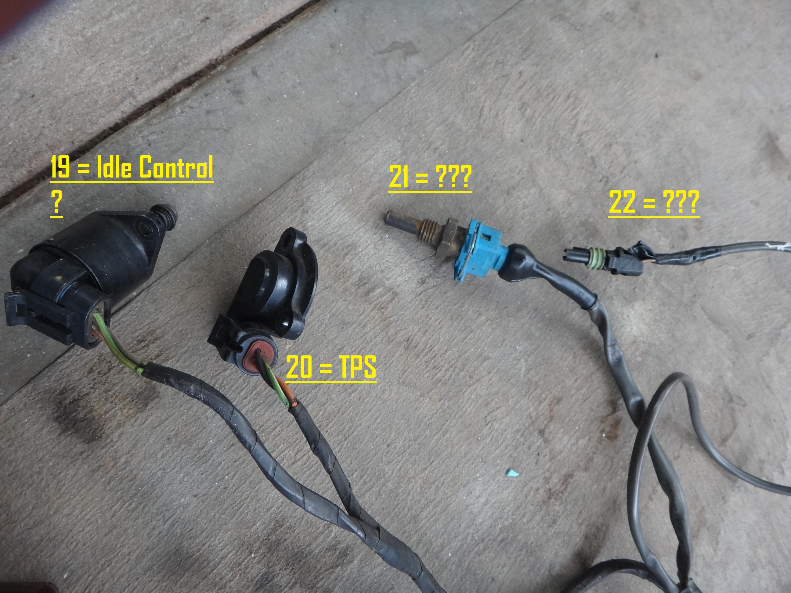

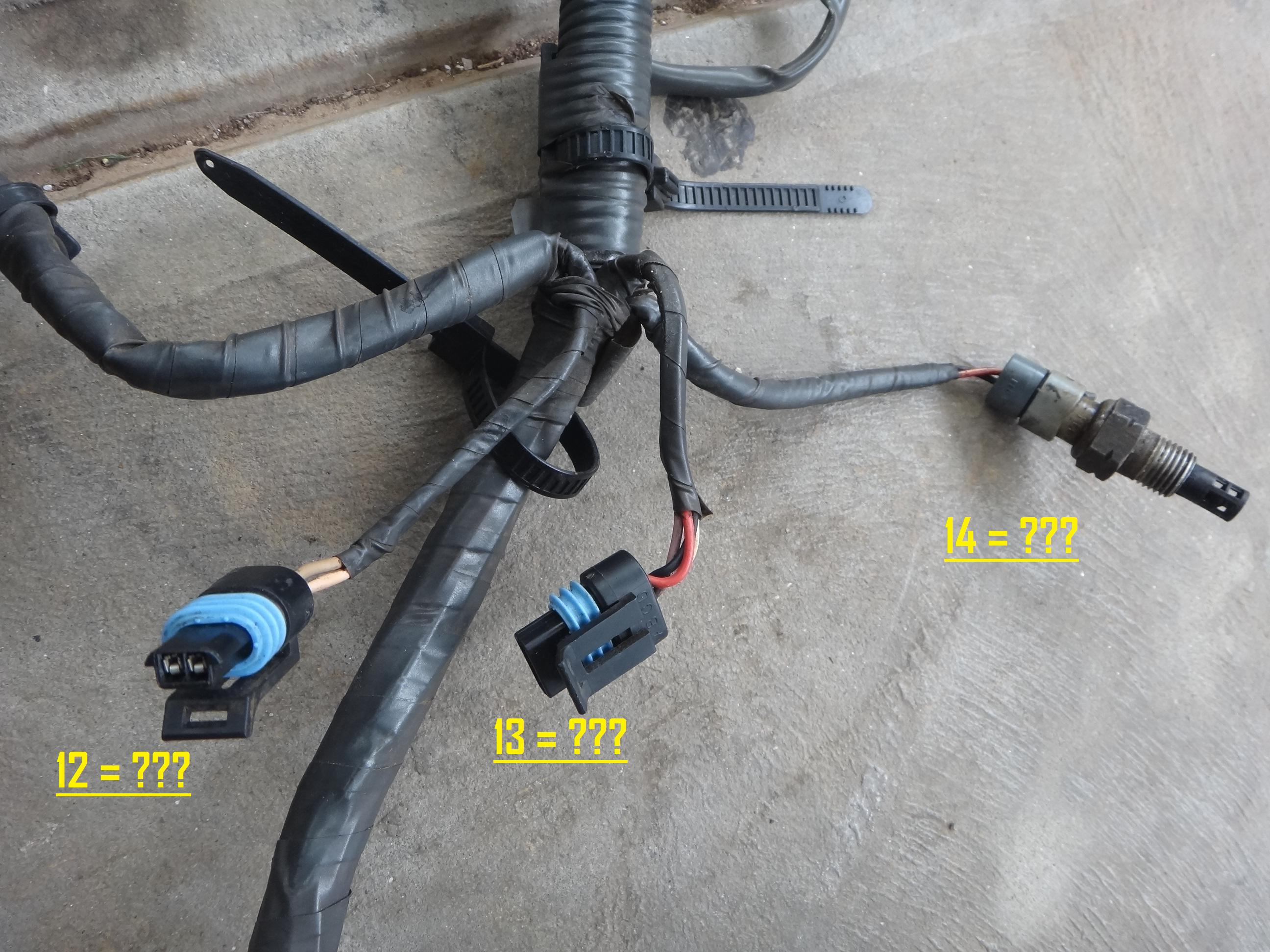

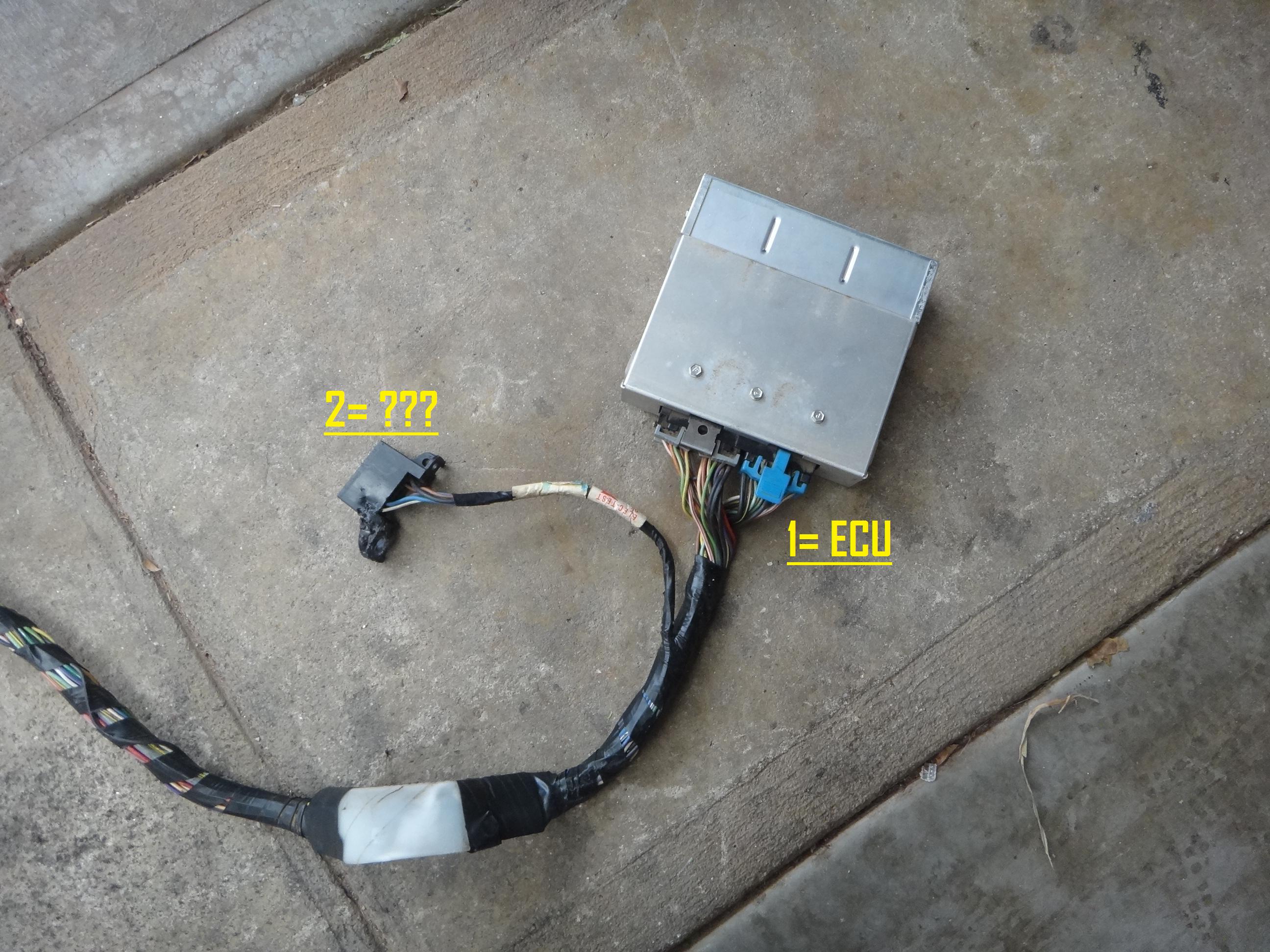

So i want to start off with the LOOM, im not sure on most of the plugs some i am so i need some help.
Please if im wrong or forgoten anything correct me and sorry if i am.
And i hope this is a good starting point for new members also to learn off.

Re: Boosted Alfa Romeo PROJECT
1. ECU
2. ALDL

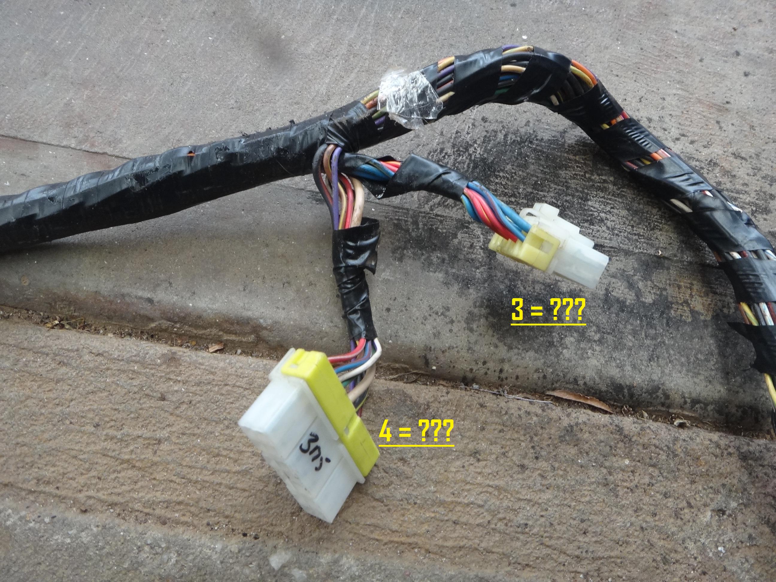

3. DONT USE
4. DONT USE

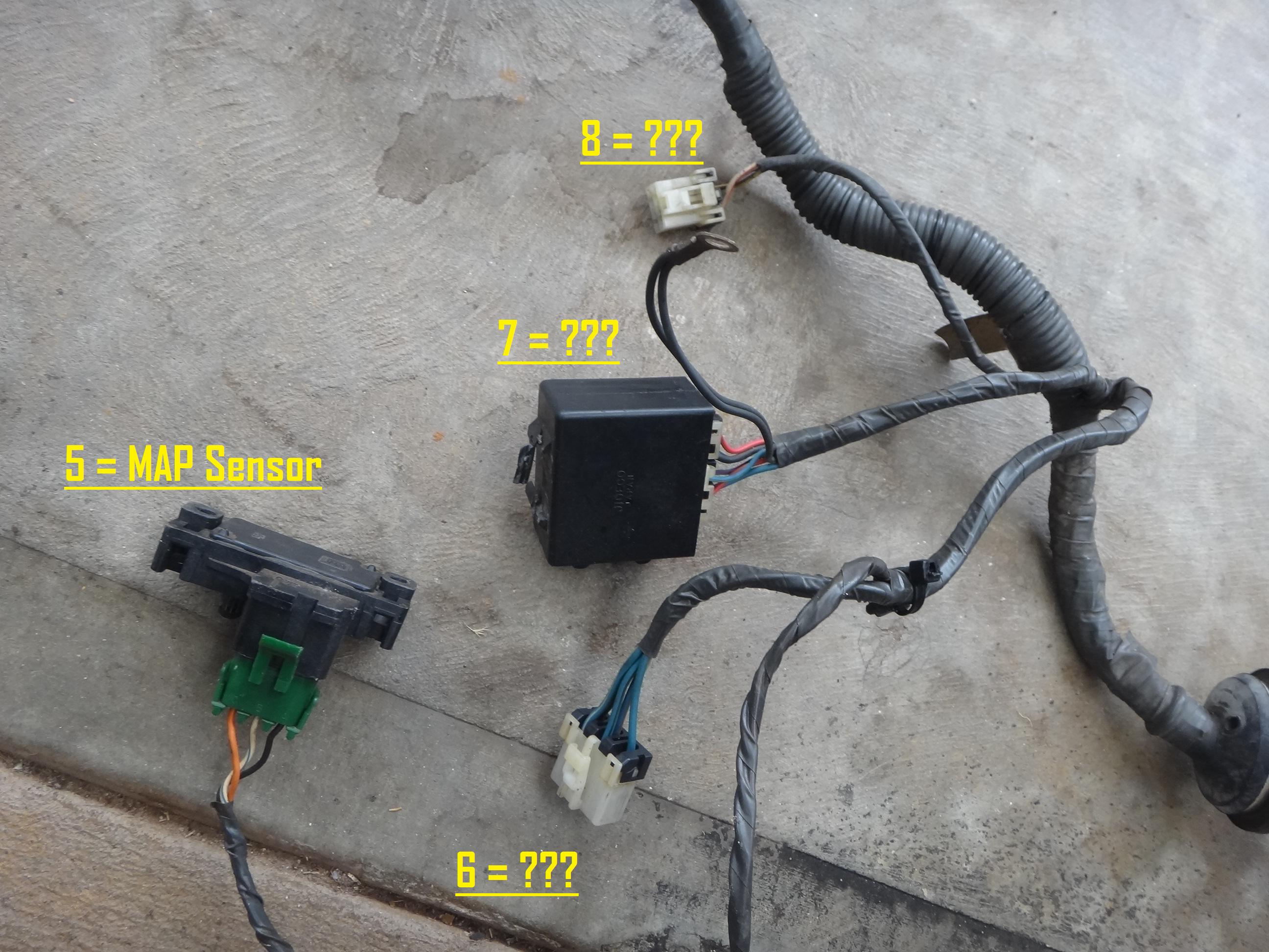

5. MAP sensor
6. DONT USE
7. EFI Relays
8. DONT USE

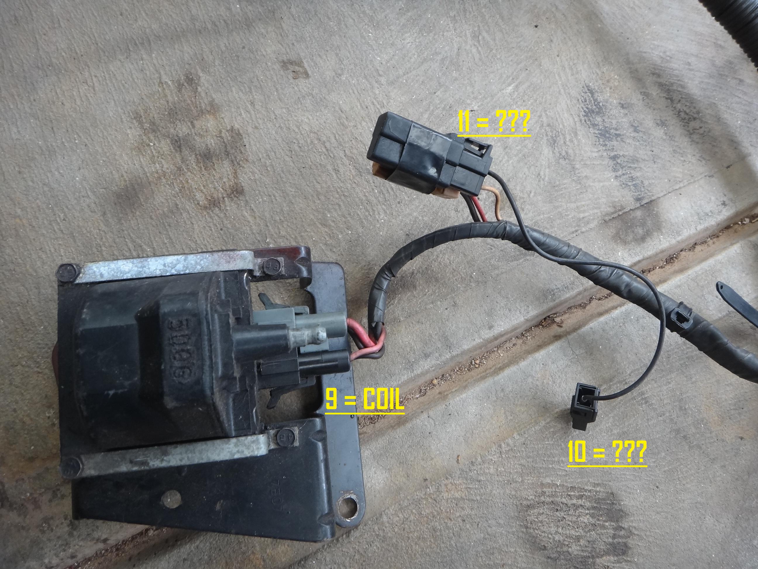

9. Coli
10. Coil power ground /earth
11. Coil power filtering capacitor
12. Ignition module
13. Ignition module
14. Manifold Air Temperature

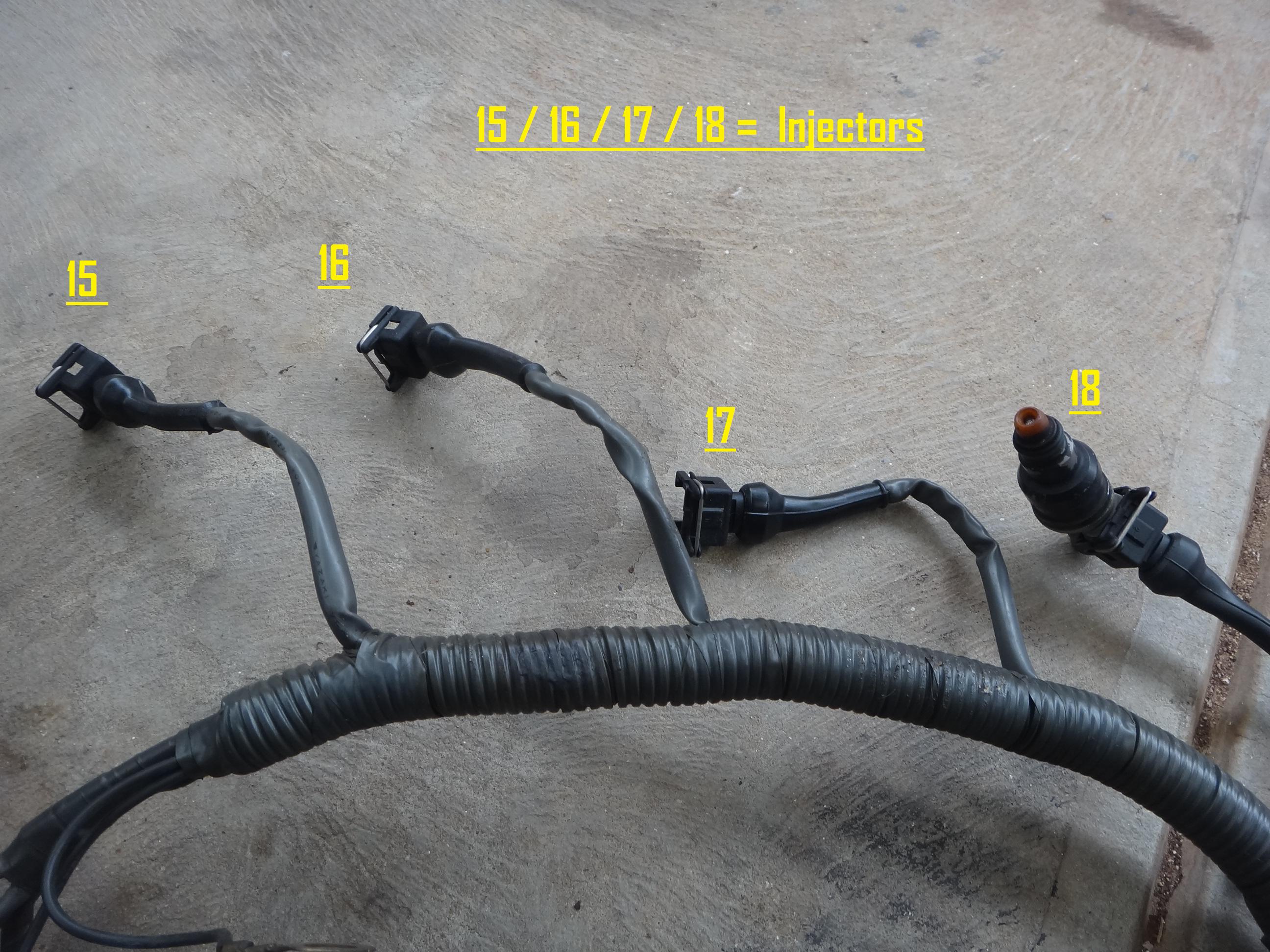

15. Injector
16. Injector
17. Injector
18. Injector
19. IDLE Control
20. Throttle Position Sensor
21. Coolant temperature sensor
22. Narrowband o2
2. ALDL
3. DONT USE
4. DONT USE
5. MAP sensor
6. DONT USE
7. EFI Relays
8. DONT USE
9. Coli
12. Ignition module
13. Ignition module
15. Injector
16. Injector
17. Injector
18. Injector
19. IDLE Control
22. Narrowband o2

- Posts: 10015
2=160 baud aldl, diag mode switch
3,4 =body/ac switches (dont use)
On my phone and have to go but thats a start
- Posts: 10015
6,8 dont use
7 efi relays
10 coil power ground
11 coil power filtering capacitor
12, 13 ignition module
21 coolant temp
22 narrowband o2
14 MAT
15 to 18: any, mpi all fire at once
7 efi relays
21 coolant temp
22 narrowband o2
14 MAT
Thanks , a few i kind of knew what they where for but wasn't to sure.With the ignition Module i do have but couldn't find it for the photo. will update photos as i go along so others can learn off.
I amuse the narrow band 02 sensor connects to the exhaust manifold ?
Am i missing a oil pressure switch ? or is that for a comira only ?
And am i correct that you power the ECU and LOOM via the ALDL ?

I thought the injectors have a certain firing order ? I've never heard of them firing at once.

yes they all fire at once not sequentually
- Posts: 10015
Install a bung in to the exhaust and screw a single narrowband sensor in there.storm_x wrote: I amuse the narrow band 02 sensor connects to the exhaust manifold ?
The oil pressure switch is hard wired to disable the fuel pump in the camira application, so its not wired to the delco.
Have a look at the power relays and you should be able to see fat power input and ground wires, that probably go back to one of the plugs I said dont use. Remove the plug and unneeded wires and hook the power there.
In a multiport injection the injectors fire at once, each cylinder sucks the fuel in when the intake valve opens and goes bang when the spark fires. In sequential injection they do fire one after each other, but the measurable gains are very little, other than a tiny bit of fuel sticking to the intake walls theres nowhere for it to go other than the cylinder it was intended.
