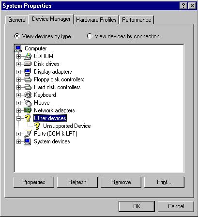

Posts: 10016
Re: Laptop Probs?
Click start -> right click computer -> click properties -> click device manager (on the left hand side).
In the device manager there shouldnt be anything with a yellow question mark or red cross, and none of the tree should be expanded. This screen shot is XP, but it looks about the same in win7. You want to make sure there isnt anything unsupported/disabled/question marks/red crosses etc.

Everything in device manager is Ok, that the 1st place I checked.
