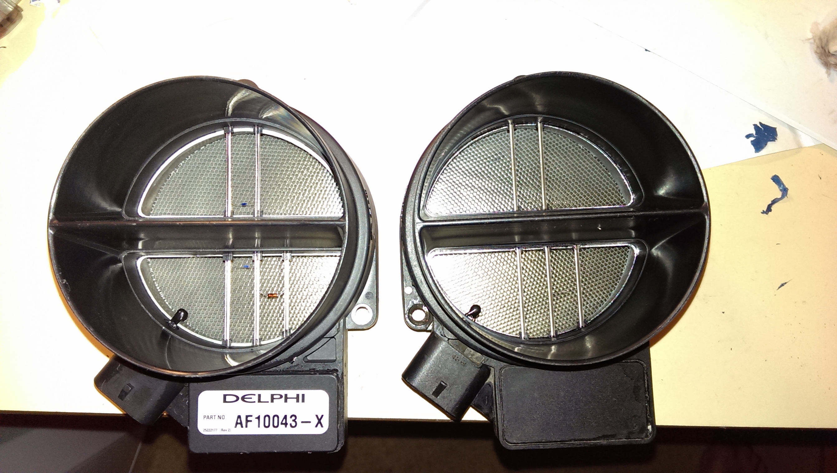

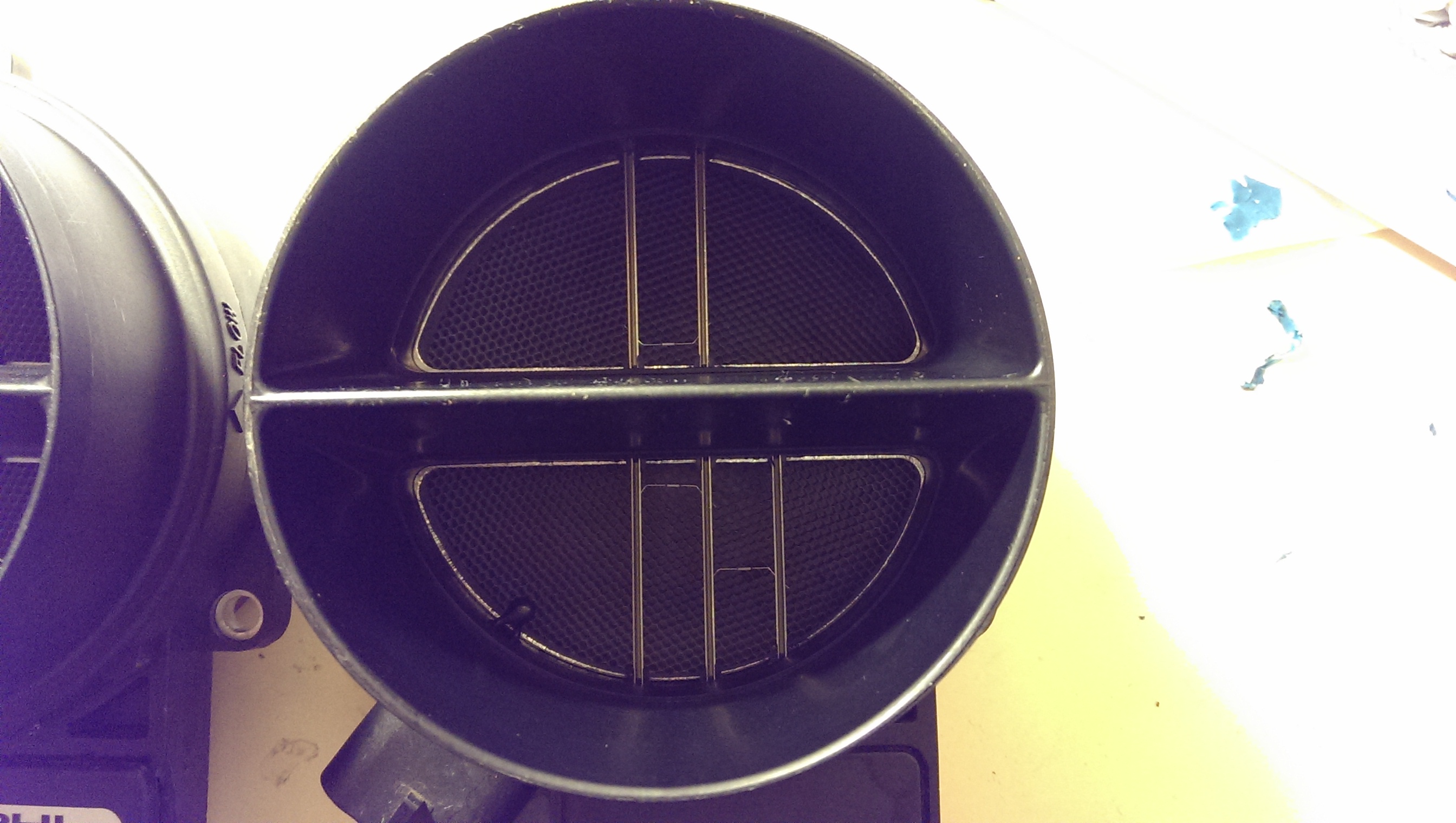

The Knock Off MAF's are surprisingly fairly hard to distinguish from the genuine part. There are however a few subtle differences which tell the two apart:
Knock OFF:

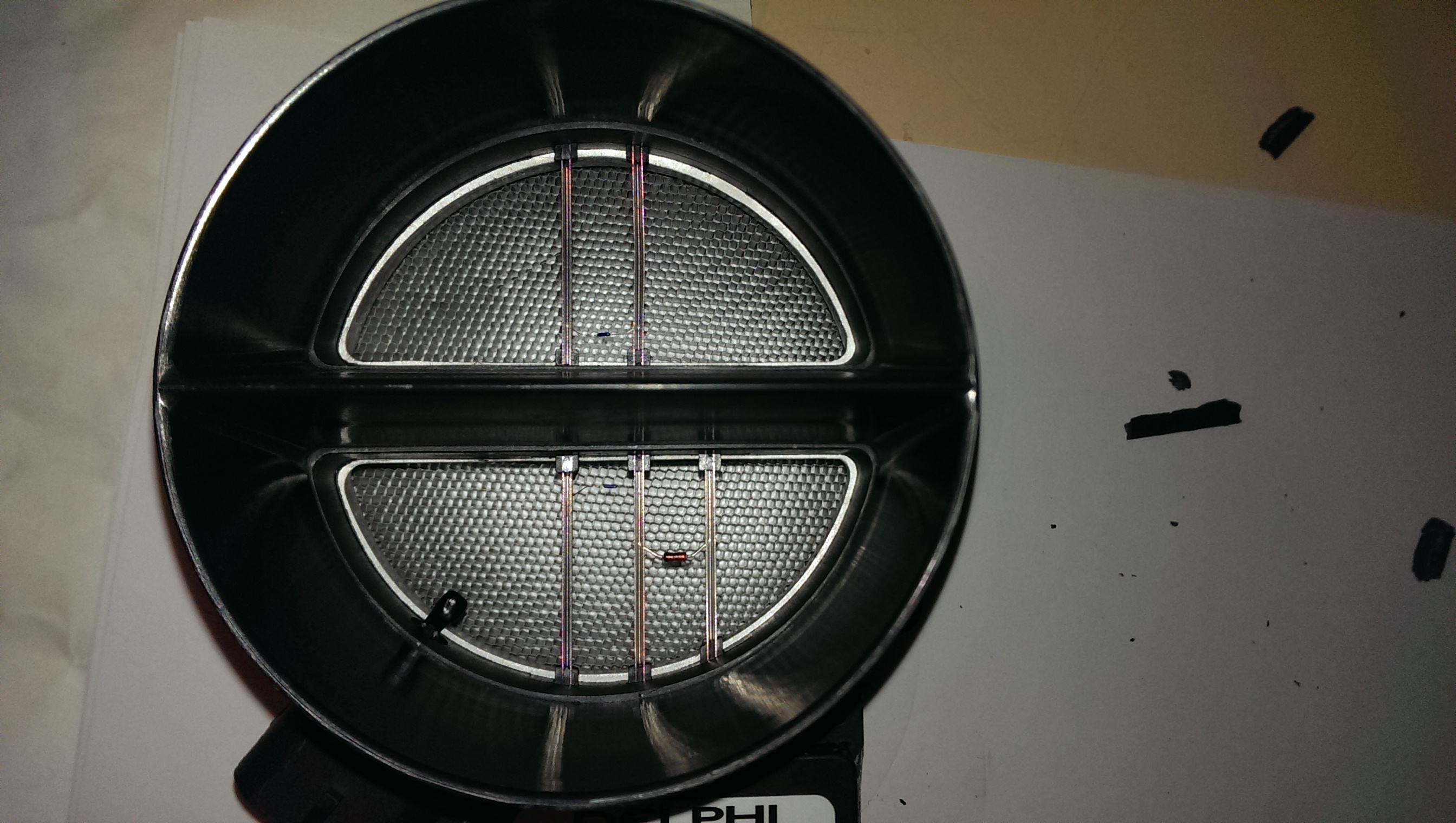

+ Only has 2 Hot Wires (Blue in color, and are smaller than the genuine ones)
+ A diode replaces the 3rd Hot Wire...

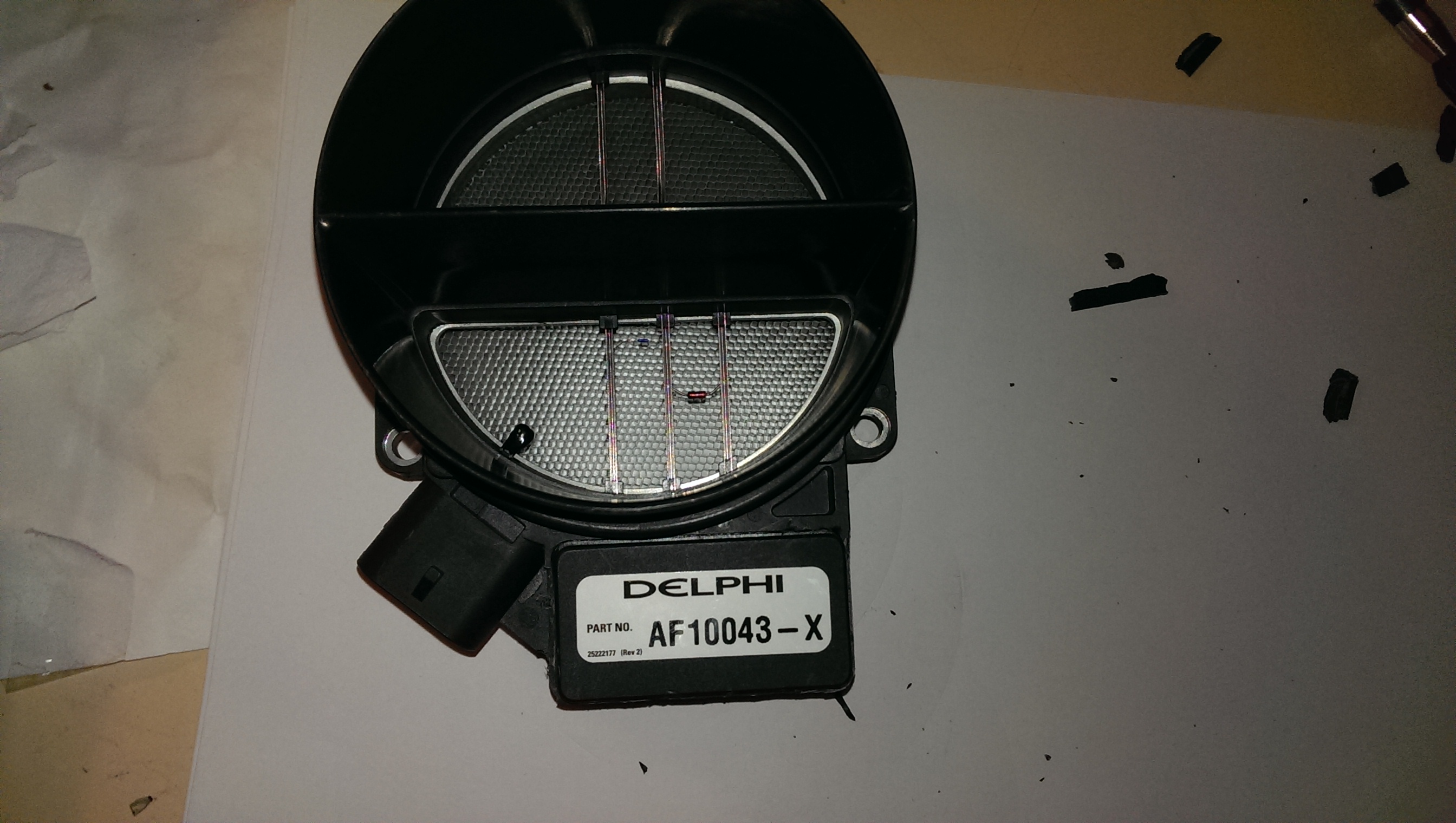

+ Has a white sticker on the flat side and no barcode at the bottom.
Genuine:
+ Has 3 Hot Wires (Grey in color, slightly fatter)
+ Has original Delphi part number markings engraved on the body of the unit
+ Has no white sticker on the flat side.

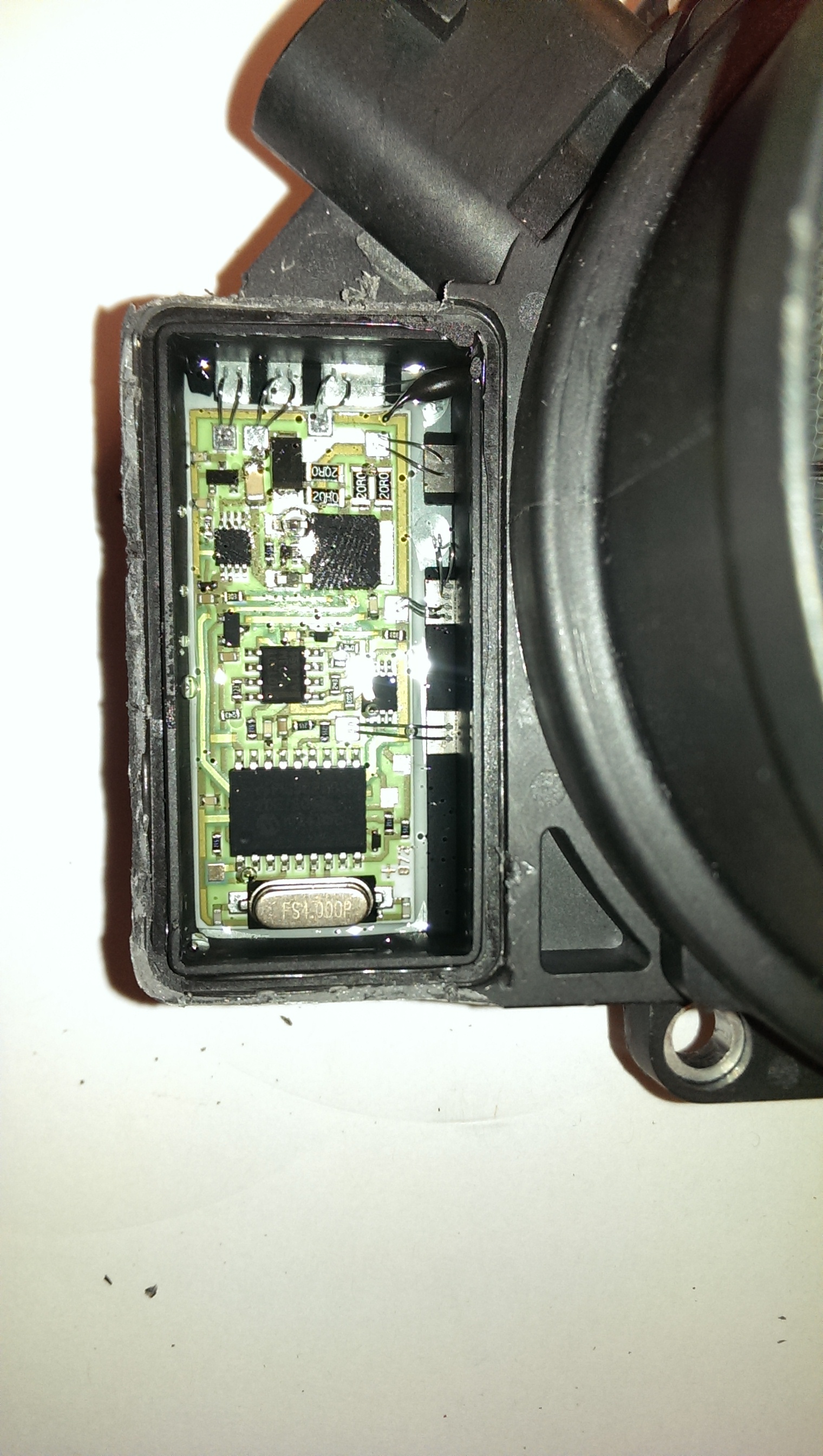

Now that I have no real use for this MAF; it was time to pull it apart and see why exactly was inside and why they decided to use a Diode instead of a Hot Wire.
Before I go any further; here is a picture of the blue Hot Wires / Diode I mentioned earlier:
Here's the picture of the white sticker too:
I pulled the cover to reveal the PCB... there is some form of non-conductive gel which covers the PCB:
This gel stuff comes off fairly easily with a little cotton bud and some light rubbing.
Once you get most of the gel off; soak the PCB with some Acetone. After a minute or two, take another cotton bud and rub the PCB down lightly. The gel should now 'peel' off the board exposing the raw board.
Once you have cleaned up the PCB you can dry off the remaining Acetone.
Under closer inspection, the Knock off MAF uses a 16 bit Digital Signal MicroController manufactured by MicroChip. It's a fairly decent chip. Part Number: dsPIC30F2011

This looks interesting. Reflash the pic and make an open source MAF...

interesting, if it's software limited and we can mod the code and ramp it up to handle upto 16226hz then we got a match lol also the factory item has silver delphi badge.

That looks surprisingly well made for a cheap knock off :wtf:

Would be interesting to see what is in a genuine MAF. :?:

I was thinking the same too... dump the code from the pic via ICSP and see how it works and re-assemble it with custom features :P

I got my genuine LS6 MAF in the post today. Here's some pics of the genuine vs the knock off:

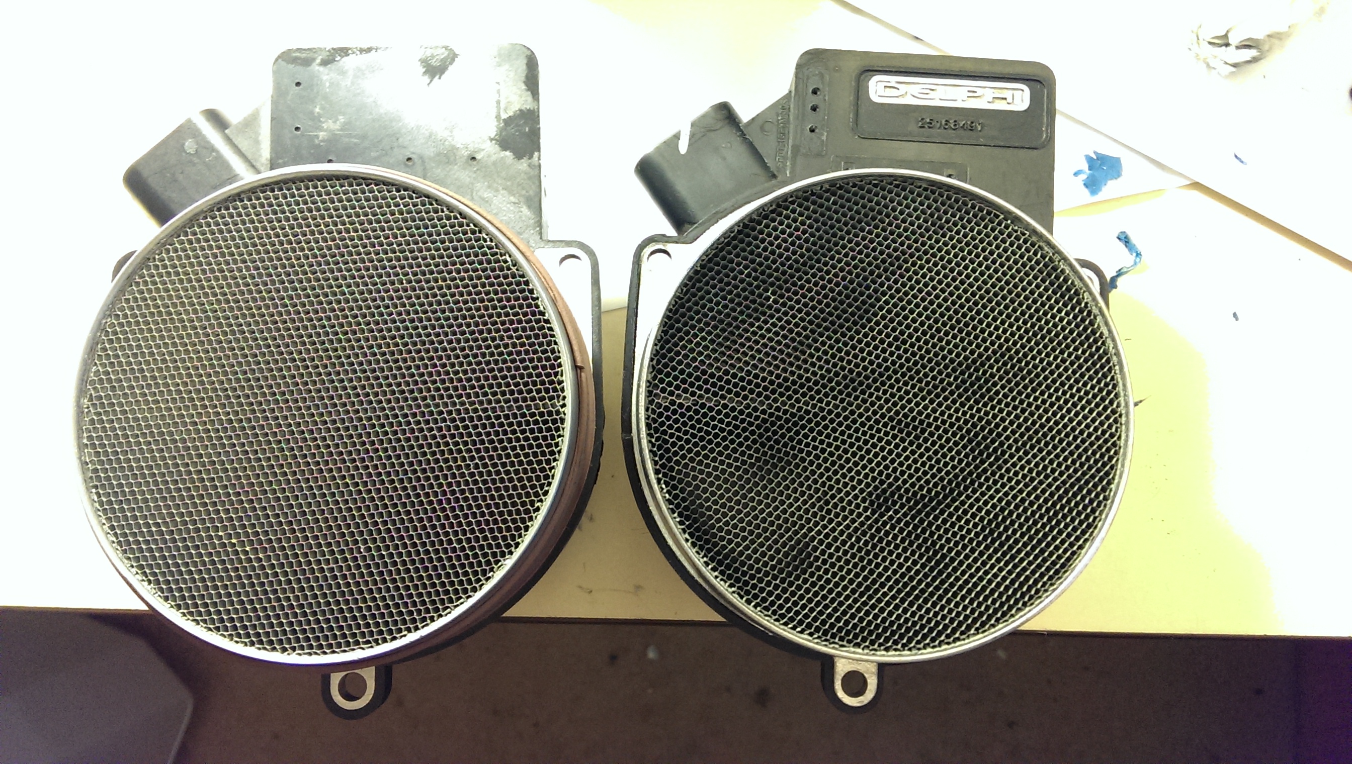

Back View (Notice how the genuine has a silver "Delphi" engraving which the knock off doesn't have. Also take a look at the Delphi part number engraved in the plastic right under the DELPHI logo. Btw the knock off doesn't have that brown rubber thing, that's something I added to convert the 3.75" to 4" OD to use with a 4" straight)
Front View (Notice how the Knock off has a white sticker here and the genuine one doesn't)

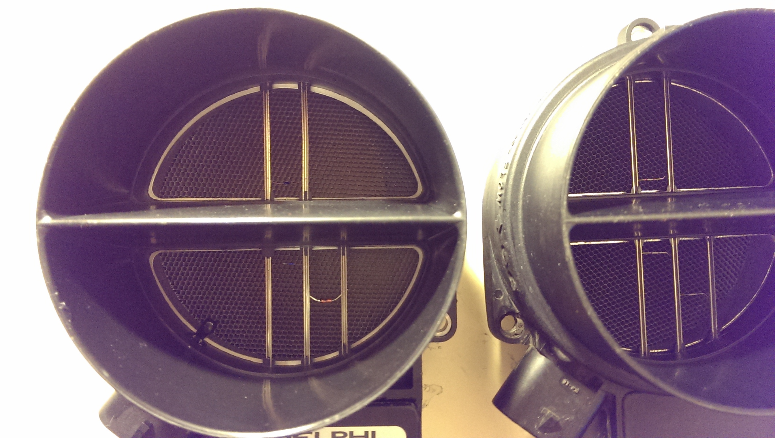

Knock Off Hot Wires:
Knock Off Hot Wires.jpg (1002.64 KiB) Viewed 8038 times
Genuine Hot Wires:
Genuine Hot Wires.jpg (760.38 KiB) Viewed 8038 times

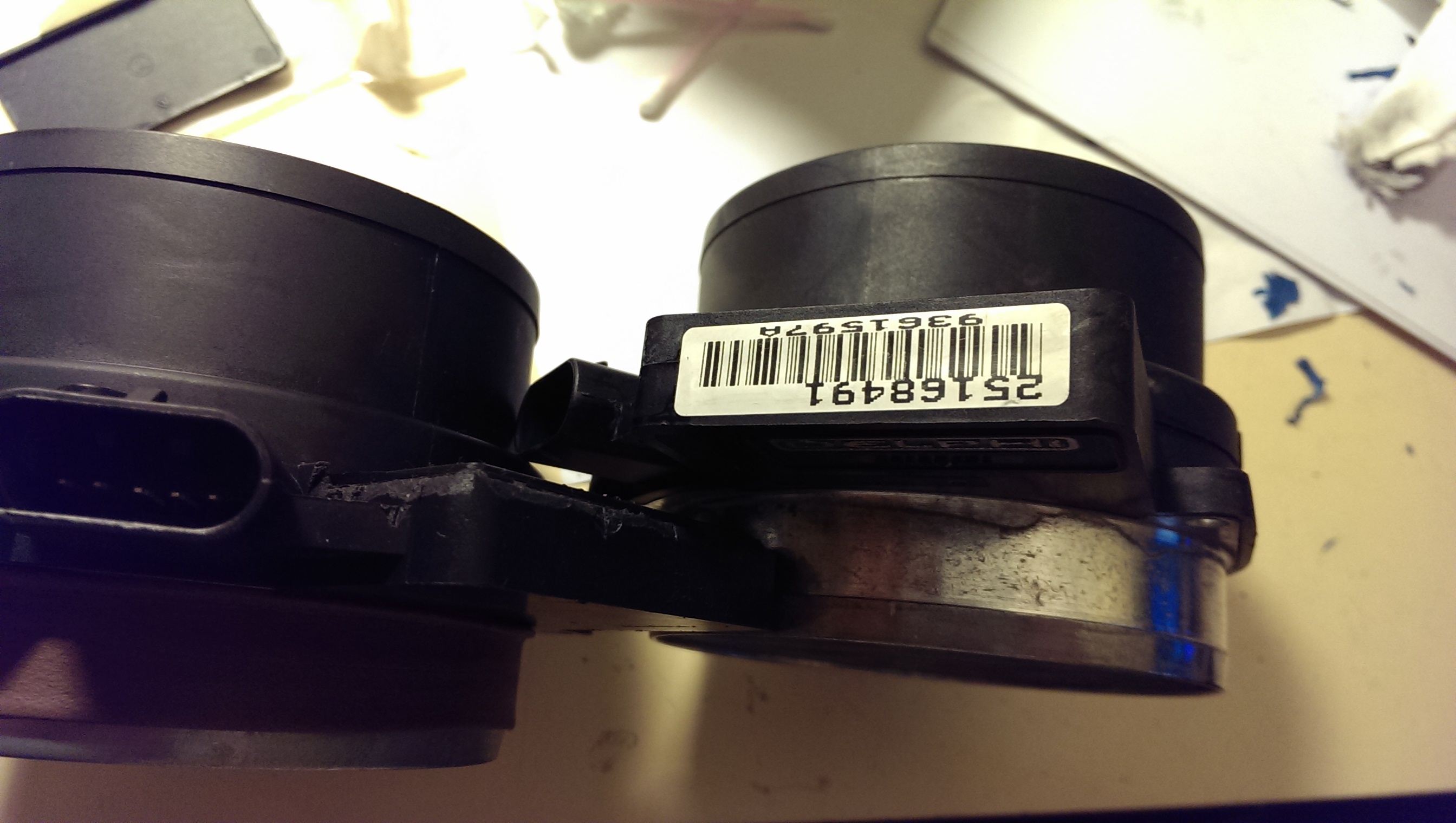

Edge of both MAF's: (Notice how the genuine one has a Bar Code and the Knock off doesn't)
Barcode Missing on Knock Off.jpg (790.25 KiB) Viewed 8038 times
