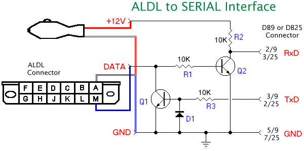

tried turn off echo and still no connect. Am I missing a step? Maybe the cable is wrong since I made it myself? I put the layout I used. I had an electric engineer look before I warped it up.
Thanks guys for any help

Re: Where to start on aldl recording
Can you post the ADX your trying to use, an ADS normally does not convert over to a working ADX without some command changes.

The send command looks odd, its F0 95 01 7A. I dont know the US ECUs well but that is not a valid ALDL frame on our aussie ECUs. Can try F0 56 01 B9 which is valid on our ECUs.
You may need a 10k resistor on the ALDL port too, pin A (gnd) to pin B (diag request). On some early cars its not bi-directional data, so the send command is not even required.

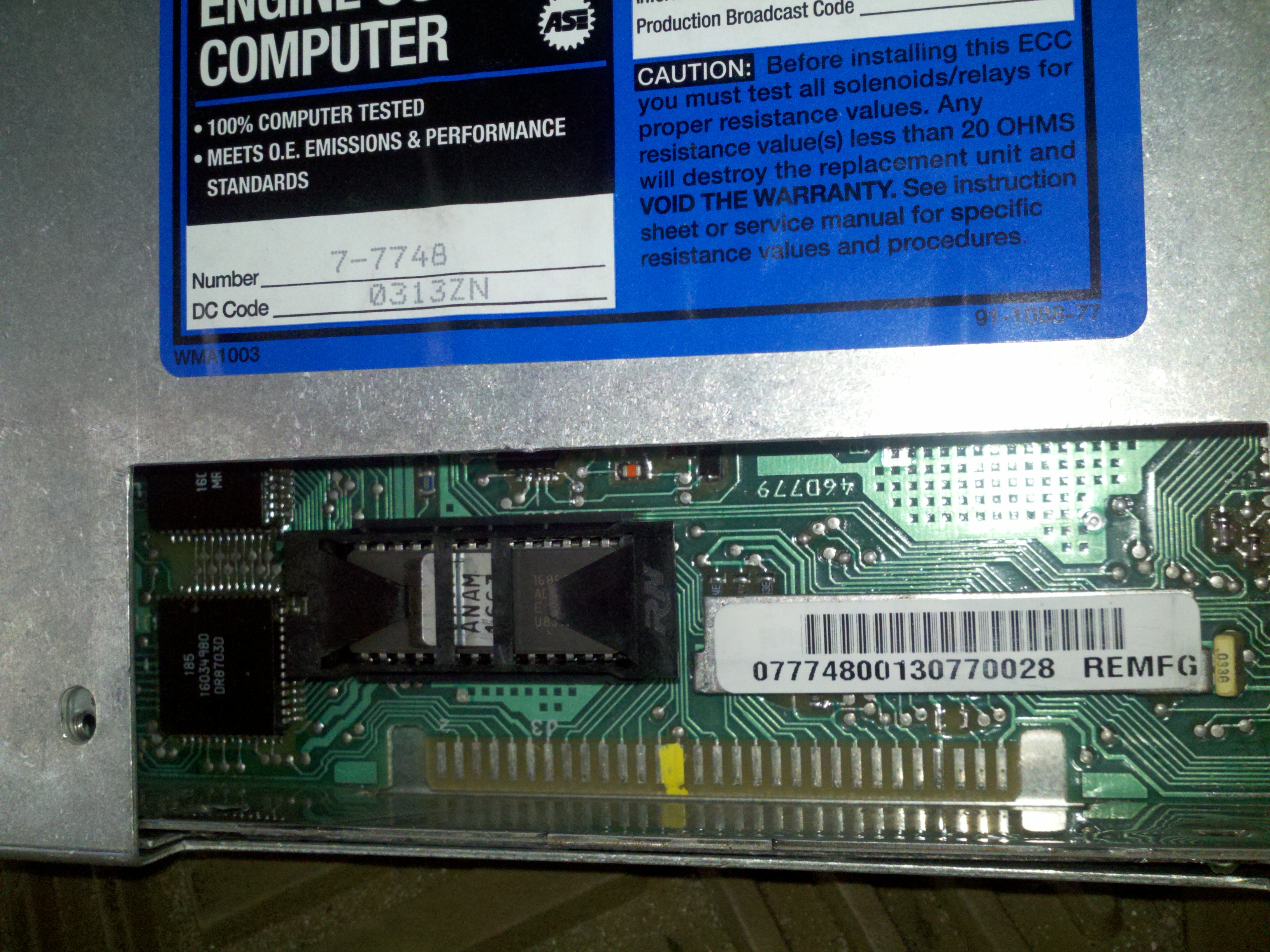

Tried to run newer computer but my trendnet s9 usb to db9 would not work. I thought maybe the ecu had changed. took a picture to be Shure.

Might need to ask on a US forum if anyone has a known to work definition. The guys over on http://www.gearhead-efi.com/ can probably help out there. I dont know the actual command your going to use, or if all it takes is a 10k resistor for data to flow like most US vehicles of similar age.
