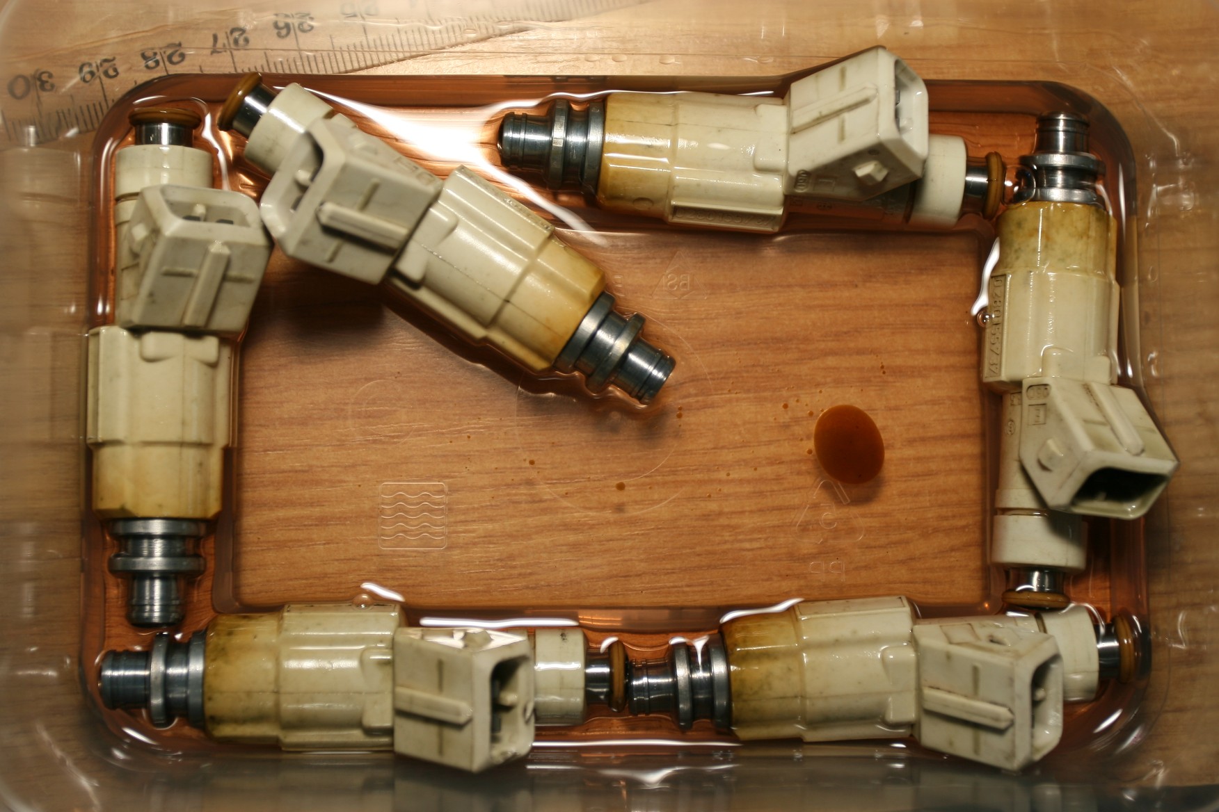

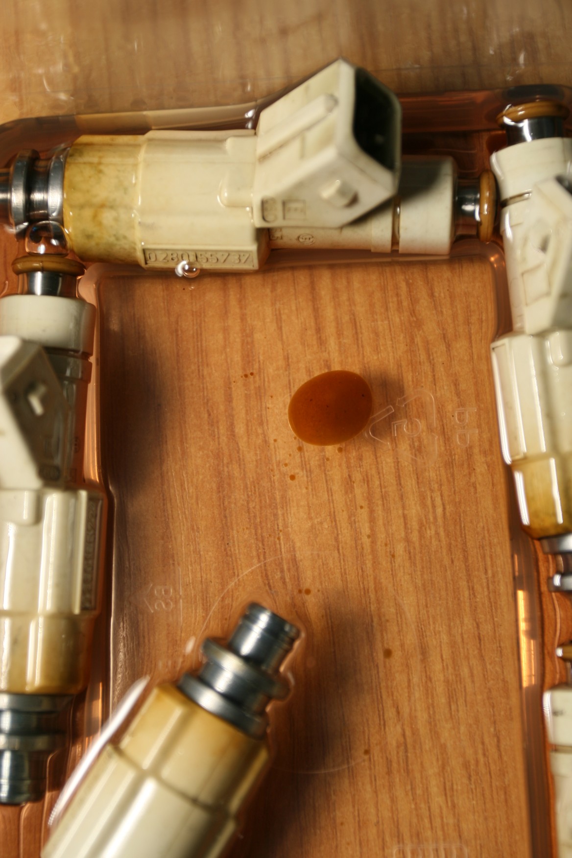

So far ive pulled the fuel rails off, injectors, rocker covers, TB and elbow and headers, getting way to hot in my garage, 38c at 10.30am, predicted 44c here today :/
Cleaned the injectors, came up fine, then i pulled the baskets out and resat them in fresh clean petrol and looks like oil? coming out of a couple its attracted together in the fuel.
