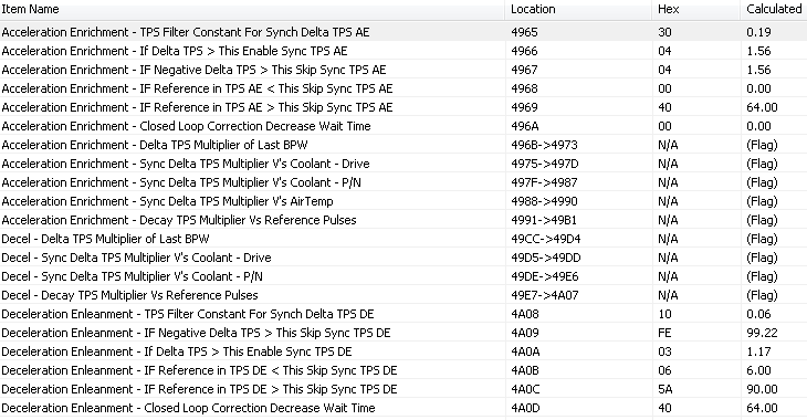

These are the scalars I have to work with to try & disable...
AE & DE Scalars to disable.png (26.01 KiB) Viewed 3000 times
I have set most of the tables to nullify, but would just prefer to do a global disable to test but again I'm not to sure on the wording I'm thinking if I put a hi TPS value on the 1 that's now low & a low TPS value in the 1 that's already high it should possibly disable but not 100%?

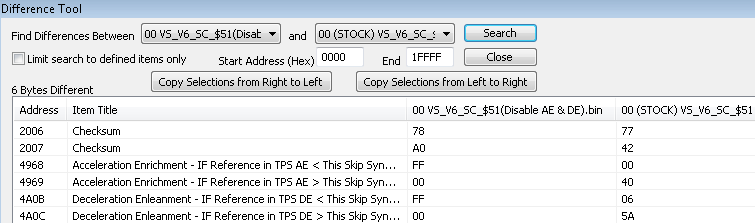

So Just to explain what I'm thinking but not sure because of the wording will this disable AE & DE...
AE & DE Scalars disabled test.png (13.85 KiB) Viewed 2978 times
TIA VX L67 Getrag
