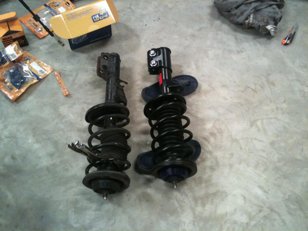

old vs new. Boge with superpro strut top and bearings.
I reused the spring and dust boot as they were fine. I sikaflexed the bottom of the spring to the strut as they have no insulators.
That should stop the spring "boinging" under hard travel. :thumbup:

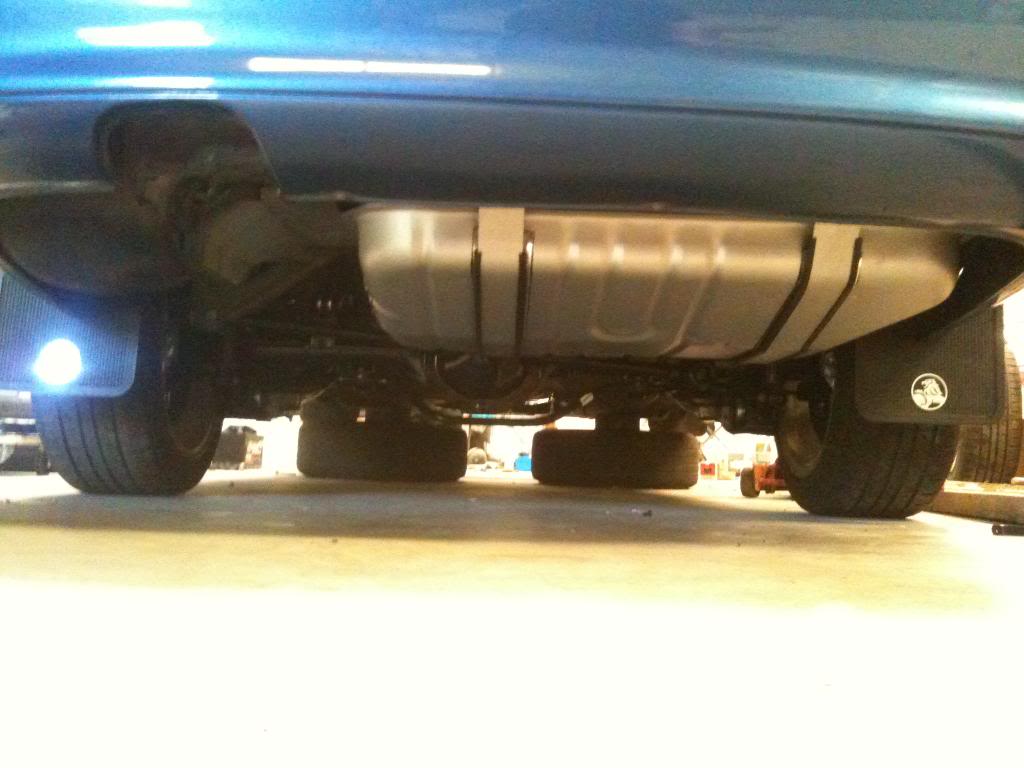

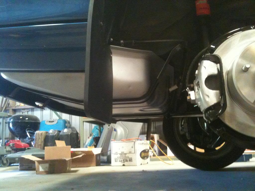

btw, if you are wondering what paint I used. I used Rust bullet.
toughest and stickiest paint I have ever used. Regarded as one of the best anti corrosion paints out there and i have no doubt at all after using it.
Looking better than new! Wont want to drive that when its all done :lol:

yes this paint it tougher than powder coat, I recall it saying it was mostly aluminium solids by weight.
Its a moisture curing urethane paint. It really really aggressively adheres to just about everything with minimal prep. Since the tank is tin/lead coated I needed a paint that would stick. This did not disappoint.
http://www.rustbullet.com/uploads/RBAEngData0210.pdf
its not cheap though, but well worth it. $87 per quart (950~ ml)
I have used other top brand paints like por15 before but they don't compare to how well this works.
There is a topcoat for it as well, gloss black, white and clear.
I will be doing the sump, tailshaft and few other bits with the silver protective paint then the black gloss for final finish.
