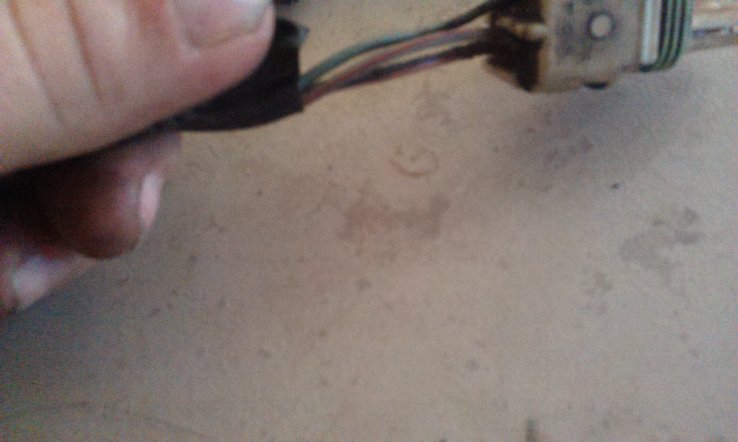

I now have found that the so called pink plug is actually the bigger of the 2 plugs near the ecu
I have also found that the 4 plug on the box usues only 3 pins and the pink with blue trace wire is spliced(looped) with the pink with blue trace on the speedo sensor. I need to know where that goes and what it does
the wire that does match back directly to that plug is the grey with red trace and the light blue wire(in the pic I will supply it looks green but it is faded or what ever)
I need to know the pins and wiring for the remaining wires

Re: vn 5l th 700 conversion
Not that anyone cares
But I pretty sure I have worked it out
pink with blue trace is positive for both 4th gear solenoid and speed sensor
violet with white trace is the signal wire from the speed sensor and becomes brown with yellow trace at the plug next to the ecu
black/white is earth
light blue from the 4th gear switch stay light blue at the same plug
the same plug grey is neutral safety
and one of them on that plyug is theft shit or power to ecu
that's it should run all sweet
all my info is just scribbles on paper i worked out when i have put efi motors into various cars.
i do know for fact that speedo sensor pink/blue is +12v, purple is signal to ecm, and black/white is earth. from memory i believe the speedo signal is brown/yellow after coming out of the dash which then goes into ecm pin A10, if you are using the motor in a car without a commodore dash then you can wire the purple wire directly to here and you then just need to change the Pulse Per KM in the tune to match.
also on the under dash plug normally to power a loom on my test stand i put ignition into the pink wire, which can be traced back to ecm pin A6, auto/manual switch is also on the same plug grey wire and goes to B10, and then there is the TCC lockup solenoid, which is the light blue on that plug it goes to pin C7.
all this is from this diagram http://www.oldholdens.com/temp/carstuff ... gram_b.pdf
also i use some of the wires from the grey engine bay plug, like the one for the fuel pump, A1 ecm pin, this is the +12v to the fuel pump relay on the 86 pin, then there is the check engine light, this is in the aldl plug and also comes out on the under dash plug as brown/white i believe and goes to ecm pin A5.
i use the engine coolant wire too, the one that normally feeds the dash sender, i change it out for my own sender and run it to my in car gauges just keeps everything in the loom nice and neat, and you can also use the blue wire from the oil pressure switch to feed into a dash oil pressure light if you have one or want one.
not that hard to work it all out with the diagram infront of you....
