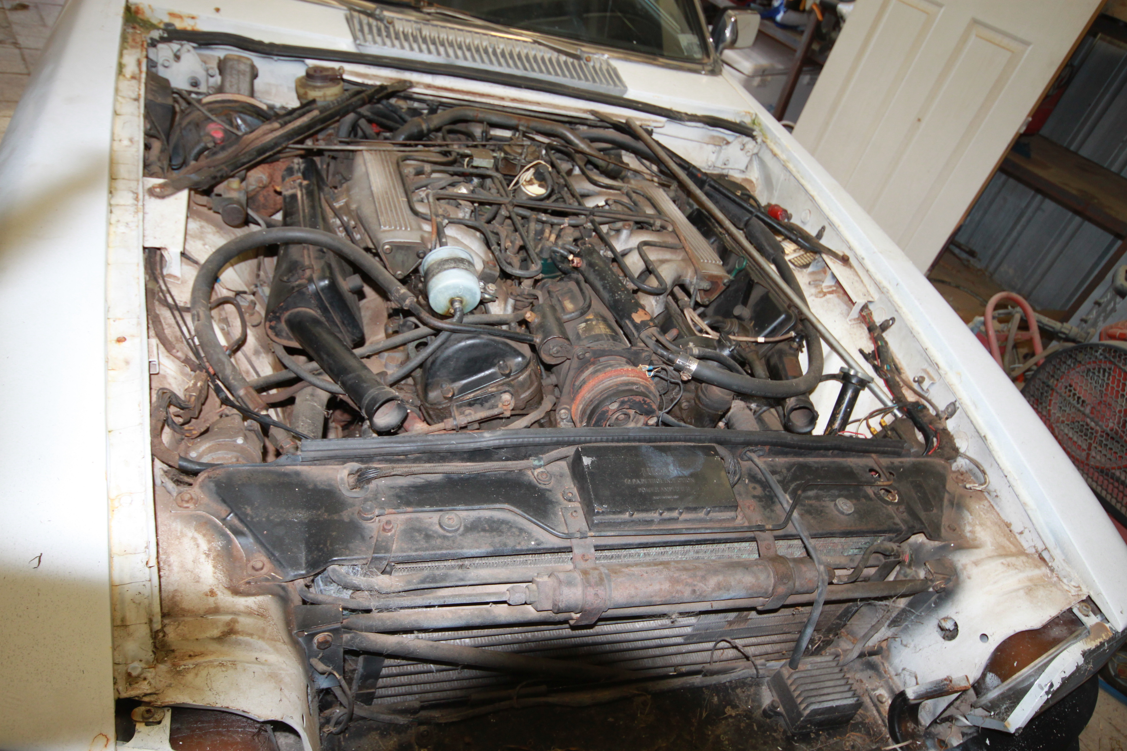

Pulled harmonic ect of the front of the Jag today and was wondering if i can grind slots in the first v belt 18 in the inner and 3 in the outer and use ABS sensors for pickup.
there is no room behind the first v belt slot. and i am planning on making a serpentine belt sys to run the other items.

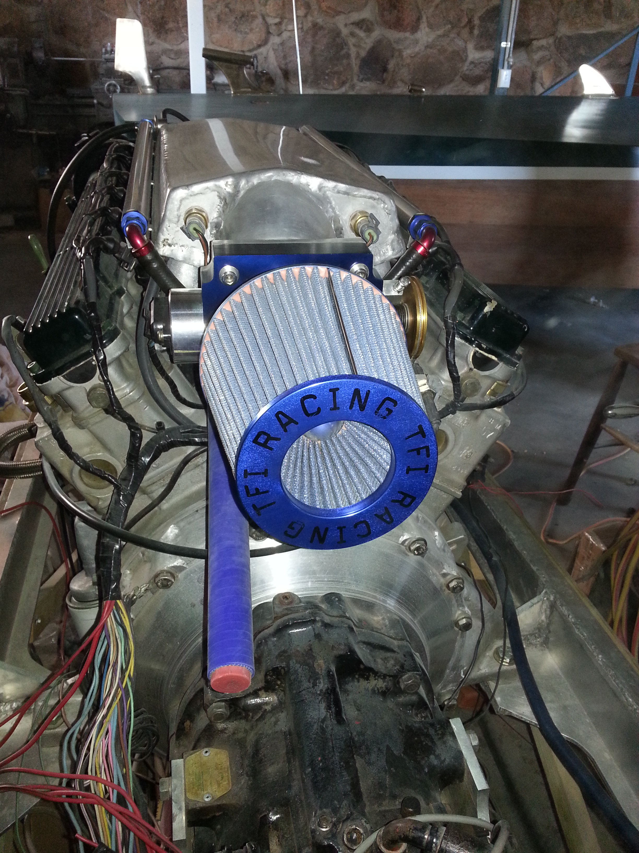

have done it using two coil packs and two 808s on xj 12 can see picks on kalmaker websitehttp://www.kalmaker.com.au/img5.jpg for xj 12 .and am doing it again for a boat engine with modified manifold
there is plenty of room to run the 18x and 3x from a vn remove the harmonic balancer off the jag and machine to fit reluctor rings and sandwich it between the belt pulley. fit two standard pickups ( use the standard vn mounting bracket) under the water pump on the inlet side at 60deg apart.I have run my v12 for over 250,000kms without harmonic balancer ,engineis now putting out 360 kw .
Boat engine should be around the 400kw.
Note v12 delco test bench at the rear

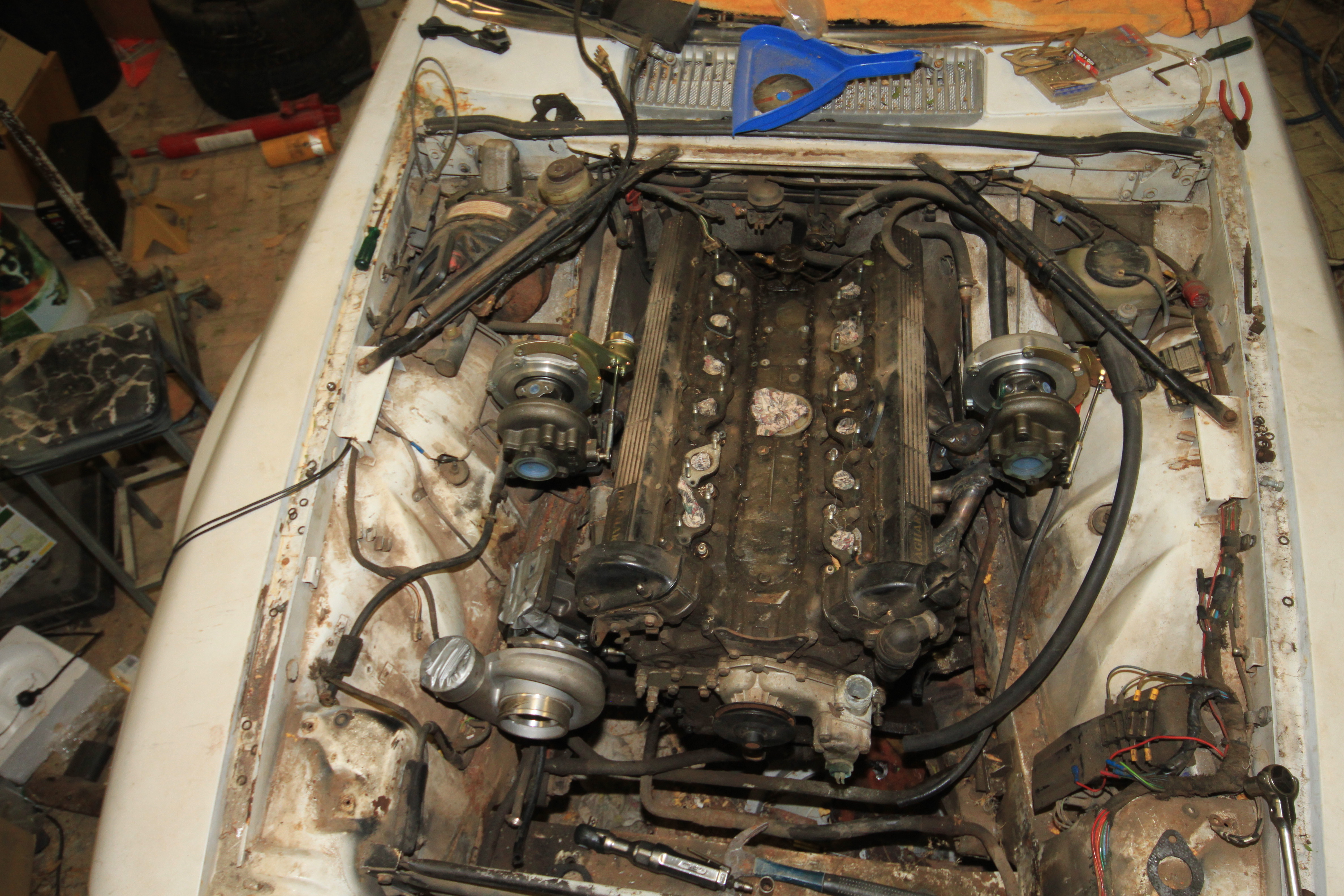

But will throw some pic's up
thats exactly what i need to know.
was to scared to chop up the jag harmonic to suck and see.
the lathe is on hold at the moment due to having to fly out to a wedding in thailand next month.
No not me ..,, I am best man tho ... that and xmass have hurt the bank balance.
so i am moving onto jobs that I can do with out machining.
Jag at this stage is not pretty as its all fabrication work and twiddle thumbs while thinking.

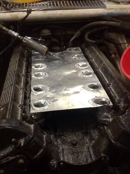

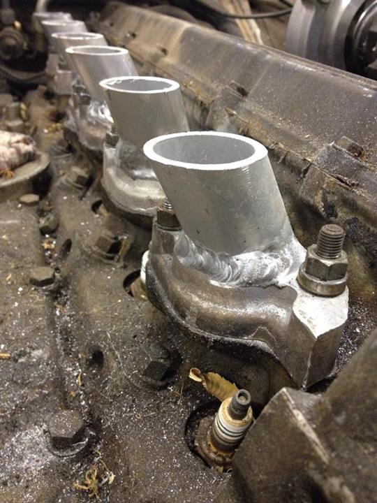

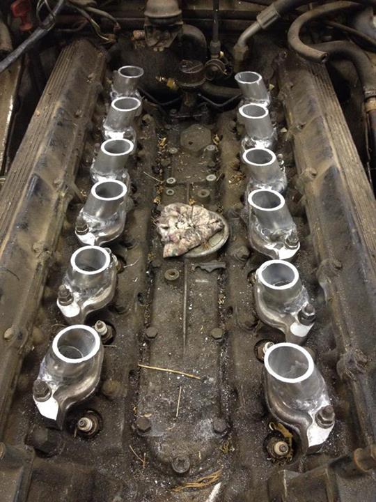

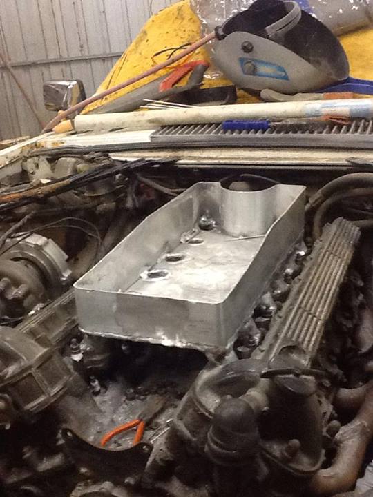

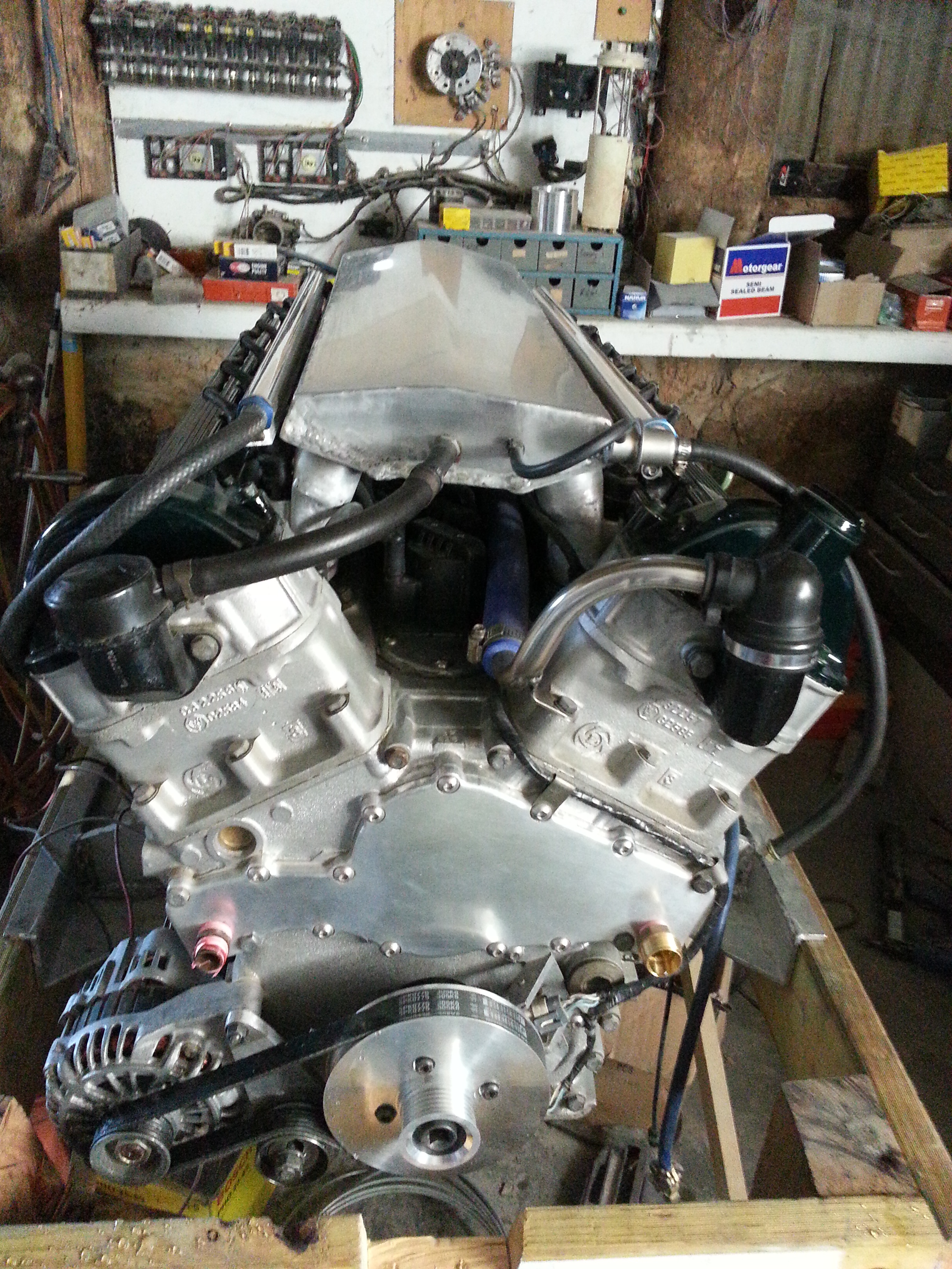

hi ya been sort of busy.. got som upadates.
brought a tig learnt to tig weld alloy and been getting stuck into manifold.
- 10489957_10152161020106805_5277691322040976342_n.jpg (59.79 KiB) Viewed 4192 times
- 10527614_10152134225021805_1277780045710429048_n.jpg (52.14 KiB) Viewed 4192 times
- 10471024_10152121660106805_4571564623750785937_n.jpg (69.32 KiB) Viewed 4192 times
Re: XJS V12 twin turbo
Looks good, looks like there's a bit of work in that manifold already, keep up the good work

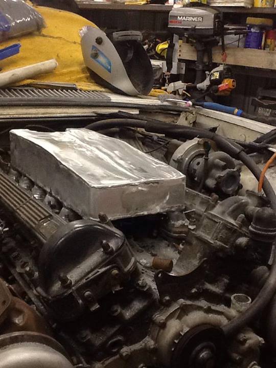

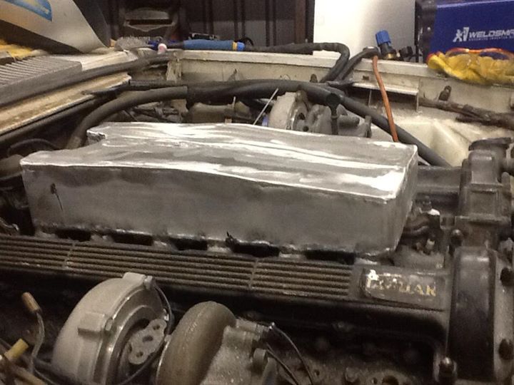

manifold boxed in..there is a divider inside thats why the weld down the center
