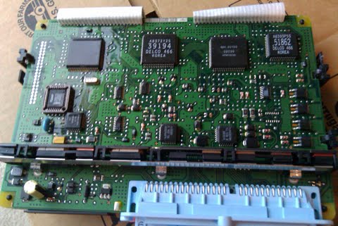

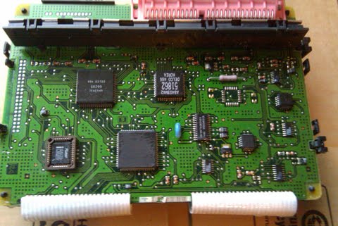

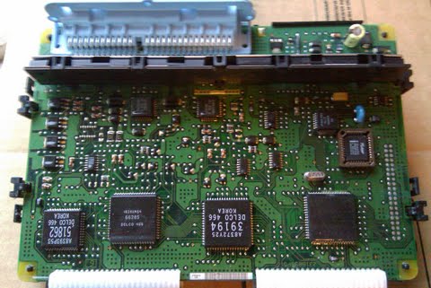

Here is what mine looks like
Tranny Side
Tranny Side
Engine side pic 2
Engine side pic 2
Engine Side pic 1
Engine Side pic 1
Posts: 9032
Re: '99 Saturn Dissassembly
Is that socketed chip the flash? Nice of them to do that if it is! Looks like its got the space to add an nvram if you wanted to start thinking about realtime tuning.
