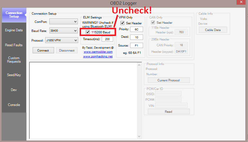

Hi guys - I have ELM327 interface (Ebay Special) ....It is showing it as Firmware Ver 1.4 and Baud Rate 38400 ...However
When I plug it into the logger it displays as a Version 1 ....
It seems to findthe unit but when the logger requests the high baud rate ...nil response and the ELm times out
[16:24:50:595] Attempting to Connect to Comport...
[16:24:50:630] Searching for Device...
[16:24:50:714] Testing Comport: COM3 at Baudrate: 9600
[16:24:51:270] Testing Comport: COM3 at Baudrate: 38400
[16:24:51:489] ELM Device Successfully Found!
[16:24:51:496] Requesting Fast 115200 Baud..
[16:24:51:505] ELM Device Sent back '?'
[16:24:51:507] ELM Device Did Not Answer Baud Timeout Parameter!
Any way I can get this to work at lower baud rate? - or just buy another ELM?
Cheers
Kyle

retrotuner wrote:Hi guys - I have ELM327 interface (Ebay Special) ....It is showing it as Firmware Ver 1.4 and Baud Rate 38400 ...However
Cheers
Kyle
Gday mate,
In that connection screen, there is a check box setting that says "115200 baud" or something like that, Just untick that box and then try it out. :thumbup:
So your ELM should be on COM3, Baud 38400.
Taz.
