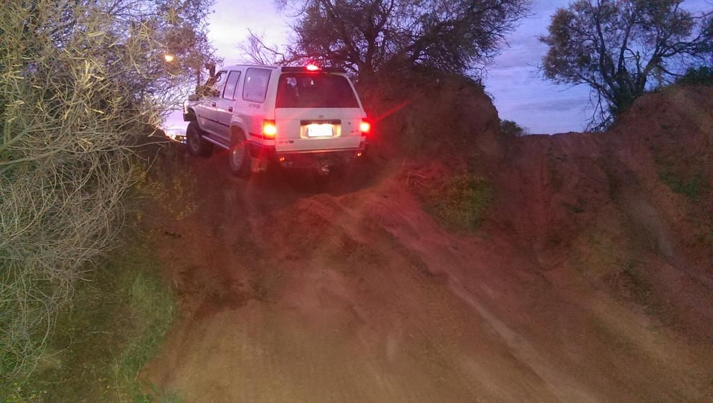

finally got this thing running good haha,
swapped the throttle body with a good one and then it ran ok but still not perfect but it still managed its maiden voyage of a 250km round trip haha
only casualties were 2 leads melted and a oil leak from the filter relocation kit and even running of 4 of the 6 cylinders on the way back we still got 22L/100km and managed 110 all the way haha
anyway we've put new leads, plugs, and swapped the coil packs because it still refused to idle and had a misfire under load and now it runs perfect or as perfect as an ecotech can run on a untuned 808 haha
just been showing a few newer more expensive fourbies up around here, funny when a old hilux on highway terrains can get more places than a near new turbo diesel on muddies haha

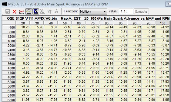

be careful its not pinging its dingaling off..... untuned 808 tune has about 12 degrees too much timing for an ecotec....

haven't heard it ping at all yet but i probably just couldn't hear it over the misfiring, but if its running 12 degrees too much it might pay to get or s#$t together and tune the thing haha

to give you an idea.... this is a VN based spark map against a VS ecotec spark map
