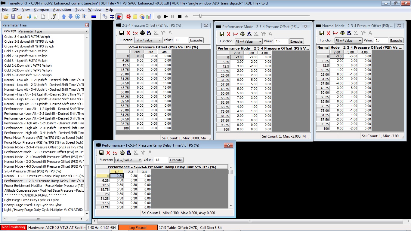

Couple tables regarding 2-3-4 pressure offset, There are two tables titled normal and performance which i understand but there is also one that is labeled 2-3-4 pressure offset vs TPS
1. Is the 2-3-4 pressure offset vs TPS table a Global PSI table? then the NORMAL or PERFORMANCE tables add or subtract off that table? Obviously they are all offsets of the main force motor table?
Also are they tables for just the pressure for the shift or the pressure added to what ever the force motor table says for that TPS and VSS?
2. The pressure ramp delay table? what is it? ive commanded a target shift time of 0.40 through 1-2 and 2-3 and 2.0s for 3-4 but i only really achieve a shift time of mid 0.60-0.70 for 1-2 and 2-3. Is this becasue the pressure ramp is delayed 0.30s for those shifts?

yes global modifier table per gear.
Pressure ramp delay tables i need to fix up, this is the switching delay time before pressure ramps for a shift, there is two pressure adder tables, i havn't added them yet, nothing to exciting, if you want to spice the shifts up a little mainly adjust the main pressure table and shift pressure adder scalars.
For tuning watch your force motor current and slip rpm, if your shifts are between 0.30 - 1.00 then it's normal, if sliprpm is over 1000rpm while not shifting then either you dont have enough pressure or something is worn or slipping.

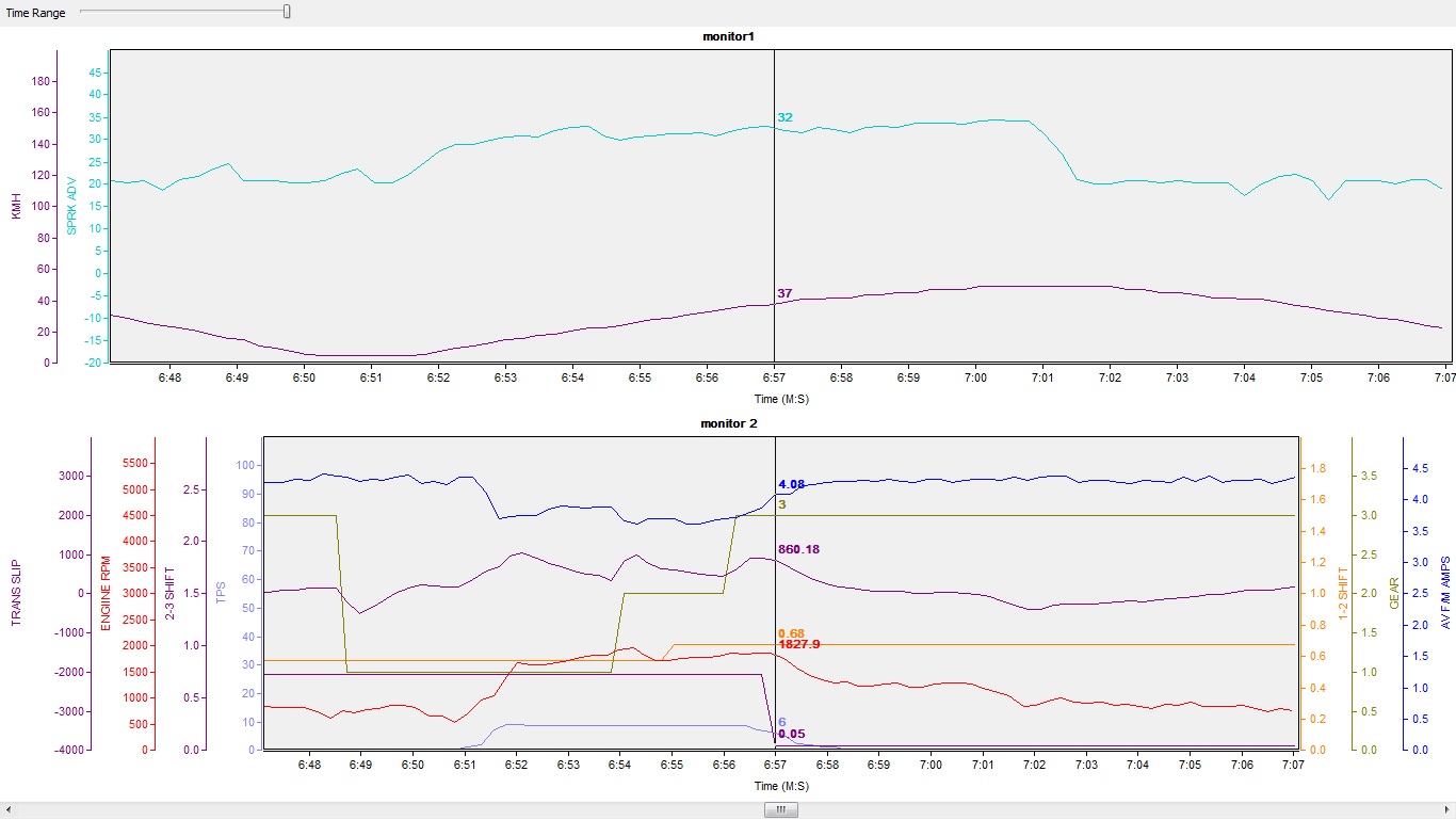

Ok i zeroed ramp rates and no change. This screen shot is what im worried about... PSI isnt that high but its changing into 3rd in 0.05 seconds occasionally. Other times its around 0.70 seconds except for these strange occasions..
Box isnt built just shift kitted
Any ideas?

can display gear ratio on that, will give a better indication of shift time.

The torque converter feedback flag seems to flick on and off in the logs aswell? If that may have something to do with it. I may pull some 2-3 gear change pressure out and see if that lengthens the time. Seems only to do it at low tps. Main line pressures down in that region are like 2psi but the 1-2 2-3 and 3-4 up shift pressures are at 7psi so will drop them.
