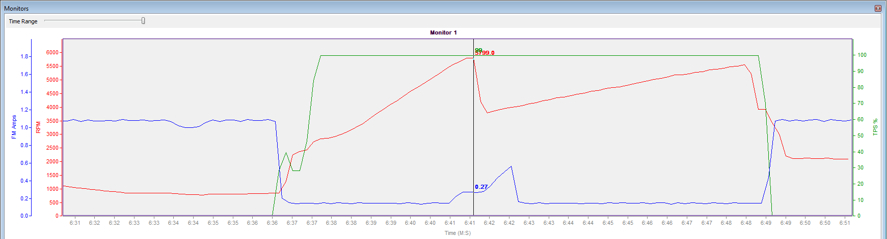

Get a data log of shifting in to and out of gear a few times. Have a look at the force motor current, if its max (lowest pressure) like Jayme mentioned there is no further tuning possible.
hoosedamoose wrote:also what is 1-2 upshift pressure mod time limit? what does it do? im just a little curious when it comes to the transmission stuff as there hasnt been much chat about it recently.
The PCM is controlling the force motor based on a a number of tables and modifiers. Once a shift has been commanded (look at the requested gear while logging) the PCM monitors the RPM and decides when it has started to drop that the shift begins and when it rises the shift has finished.
During a shift you can modify the pressure so the shift is softer as it engages, go to far and it will have too much slip. The tables are all labelled along the lines of pressure ramp 1 and pressure ramp 2. The ramp 1 tables operate first and then ramp 2, there are various time and ramp rate tables.
The pressure modifier time limit defines how long all this is allowed to happen for, if the shift is unusually slow or the PCM does not detect it properly then the time limit will put an end to the ramp rates and go back to normal.
You can log this and see what happens, at WOT the force motor current will be maximum. On a 1-2 shift you will likely see a dip during the shift as the ramp tables work.
Edit: Screen cap of a log showing the force motor current in blue at WOT...
