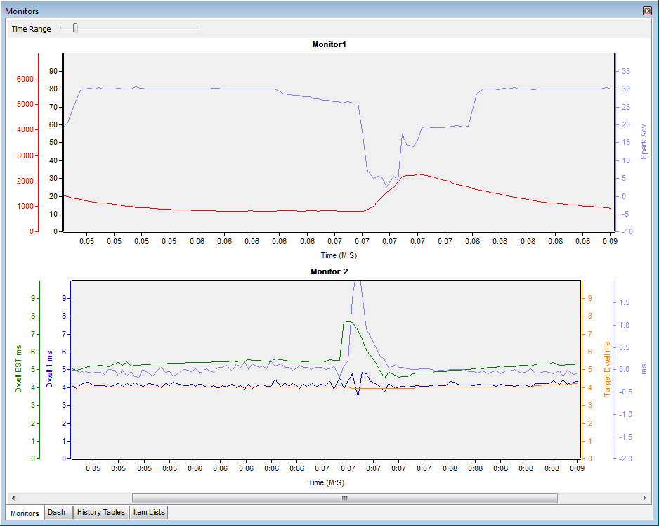

I think the dwell control is finally working how I like it. Have a predictive term to try and just track RPM and dynamic dwell term to add a little for fast engine changes to give some more energy. Both are configurable to suit the coil type, both are currently pretty low for testing.
Around a 50% throttle stab (zoomed in) while using a 1.5ms dwell that some COPs use. Surprisingly the LS1 coils have no problem WOT revving out to 6800RPM like this and noticed no difference in how the car drove... At idle an instant WOT with the LS1 dwell table results in this (zoomed in again).... Still get a small amount of initial dwell drop (not bad in this one) as I can only predict what the RPM is doing after the initial RPM changes and still dont know what the ECU spark advance will be. The ECU uses TPS AE to know that the RPM is going to rise and adds a large amount of dwell (the green bottom monitor). My dwell correction in ms is light blue, different scale so looks like heaps but is around 2ms (dynamic and predictive terms added).
Now this WOT is zoomed in so does not look like a fast change, but right at the initial rev it goes from 929RPM to 1179RPM in 32ms. This is 7812 RPM/sec!
And a bit higher revs to show how dwell smooths out as the accel rate and engine smooths out a bit....

Because the module does not have a TPS input its harder to predict, I can only predict after getting the change what will happen on the next trigger pulse whereas the ECU/PCM knows there will be an RPM change when the TPS shows a fast movement. In the first picture with the 1.5ms dwell it shows the green EST dwell leading my modules light blue correction, that is how long it takes for things to move from mashing the pedal to the engine RPM changing - its about 35ms or so. I had initially considered using EST dwell as another way to detect it but needs some more coding to make that happen, it would not help in your case with no EST though.
Yeah the LS1 coils certainly are good, not problem at low dwell times but I am not really pushing it that hard either (NA, 10.4 comp and standard plug gaps). A boosted setup would likely be different, but could upgrade to LS2 or later coils for more punch.
There is dwell overlap, any setup with more than one coil can use it so not limited to sequential spark. I run two LS1 coils (its a twin dizzy V8) with overlap, picture of that here with the bottom monitor showing light blue EST dropping to 1.6ms (max you could get with a single coil, or even a factory DIS like we have in the commodore) while the module maintains 3.67ms (orange target overlay with dark blue what was delivered) .. http://pcmhacking.net/forums/viewtopic. ... 120#p49028
