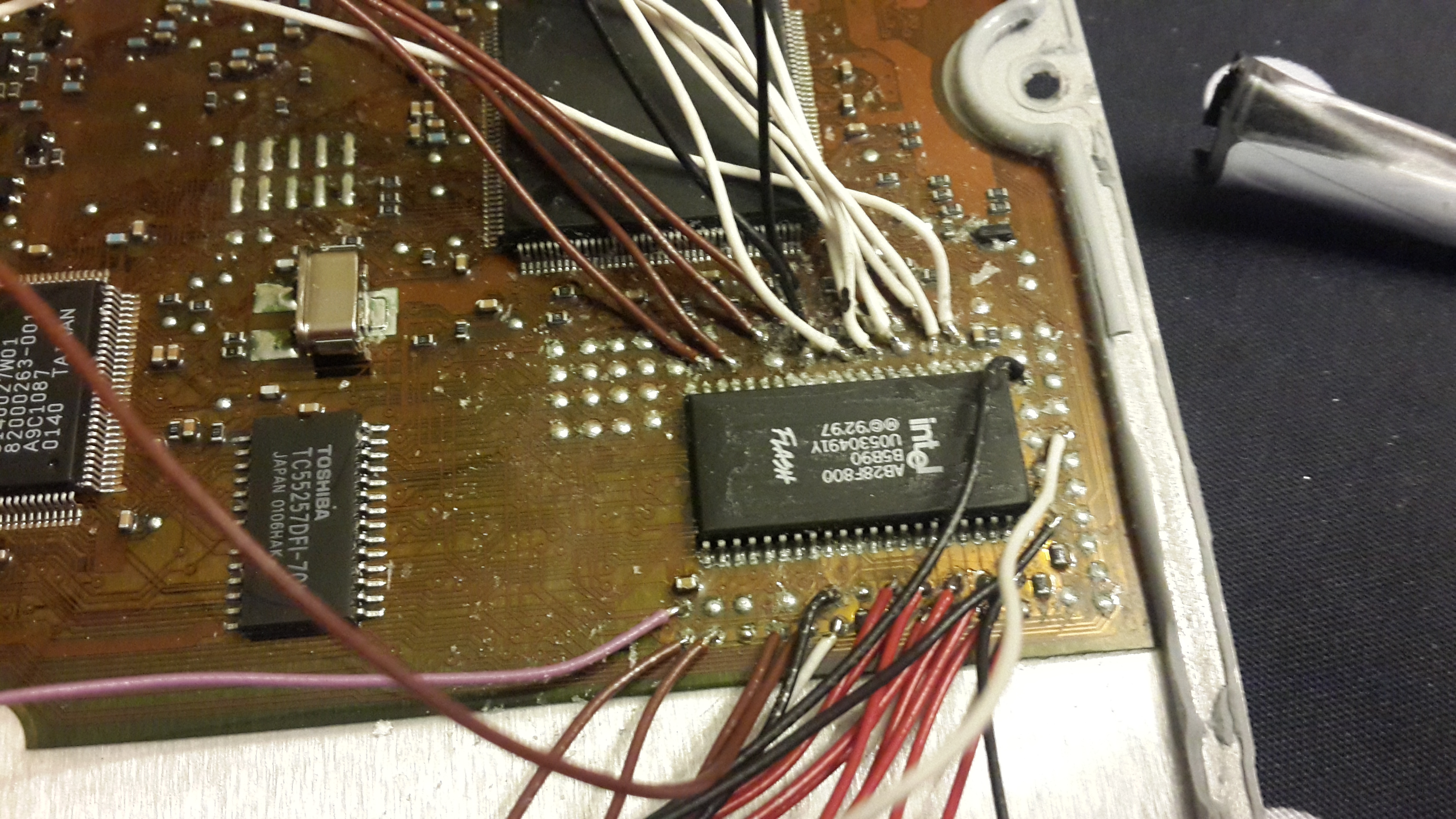

Wow, that looks quite a bit different than mine, has anyone seen something similar to mine?
Posts: 10111
Re: Reading eeprom from delco PCM, MC68336 based
Wow, that really is first gen. Delco had not even started manufacturing the chips yet. I wonder if that toshiba chip is the same as 16238528 or 16232947 on the '0411. Does it have the 90 pin header, or does it pre-date that and only have the array you've connected to around the flash?
Post by festy »
antus wrote: I wonder if that toshiba chip is the same as 16238528 or 16232947 on the '0411.
That Toshiba IC is a 256k 8 bit SRAM.
Post by iblackford »
I only have the pins around the flash, there are few more pads then needed for the flash, I just ohmed out and connected the ones that I needed.
The PCM actually wraps around the enclosure, one side is the CPU and supporting circuitry, and the other side are all the drivers and signal conditioning circuitry. I'm trying to be very careful not to damage the flex circuitry as it's a pain to fix.
Posts: 10111
Yes, but on the 0411 and most delco pcms you see delco part numbers and 466 deing delco's manufacturer id. They buy the ip and manufacture the chips with only their own part numbers printed on the ic. So when reverse engineering the pcms we have no reference to the delco part numbers. So if we can cross reference 0411 parts with prior gen with the original brands and part numbers we can figure more out.
