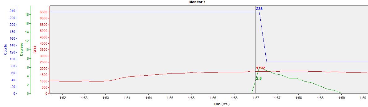

Looking back through some of my logs the logging speed in tuner pro is on 3.3Hz most of the time. im sure it used to read around 10Hz while logging. If my connection speed is this slow that means if i was watching knock counts i wouldnt see much But i would see the result of timing being removed on the knock retard value before any knock counts happen
Red: RPM
Blue: Knock Counts. 238 equales no knock, Drops to 92 when knock counted
Green: Knock Retard Value

- Knock retard before Knock counts.jpg (35.82 KiB) Viewed 7321 times

This appears to be showing knock retard is being logged before knock counts this is confusing given "There cannot be knock retard with no counts" or as this post points out it is caused by missing the knock count that generated the knock retard because of the slow logging speed if this happened then the knock counts should have already reduced and be shown at the knock retard point, assuming the logged packet is receiving all pids at the same time (unlike the LS1 logging). It would be interesting to see the result at 10fps and 30fps.sparx-1 wrote:VL400 wrote:

In regards to the log screenshot. It is the way the data is being interpreted, TunerpPro is drawing lines between engine data points. When logging two messages (engine and trans) data does not exist all the way along the line. The point marked in the log would have been when a trans message was returned. As this does not include the engine params, TunerPro draws a line between known engine data points, but in the process appears to create data. There was no knock retard at that point in time.

The average logging speed is around 10Hz while recording but when i play back the log. pause it and jump forward samples using ] short cut key on the keyboard and look at the Hz reading its around 3Hz logging speed is this normal because it is recording all data.
I will try tweaking the adx and see if that works
