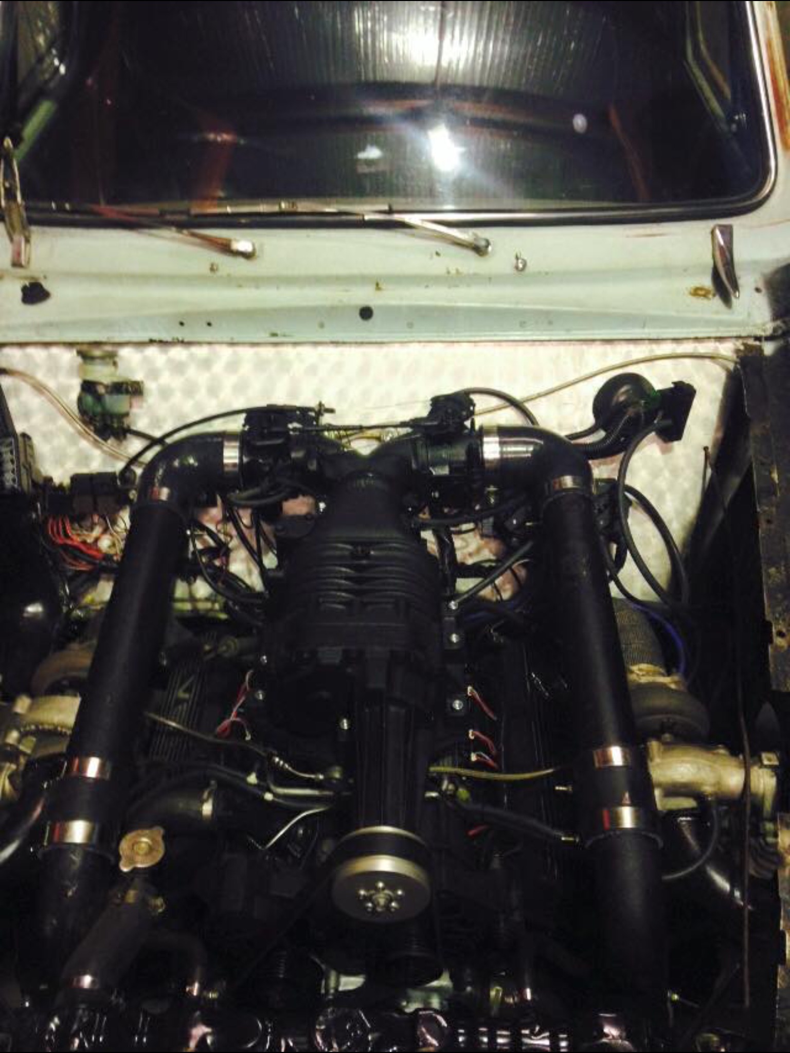

Here is my 1958 austin lancer it has been twin turbod for approximately 7 years it always ran scrap yard engines unopened had port injected nitrous (50 shot) two t28 garret turbos two nissan 300zx coolers and full manual t700 and a hilux diff blown heaps of head gaskets never thrown a rod its first run down the quarter was 13.02 @ 104mph its personal best is 10.98@126mph I have since mounted a m90 on top of factory manifold intake temps are too high so I intend on meth injection or e85 not set on either yet

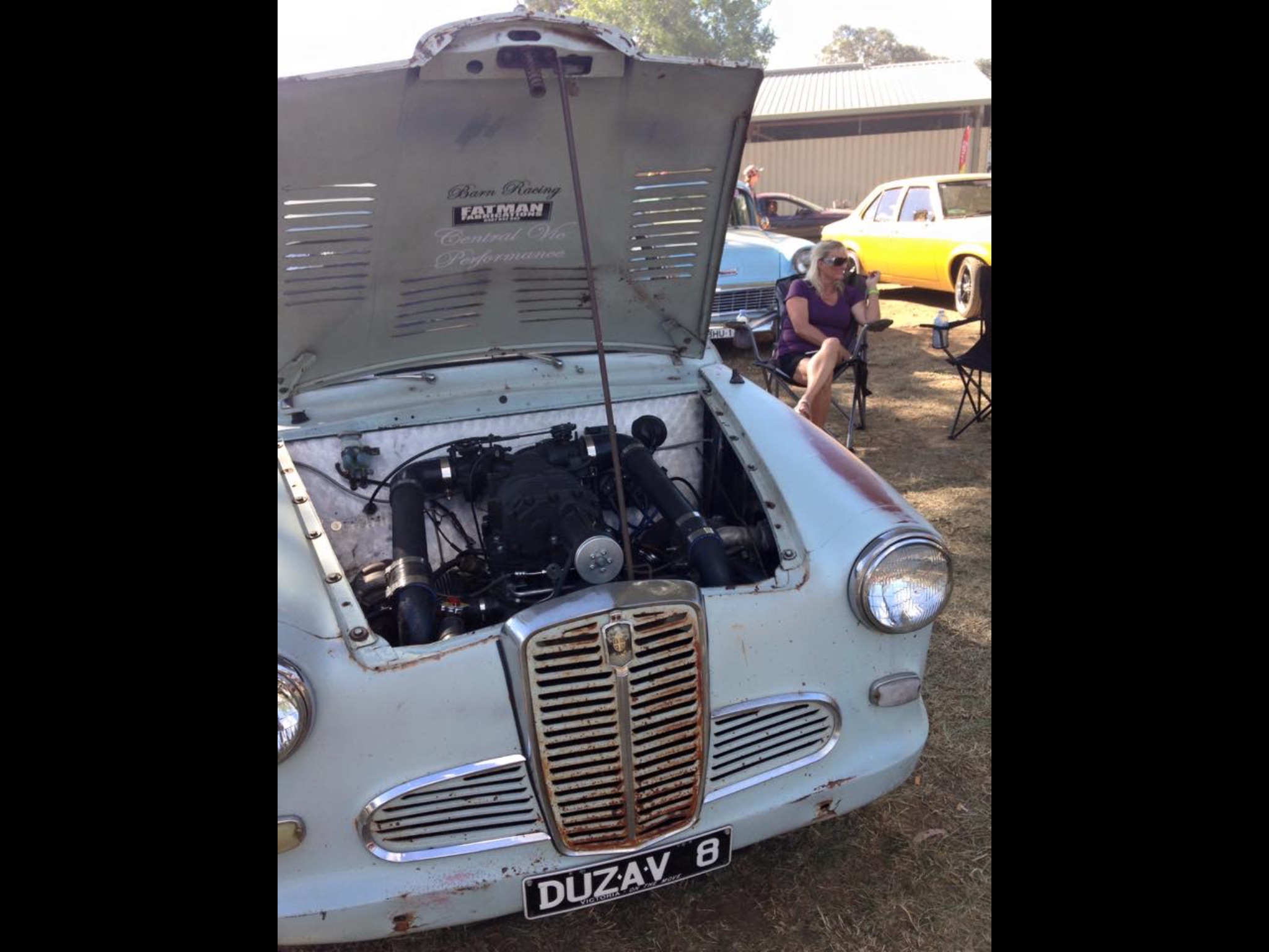

This is at summernats

Twin turbo t28 and m90 Buick running ported heads forged Pistons crow cam springs all balanced double row timing chain balance shaft deleeted
