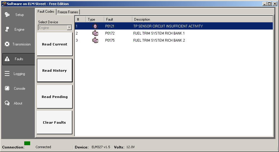

Chuff
Posts: 269
Location: Melbourne
Re: Software On ELM Street - OBD2 Software Development
Post by Chuff »
Current
Current
History
History
:thumbup:

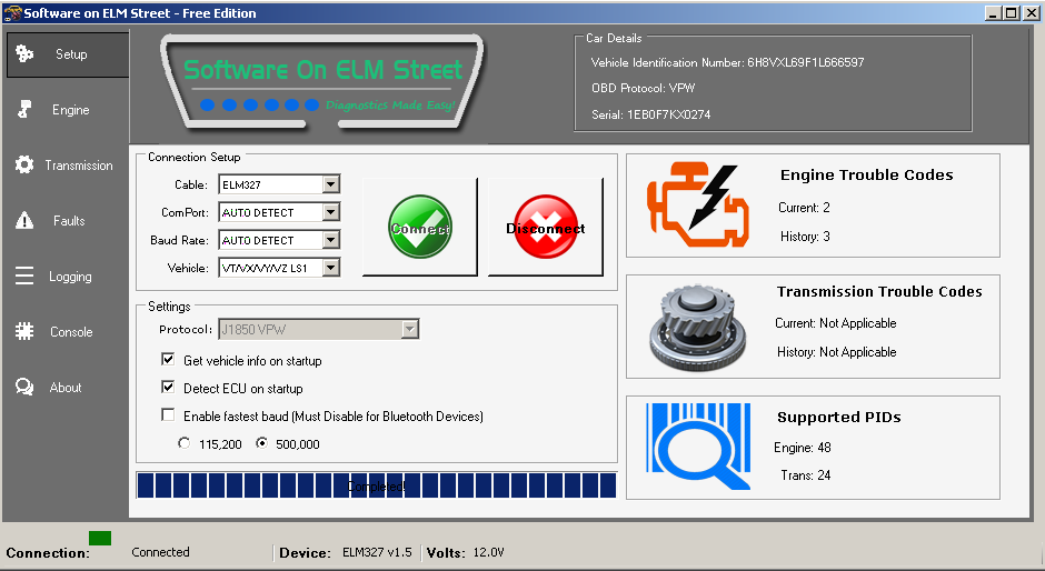

Chuff wrote:
:thumbup:
Awesome! Thanks for testing Chuff!
I did notice something in the pics though... the little "green box" is in the wrong place?!?! :lol:
Right... putting that onto the fix list

Post by Chuff »
Tazzi wrote:I did notice something in the pics though... the little "green box" is in the wrong place?!?! :lol:
I also noticed another minor thing. After clearing all the fault codes, I went back to the Setup screen and noticed that Engine Troble Codes had not been reset to Zero during the clear operation. It's only a small thing, but it made me look twice as I'd just responded to SOE telling me the codes had been cleared.
