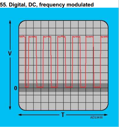

Ah - crap - you're right. The 2V/20ms is oscilloscope recommended settings, not actual voltage of signal...festy wrote:Are you sure it's 2v? I would have expected a 5v pulse
For the signal itself it says just 30Hz @ idle (900rpm). And this is the signal that should be there (if the scale is right... it should even be a 12v DC pulse ?): P.S. I bought a cheapie oscilloscope that should arrive next week, so I might as well tackle this when I can see the signal.

I connected a multimeter (finally
) and it gives ~12v. Will wait for the scope and check the signal to be sure what I'm working with.

Finally got it working - the main problem was - I was using the wrong source wire all along. The actual wire color used was different to the one stated in manual.
Anyways the cheapo oscilloscope (~20Eur) came in handy. Found the signal in the same connector, but different wire.
