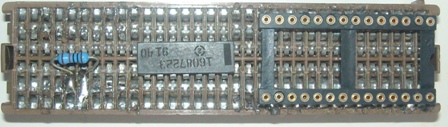

I need to modify a V6 (or such) memcal to run as TBI so that I can capture every igntion pulse as injection events from the FMD instead of the usual 3/1. I've only been able to find info going the other direction when folks to TBI -> PFI conversions.

yep, I did the same ting for my 2cyl motorbike, took a v6 memcal, removed the netres and changed it to TBI so it injects fuel every pulse.
https://pcmhacking.net/forums/viewtopi ... t=20#p3067
there is an image inthat post, maybe wait a little while till it shows up, looks like holden202's server is down right now.
edit: here is a pic of my converted memcal - that resistor is 10k

Re: netres help V6 -> TBI (inj every ign pulse)
Hi,
Thank you. That did the trick perfect!
Could anyone tell me if this is the netres for a four banger or a TBI setup?
Pin 3 to 13 is 15k
Pin 12 to 13 is 7.5k
Pin 3 to 13 is 15k
may well be 4 cylinder, if someone can confirm i'll add it to my pic
EDIT: added 4 cylinder config
Will be for a 4cylMOPAR wrote:Could anyone tell me if this is the netres for a four banger or a TBI setup?
Pin 3 to 13 is 15k
I wonder if three cylinders is possible? My neighbour has a turbo charged Daihatsu thats greatly in need of tune.
- VL400
Not with the current software but the new PIS software should be able to support it.
