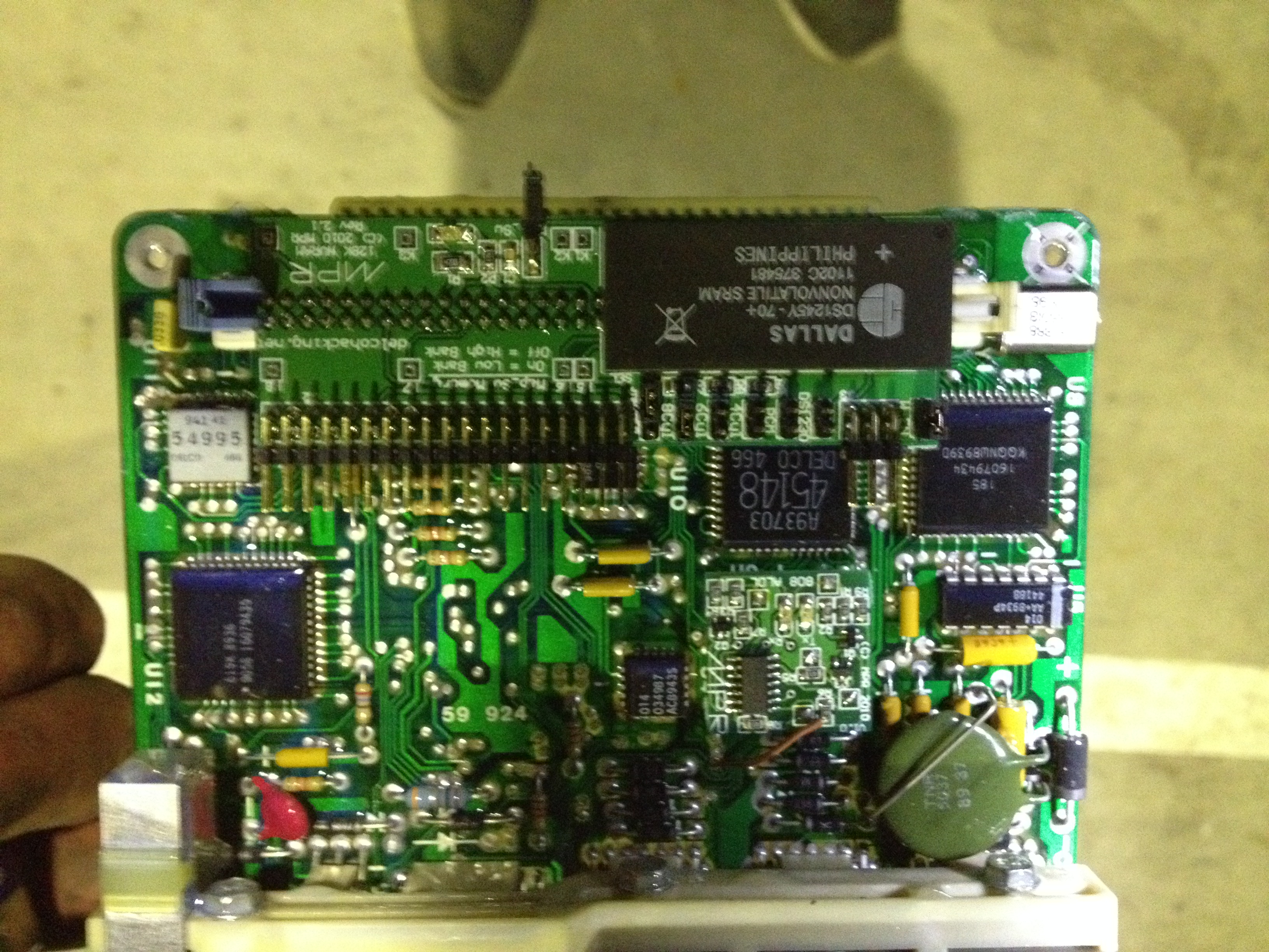

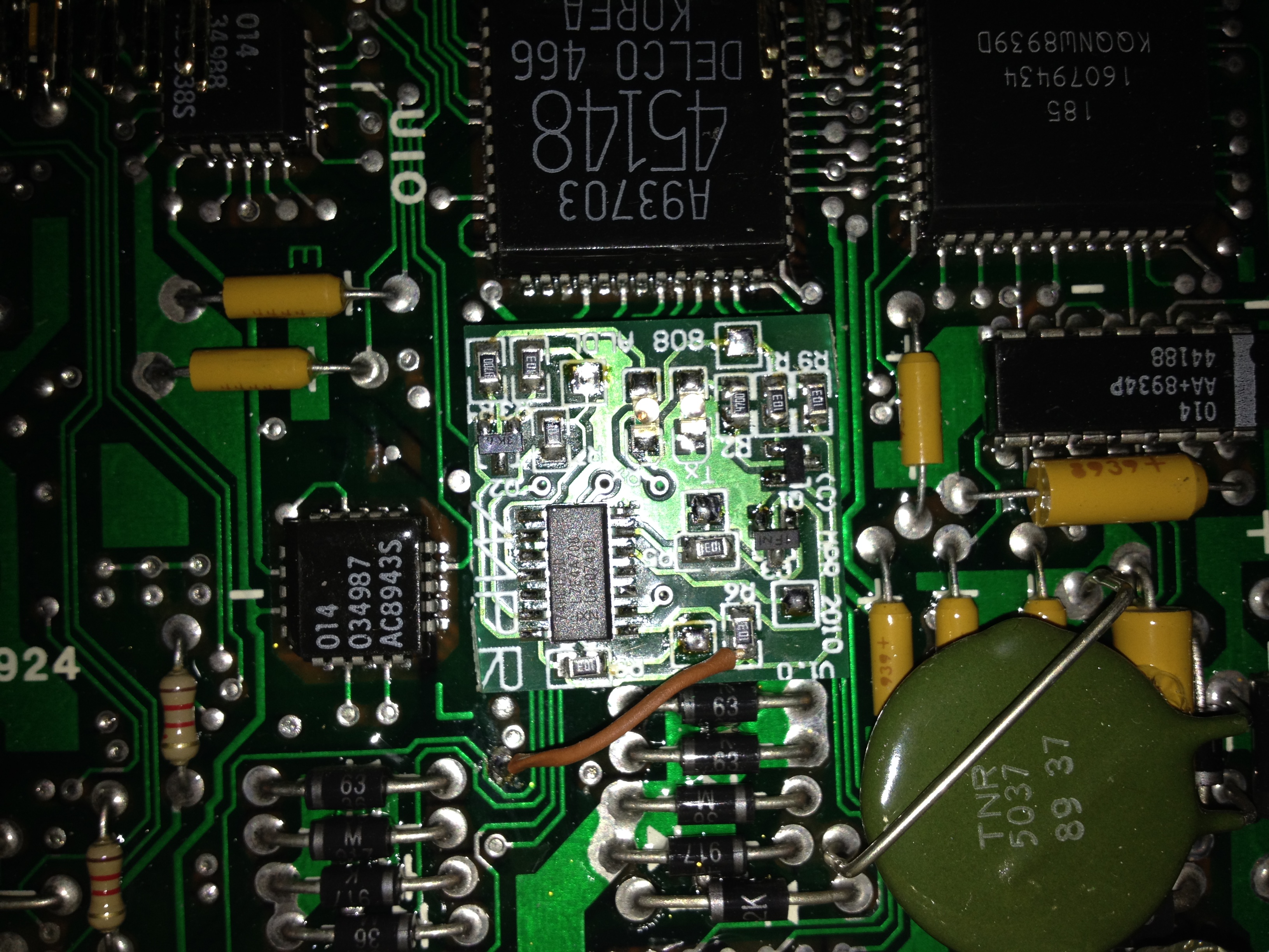

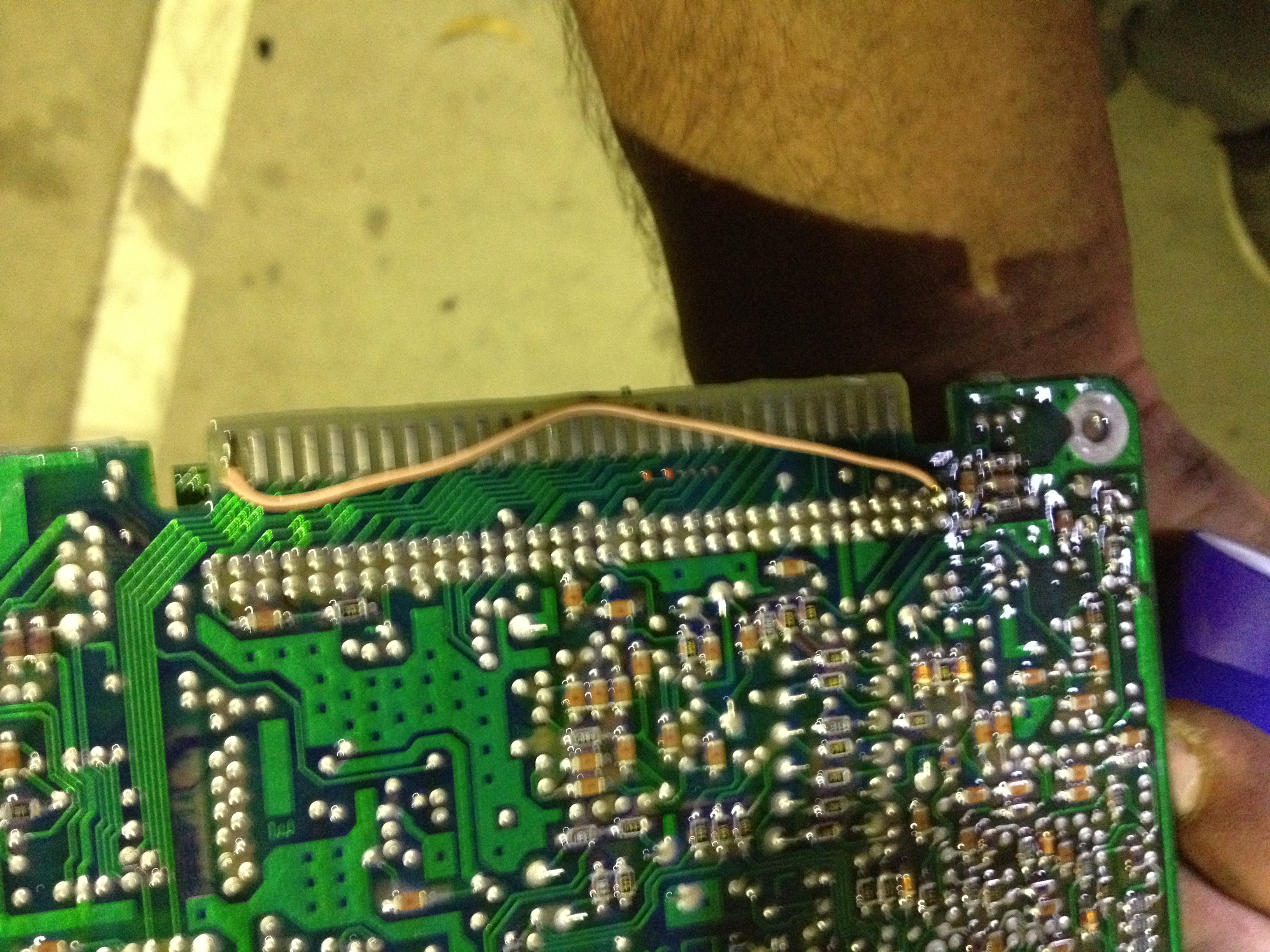

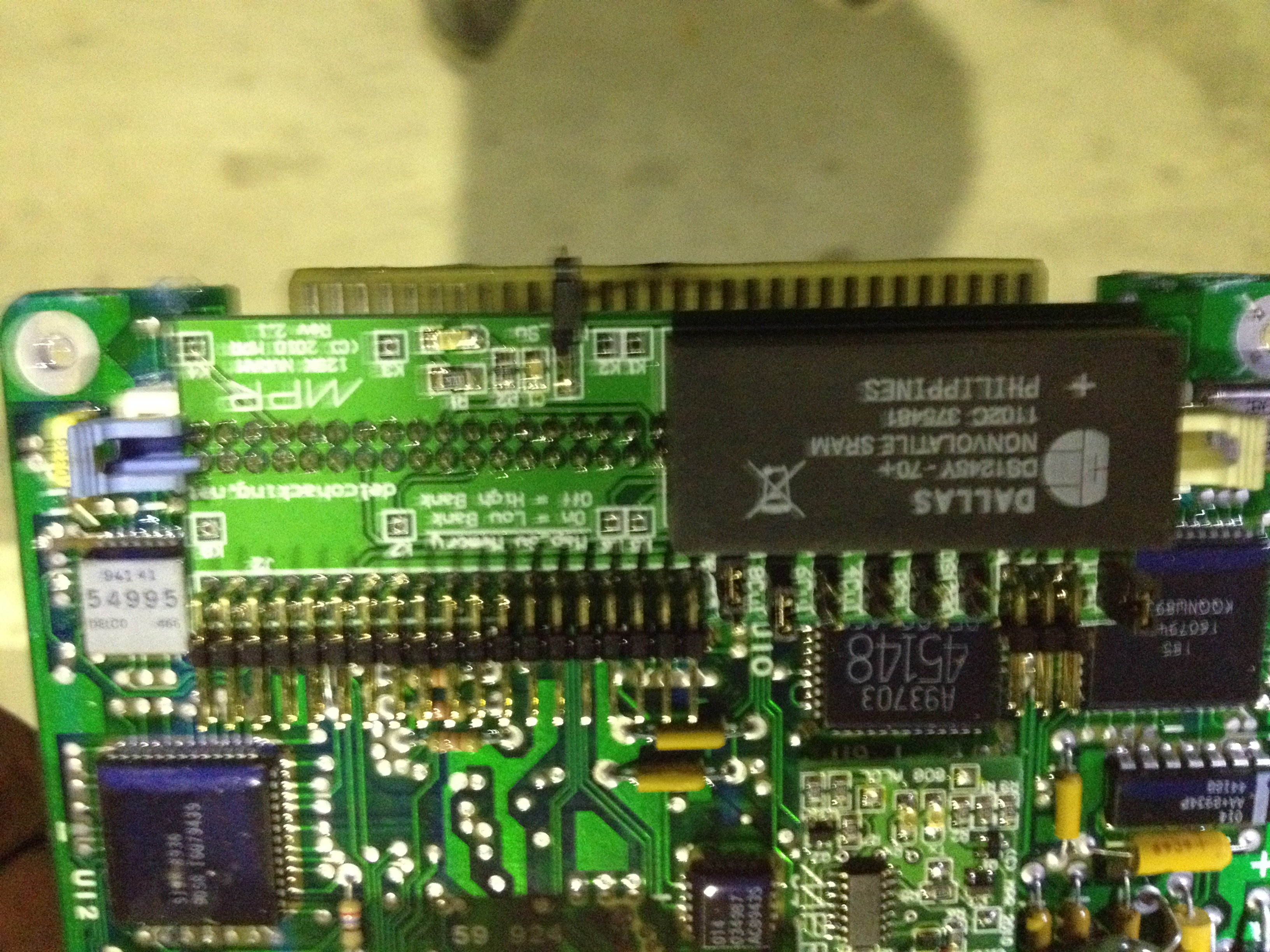

Hi guys I really need some help I've been trying to work this out for over a year but I'm not the best with computers I brought and 808 with your navram and high speed coms of eBay it works no worries with my car that I put it into but how and what cables do I need to tune it I got pictures off the computer inside so that you know it your product from pcm hacking sorry guys but I really need any adive or info would be great I'll even pay if someone can tell me exsactly what to do thanks guys

Have a look at the guides in the frequently asked questions are (FAQ). The link is up in the top right. That should give you a start and then you can ask specific questions.
Short answer though: you need an aldl cable, need to know what code is on the nvram and get the matching support files from this site. Keep the read/write jumper not set while your getting set up to give you some protection against corrupting the nvram while your getting it figured out.

Also, being an SXR type and depending on your application you might need to install the obd port on the car and add the ALDL wire to the loom. The pinouts are in the 12P zip files.
