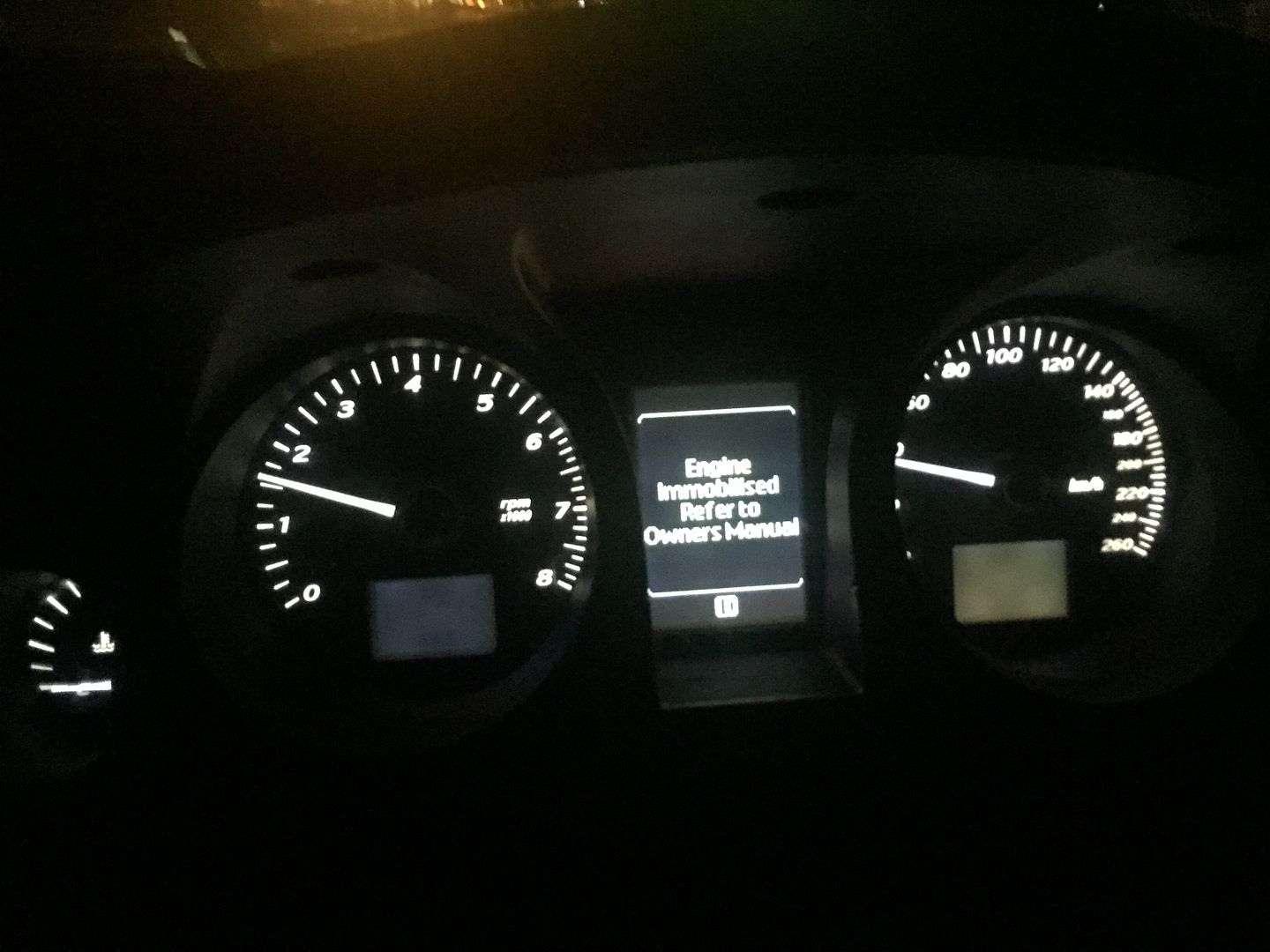

Driving home last night in my latest acquisition and it does this, I pissed myself laughing... Haven't looked into how or why yet :lol:
Its a V6 and it clearly isn't immobilised

Computer says nooooooooooooooooooooooooooooooooooooooooo :lol:

Well, that message is clearly not correct going by the reading on the tacho :lol:
