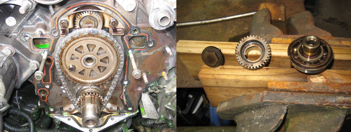

In some areas I've been lazy... almost, got some code for the BT project... but can't be bother to play for now. Other life shit.
Instead was the starter motor replacement and delete of the balance shaft gear program. Turned out the bad starter was actually a slightly loose and dirty engine ground cable terminal on the engine. Fresh as it was when I installed it only a few months ago. :evil:
I put a multimeter between the engine block and the battery gnd to see if I had a bad connection under load. Yes it did, indicating a voltage drop showing a bad connection or cable inline. Cleaned and sorted, and all is good.
Since the rebuild, the engine has had a small knocking sound most noticeable at idle and cold. I decided to try and exempt the balance shaft.
The rear balance shaft bearing wasn't replaced on advise from the machine shop and its condition has left me sleepless.
So yesterday I removed its drive gear. On the next edit, I'll find the camera and upload the few photos. About 4hrs to remove the timing case etc.
Much smoother, no new noticeable vibrations yet... if anything it revs happier and has a slightly new growl at the magic 3000-5000rpm.
We threw down about 350km on a lovely run to see the in-laws today.. everything ran perfectly- and we towed the 7x5 trailer to pick up a new couch.
