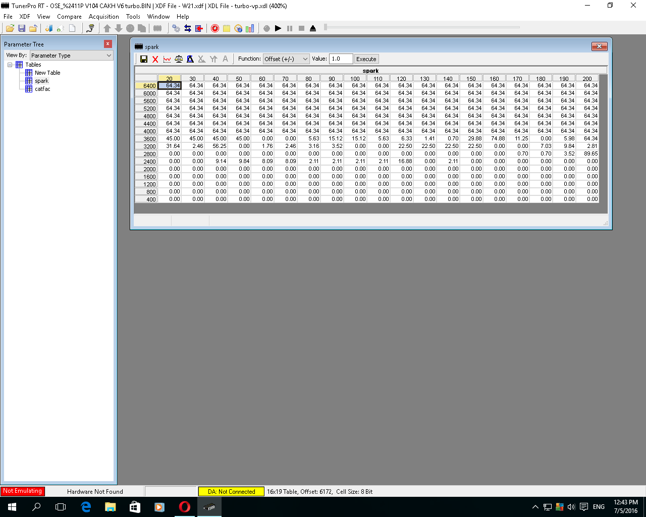

Postby VX L67 Getrag » Tue Jul 05, 2016 7:56 am
so seeing the 3Bar axis are too hard for anyone to get, if i setup the adx to trace actual map & rpm figures logged does it fill the defined tables with the guessed values setup or is it actual figures that are achieved(not defined).
I hope that makes sense?

w21 2bar here 3 bar just double the on boost so 110kpa is 120 then 140 160 180 200 220

Thanks Holden202T, yeah I know how the ADX works... But yeah was just going to try & map logged actual VE & see what lines up with the xdf but a lot of work & not sure how reliable it would be!
Thanks delcowizzid that is a great help, how come the rpm axis is 6400 to 400 rpm not 400 to 6400 I guess thats gunna make a big difference to unless its setup to read reversed in the xdf for VE.
