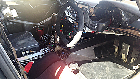

But definitely something that should have been added in... Wonder what they do for the V8 super cars?? Guess they would also be doing it for the newer VF ones?

The V8 Supercars at Vf in name only. They have never see any Vf wiring and user motec stuff.

I spy with my little eye... a mylink... and instrument clusterCobalt wrote:The V8 Supercars at Vf in name only. They have never see any Vf wiring and user motec stuff.

isn't the mylink only used as a screen for advertising?

from what i've seen yep!

Id say so!. Been trying to find a video of the dash while driving although havent found anything yet.Biggvl wrote:isn't the mylink only used as a screen for advertising?

They alternate different sponsors logo's

That's a carbon fibre panel that's empty. Holden paid 888 to have it made to make it look more like the roadcar. The motec dask is in the carbon pod on the steering column.Tazzi wrote:I spy with my little eye... a mylink... and instrument clusterCobalt wrote:The V8 Supercars at Vf in name only. They have never see any Vf wiring and user motec stuff.![]()
