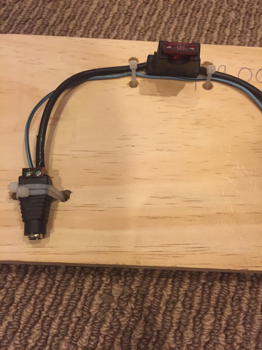

- A battery or 12v DC power supply unit (i also brought a connection for my PSU that allows bare wires to be connected
- A fuse with holder (optional but a good idea, 10amp is plenty)
- A switch (not essential but can help if you want to simulate ignition ON/OFF cycles)

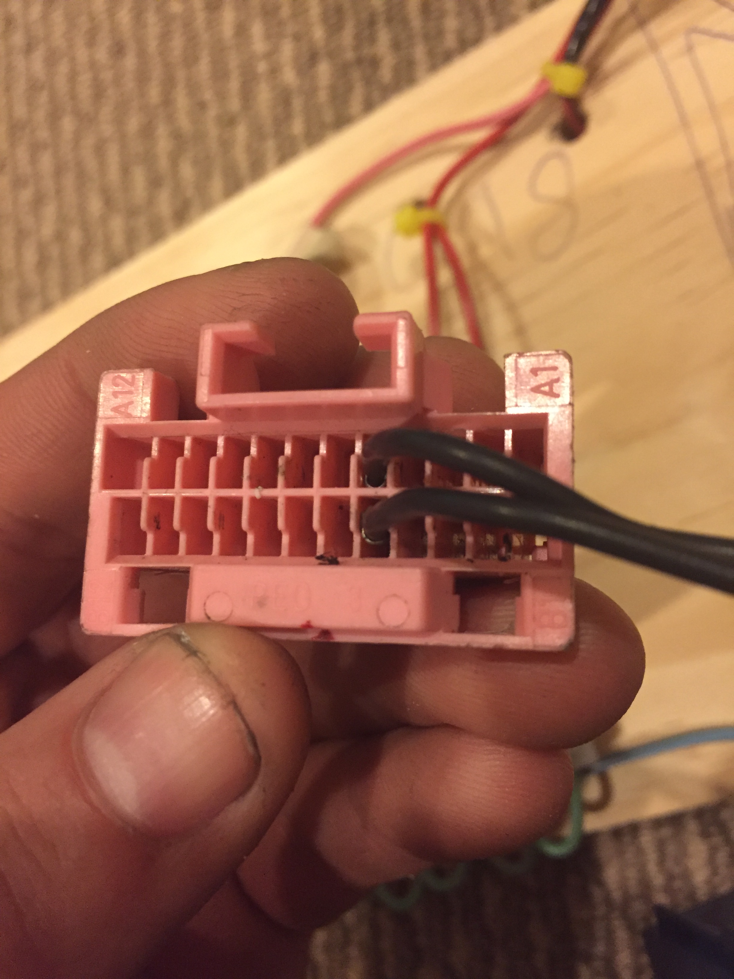

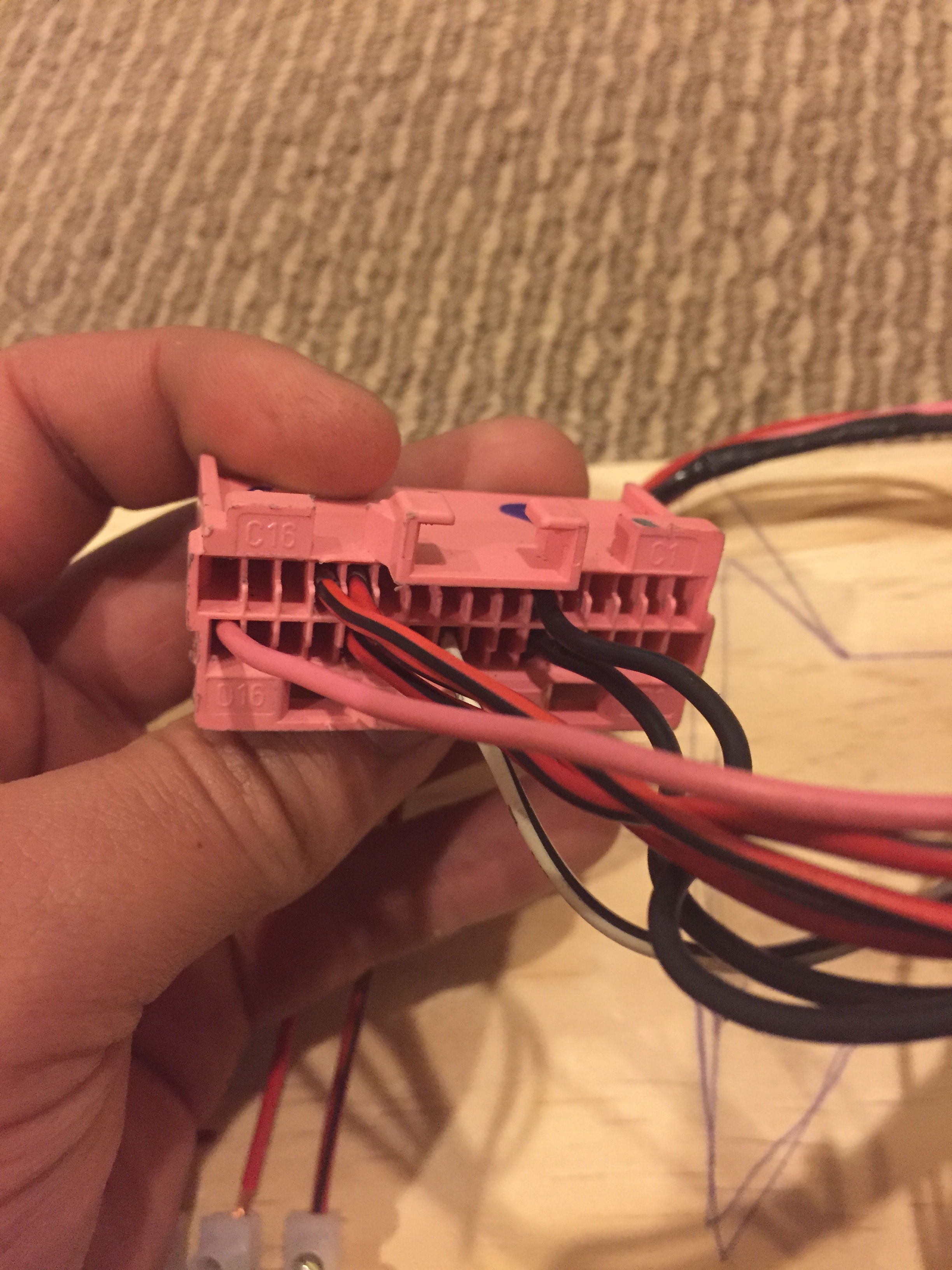

What i did first is i depinned all 3 PCM plugs to keep things tidy. once you do 10 the rest are a breeze. Heres a youtube clip from BiggVL that shows how.
All the plugs are stamped on the ends to what they are ie A1-A12 etc (you will see these stamps in the pictures)

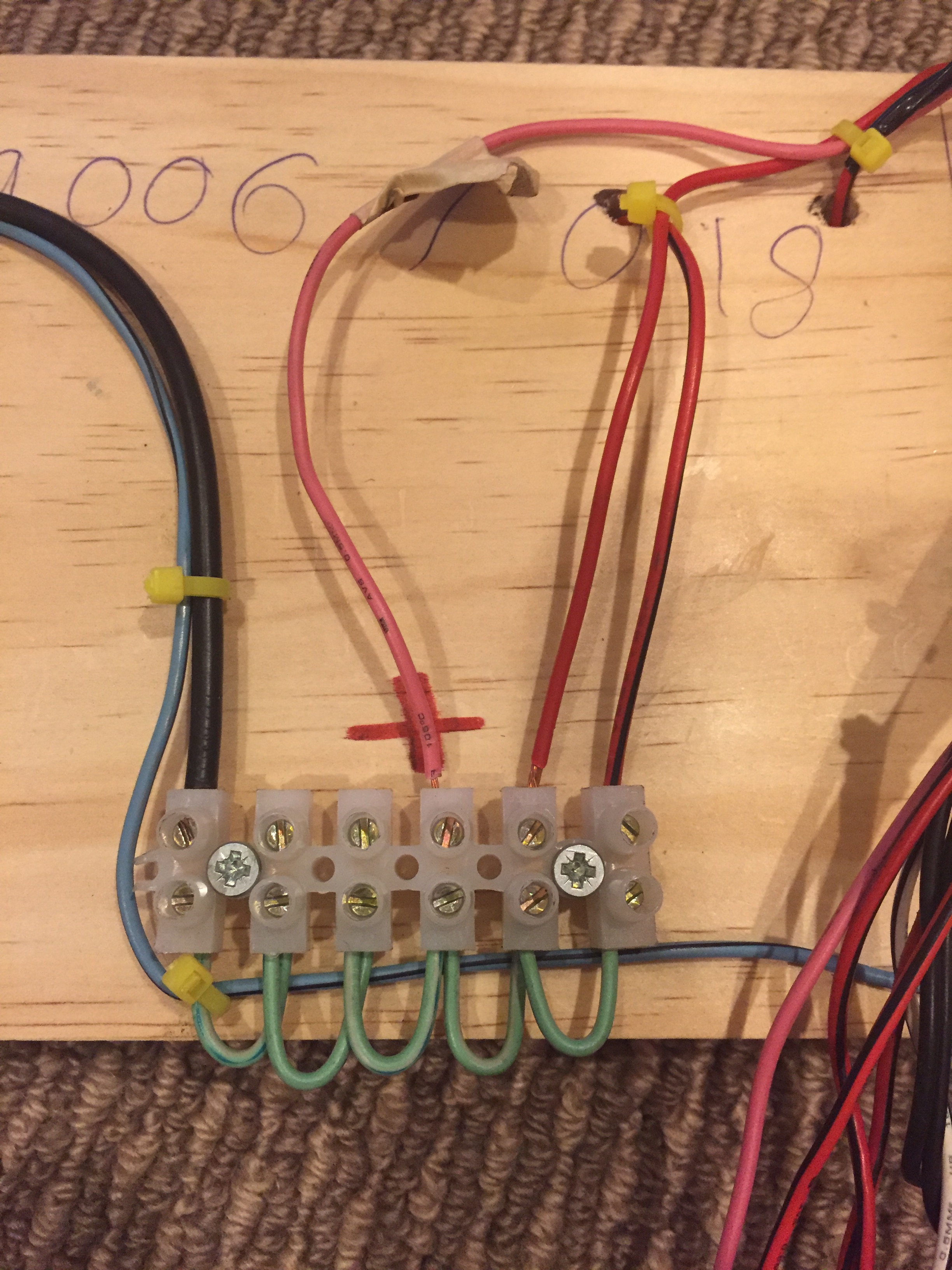

Your 12v positives are
C12 & D12 --------12V
Your 12v iginition wire ( this can be on a switch or attached when ready to connect )

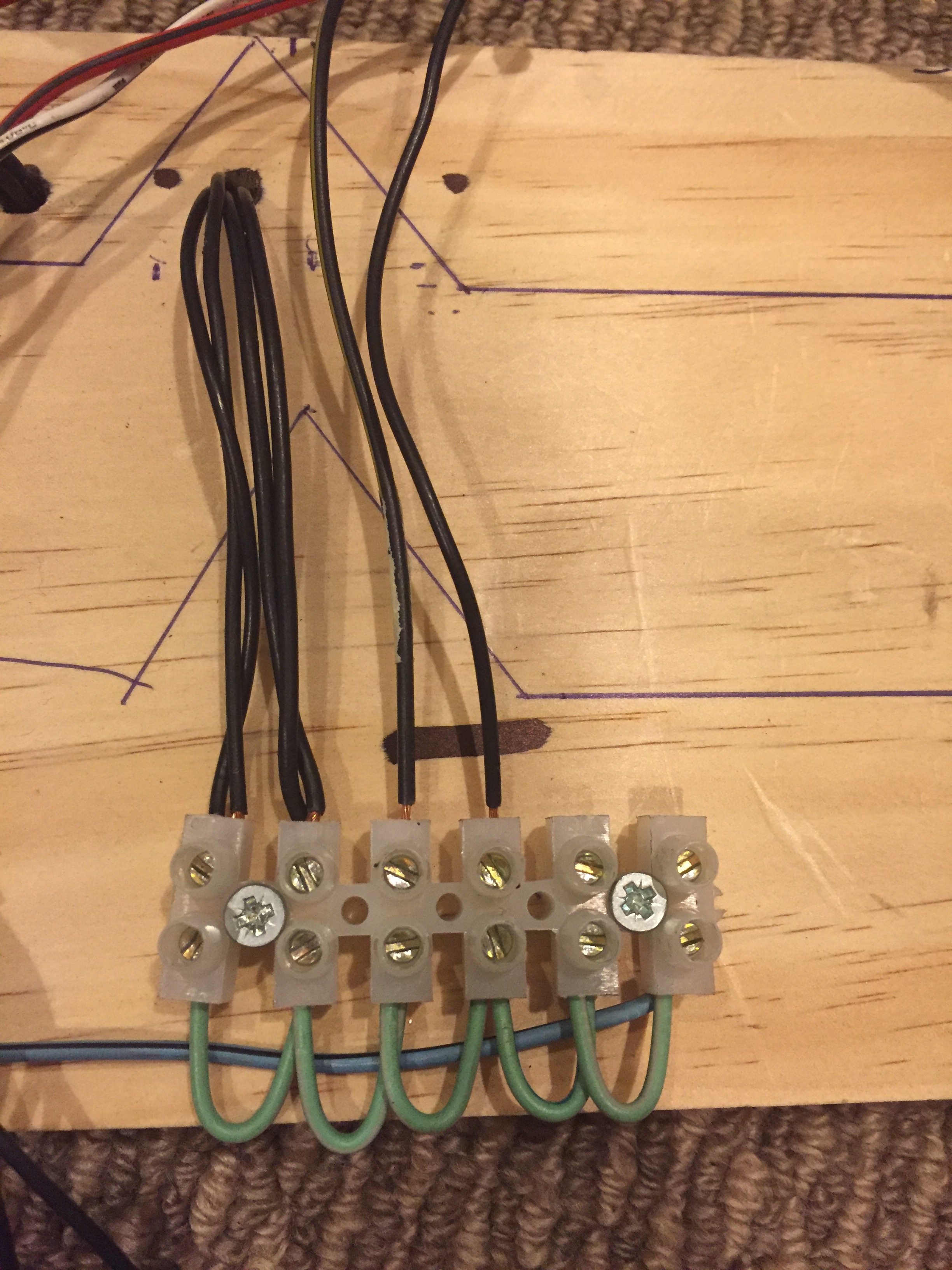

D16
I connected all my positives to one distribution block and from there through a 10 amp fuse to the + PSU and all my negatives to another block and from there back to the - side of my PSU

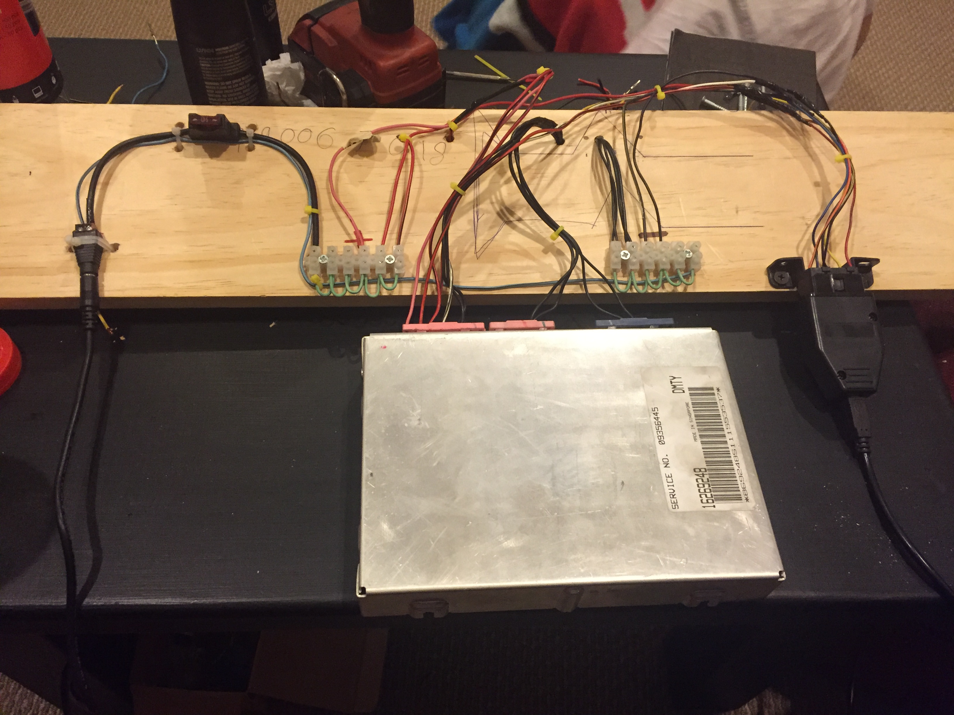

You then need to connect your PCMs serial data wire to your OBD connector
This is
C13 PCM ------> PIN 9 OBD
And your PCM Diagnostics wire
D09 PCM --------> PIN 6 OBD
Now the earths for your OBD
PINS 5 & 4 ------> EARTH
And last you need to connect the 12v of your OBD
this is PIN 16 --------> POSITIVE
PIN 1 is located below PIN 9
and PIN 8 below PIN 16

The flash pcm wiring harness's are light yellow & brown, the pink & blue are for memcal based pcms.
You can do flash pcms with just the single end wiring harness, I think I got it down to 5 or so wires.

Top write up, thanks for putting that together and bigvl for the vid and vxl67 for the notes. I'll also add that 12v at the obd isnt needed for this as our aldl interfaces power from the usb, but its worth having it incase you plug in some other tool another day and it does need it. Its worth putting it in while your building it up.

Great write up thanks, and awesome you got it to work
For a minimalist loom, and all on one connector can use the following...
D6 - Ground
D12 - 12V Battery
D16 - Switched Ign
C13 - ALDL

I have the same minimal setup as VL400 does. Both 12v bat and ignition are tied together on my rig.

And aldl and gnd out to the obd port at a minimum.
