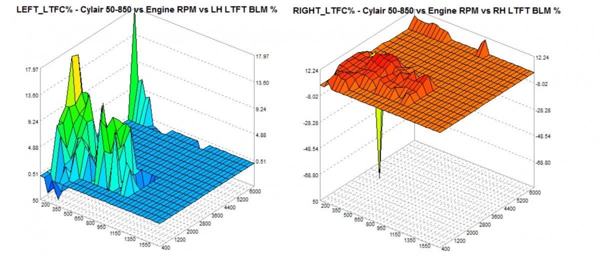

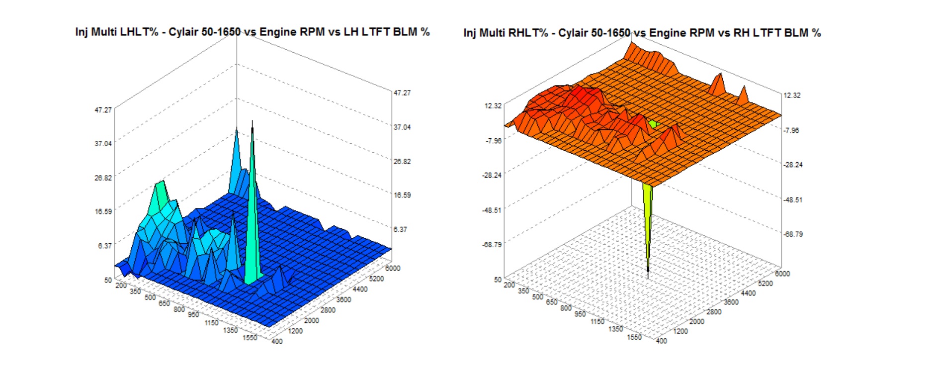

Hey fellas,
Trying to interpret logging results, still shows some bank differences that even a rebuild and new injectors didn't solve. Hmmm
But I have a more pressing concern. Most of the cells are positive values. This means its ADDING fuel correct?
Therefore its probably running lean at WOT when its ignoring closed loop. iirc. Feels like she's running a bit flat.
But exactly which table needs to be corrected for maf tuning? I just can't find what I need searching.
Here's the log,
fromColac.zip
(550.44 KiB) Downloaded 394 times
to be opened in VS_SC_$51_enhanced.xdf
Thanks heaps. :mrgreen:
edit, Here is the bin as it stands.
VS_SC_T5.zip
(43.47 KiB) Downloaded 357 times

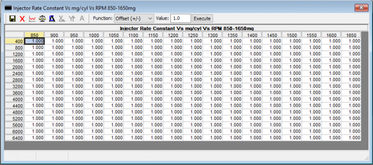

I thought it was this table, but its all 1.00

Fuel trims are based off NB O2. I've read about some earthing problems between banks on the ecotec.
Could be worth a search for a better explenation.

The above table (850-1650) is the extended table The1 added so was set to a default of 1.0 as there is no factory info (as it never existed).

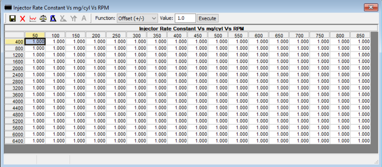

Going by the above graphs you need to look at the 50-800 injector rate constant table mostly.

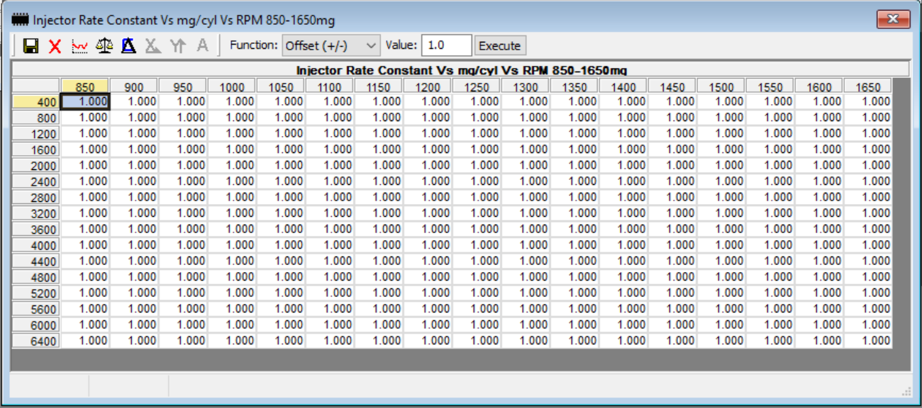

immortality wrote:The VS V6 had the wiring issue with the heated O2 sensors.
Makes sense, but the other table is the same too?!

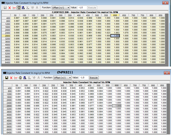

By comparison, this is the tables from the VT bins
Top Stock SC V6, Bottom HSV SC V6
The tuning guides don't talk about maf really.

Ahh, sorry. VS never had injector rate constant tables so The1 added em.

To tune it you want to adjust the injector constant tables you linked above (that are all currently set to 1.0) I thought The1 had made up a spread sheet where you enter the data from the original injector constant table, add the fuel trim data and it then spits out a new injector constant table?
edit: This is what you want to use Injector multiplier tuning.xls
