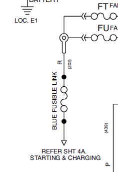

hi, would anyone have the "sht 4A starting and charging" schematic as shown in the attached wiring diagram for vt series 2?
im still trying to sort out differences in the series 1/2 looms.
i found that it will start with aldl pins are bridged but cant get fault codes. without pins bridged car wont engage starter motor everything else fine and once started i can unbridge

Re: Vt series 1 loom onto series 2
hope this helps.
let me know if you want anything else.
looks like it just pulls +12V direct from battery dude.
