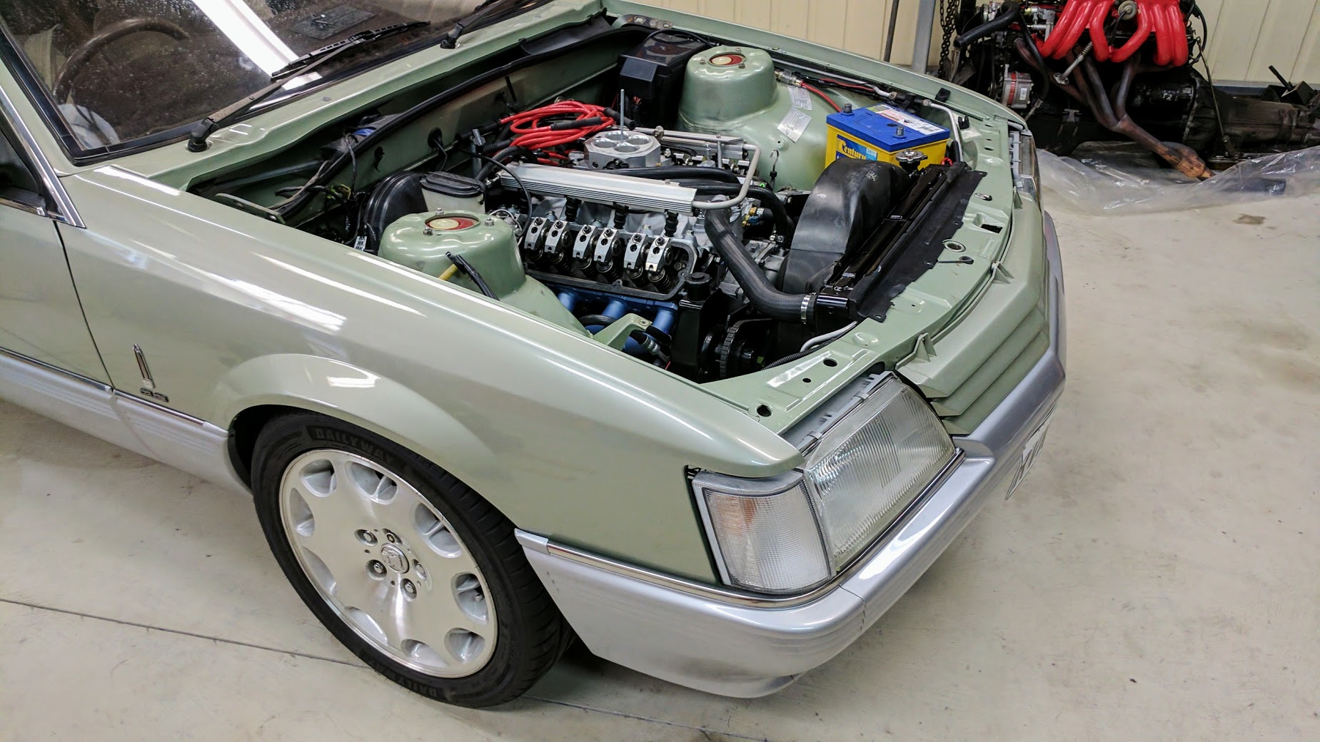

Well I finally have the VR 304 and 4l60e installed into my VK Calais and have been sorting through the teething problems.. :)
One issue I am still having is the trans is up shifting at around 4,000 rpm for each gear.
