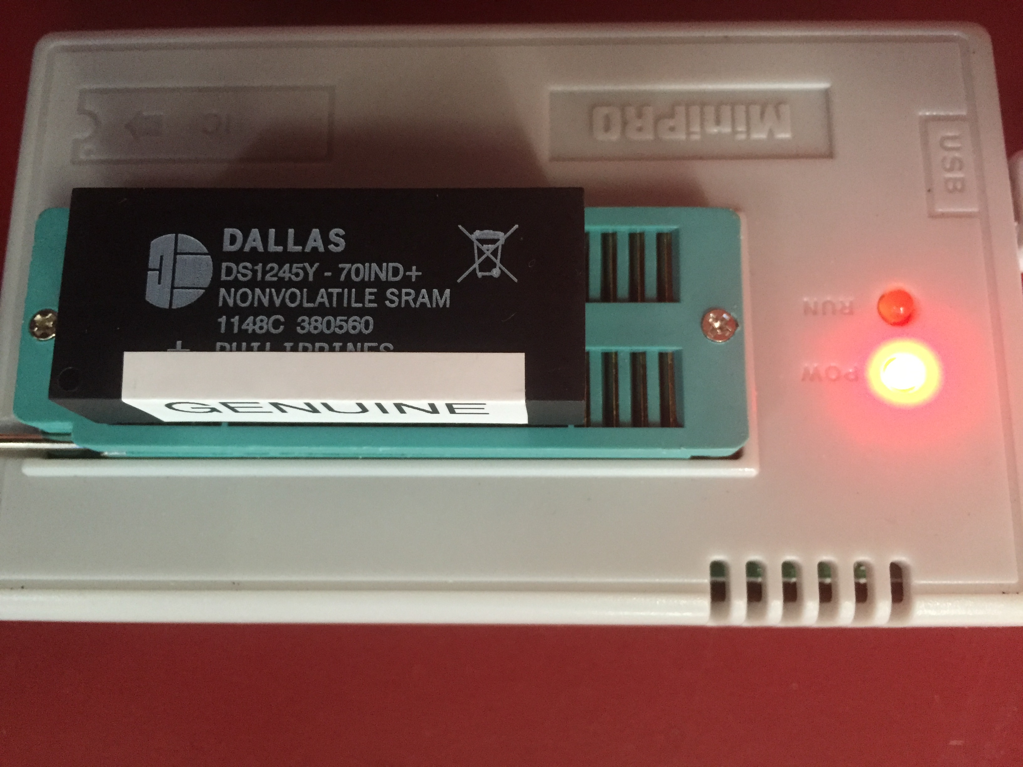

DS1245Y chip

Cool. For reference thats a week 48 of 2011 nvram. They state they should last 10 years but ive seen trouble in 7 worst case/worse conditions. Interesting genuine sticker but its good to know whats what i guess. Glad you found the problem!

I had a fake ds1245y so labelled the good genuine one.
