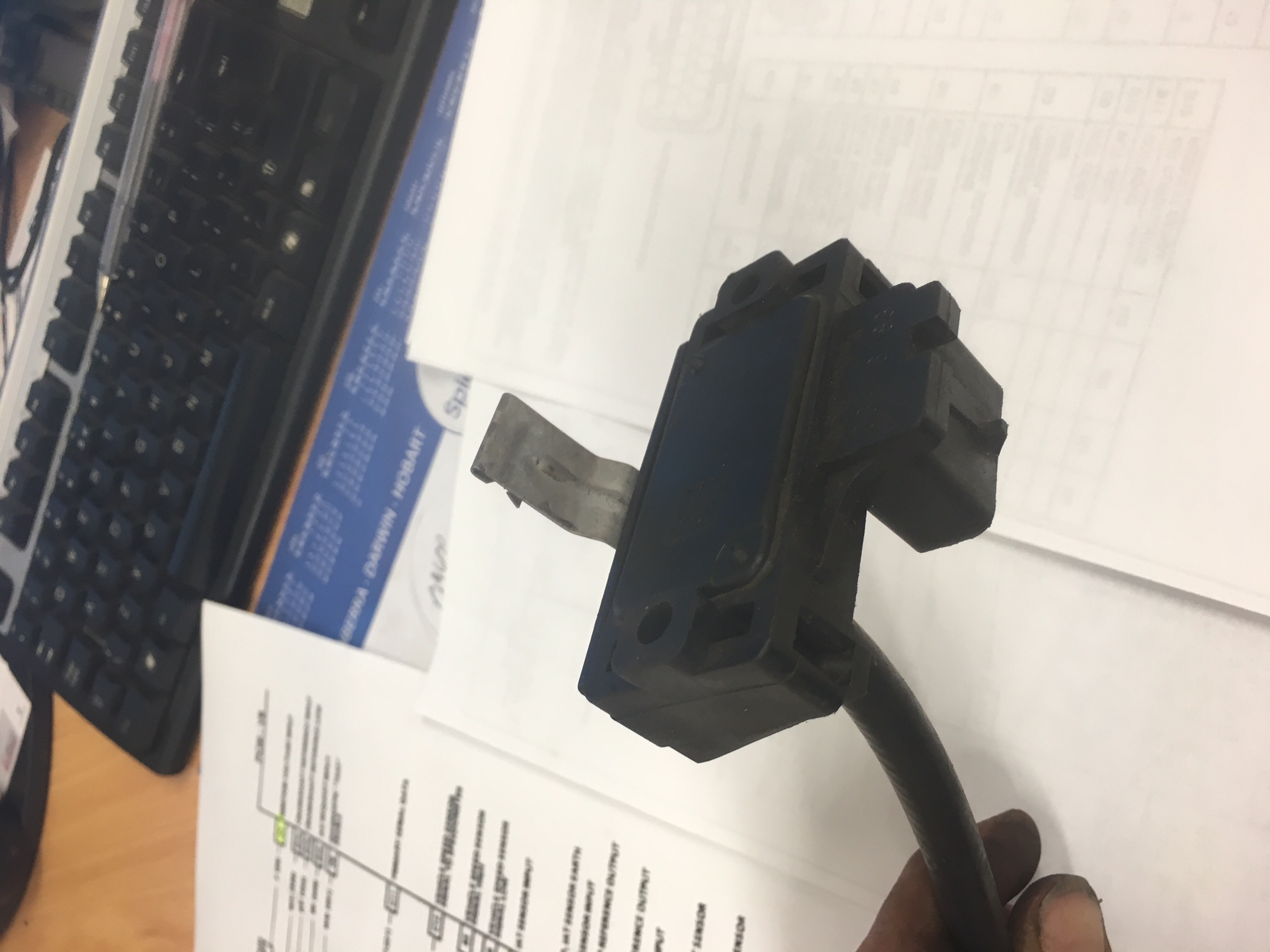

A module, the wire is there is nothing here for it to connect to, so I can only assume I don't have one

I found the plug for it too.

Re: VS 5L into 2a Landrover
Map sensor. got it.
Still nothing on the ignition module
You'll need one, out a wanted post on here somebody might have spare one. Hundreds around but they can be hard to get a good one. They hate moisture and heat, engine was a wise split to out then by GM. Great for spare parts sales anyway.
Ok, I'll pop a wanted ad out and see what happens.
Yea that could be the go.
I'm guessing once you deliver power to the unit from the ignition side of the key, the rest should work independent of the vehicles wiring loom?

- Posts: 9008
There are EFI and Fuel pump relays that feed in to the loom you have, but all the power flows through there. The JE camira / n13 pulsar looms have a nice little 2 fuse/2 relay box which is great for this, but you could use anything.
