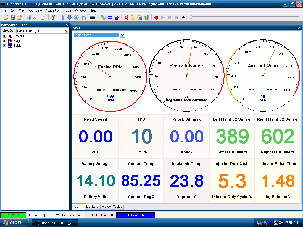

I did a quick www search & a search here with no quick answer, figured I'd ask instead.
My guess is I have a lazy 02 sensor, figured I'd ask before attempting to play around too much with the sons car, play time is limited these days..
Screen grab of dash after 10 minutes of running, thanks for the input..

Really need to see a graph/plot of the 2 O2 sensors and commanded AFR.
When commanded AFR is 14.7 should see both sensors toggling across ~450mV, if you add the O2 cross counts should be able to see how active the sensor is as well.

I just fired it up to work out how to graph / plot the 02's, I'm either missing something or need glasses, couldn't see the 02's / AF in the graph when I clicked on the option in TunerProRT.
I've not done much more than buy the gear from here & set it up as best I can reading posts on here, beyond that I have zero experience / knowledge of what/where & how..

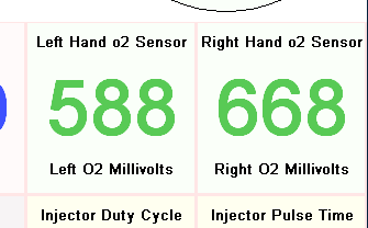

This is as far as I've come since buying the hardware..
Worked out how to set it up regarding plugins & relevant code to connect to the laptop, fiddled a little with the dash options in the adx, & downloaded a few video's from youtube to get a plan of what to mod & how, figured I'd do it whilst the old donk is still in this ute, he scored a new one recently & has plans to put it in before Christmas..
What other dash options should I add to this setup below that i'm likely to need / use being a 1st timer,, i'll ditch the speedo, it's just a fillin.

Hit the monitors tab and right click the graphs to choose whats displayed. You'll be able to see the o2 swings there.
