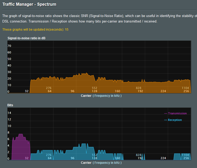

Yeah thats right. You can get way better SNR out in the bush over long distances because the noise is significantly reduced from less population density generally meaning less sources of interfearance, including less digital lines in the same cable length.
Its interesting when you break it down to SNR by carrier frequency though. Generally the signal falls off at higher frequencies, but the modem often needs to notch around interference sources which could be resonant frequencies from connectors in the line or other strong interference sources. To show this, this is my line (5.5kms) in the CBD. I get somwhere between 5.5 and 6.5 mbit, and I see significantly different SNR (and speeds) after the rain due to Telstra doing an insufficient job time and time again of repair work to the line. (Asus N55U modem, stock firmware)
- 2017-05-22 modem snr good in the dry.png (43.53 KiB) Viewed 8208 times
