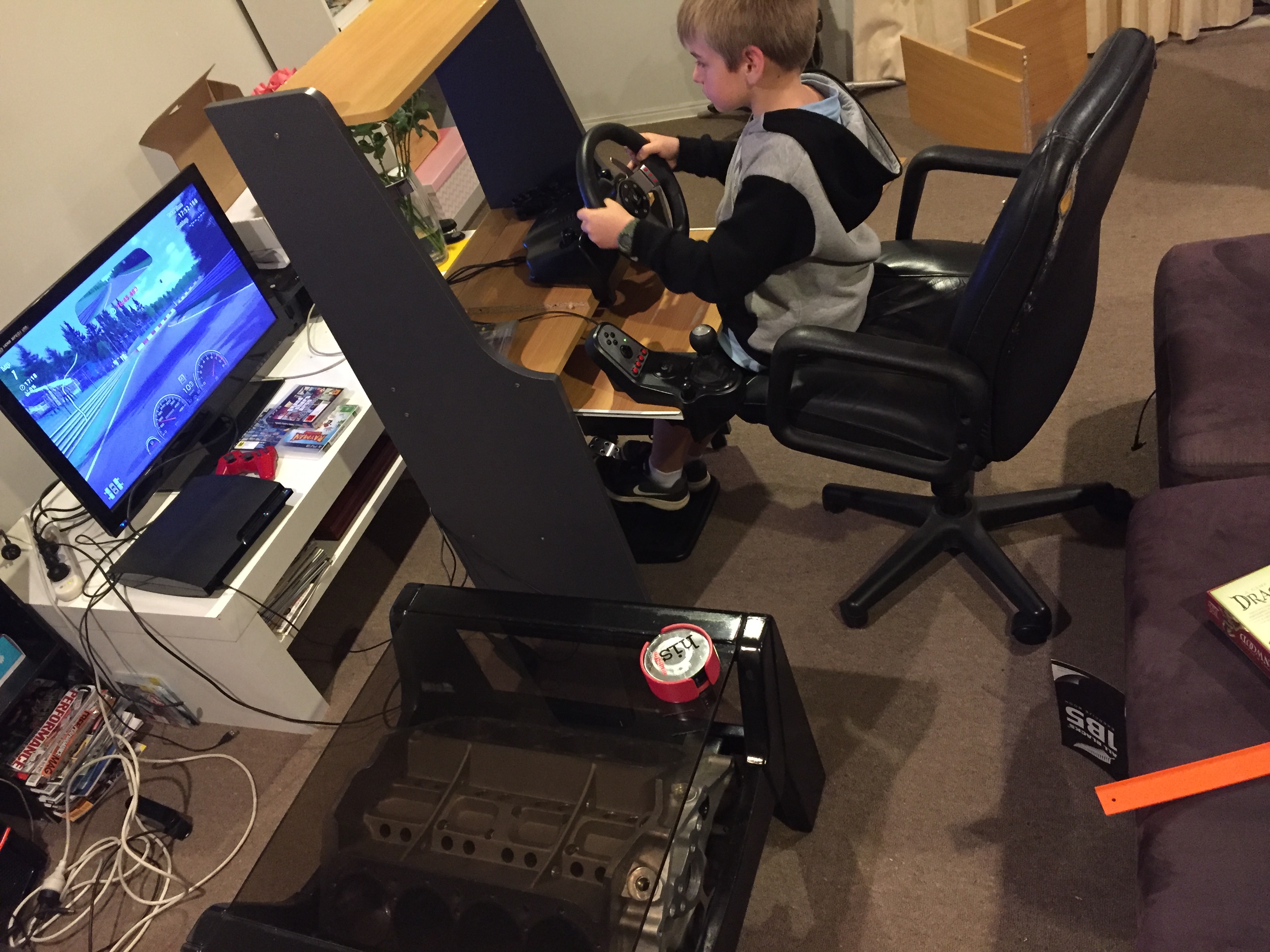

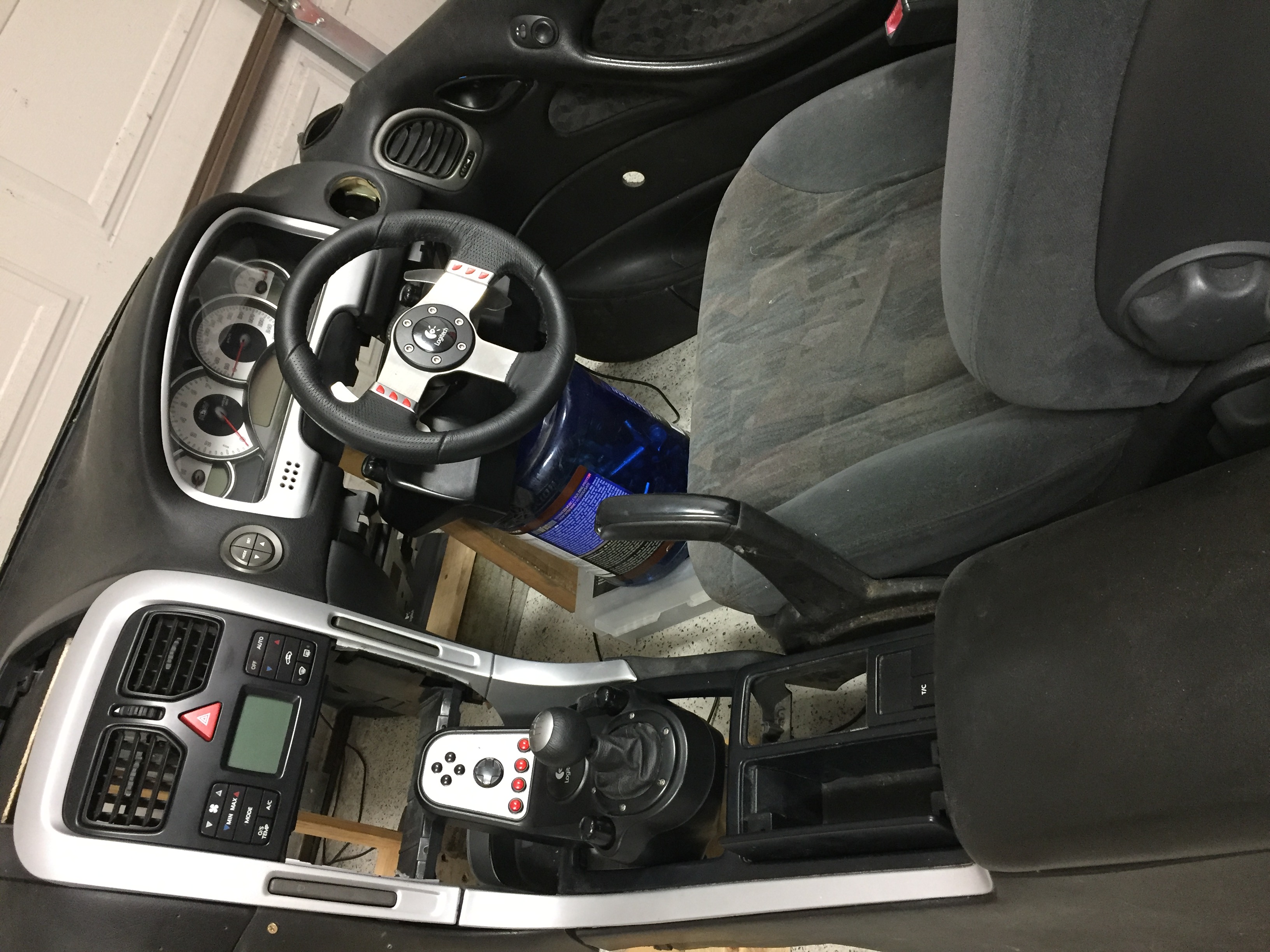

So I recently made a purchase of a g27 after selling my old one a few years ago which I regret
So when it arrived I chucked it on an old desk to test it still functioned
The young fella did a few laps on gt6 before I packed it up ready for the build

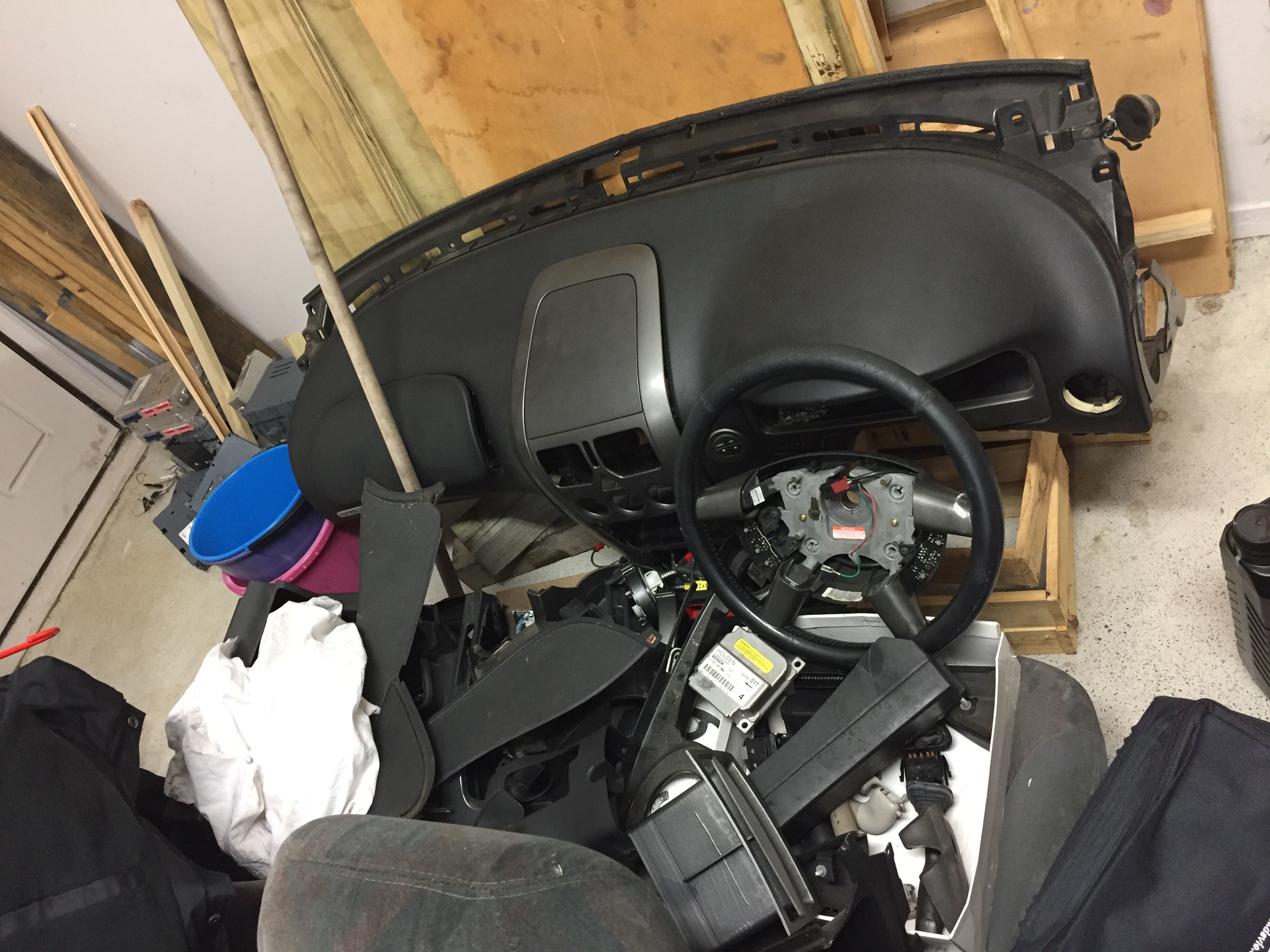

I had a spare dash from a vy acclaim I wrecked gather dust in the shed
Plus a lot more parts I've collected
I had a few HSV trims floating around so I threw those on for good measure,

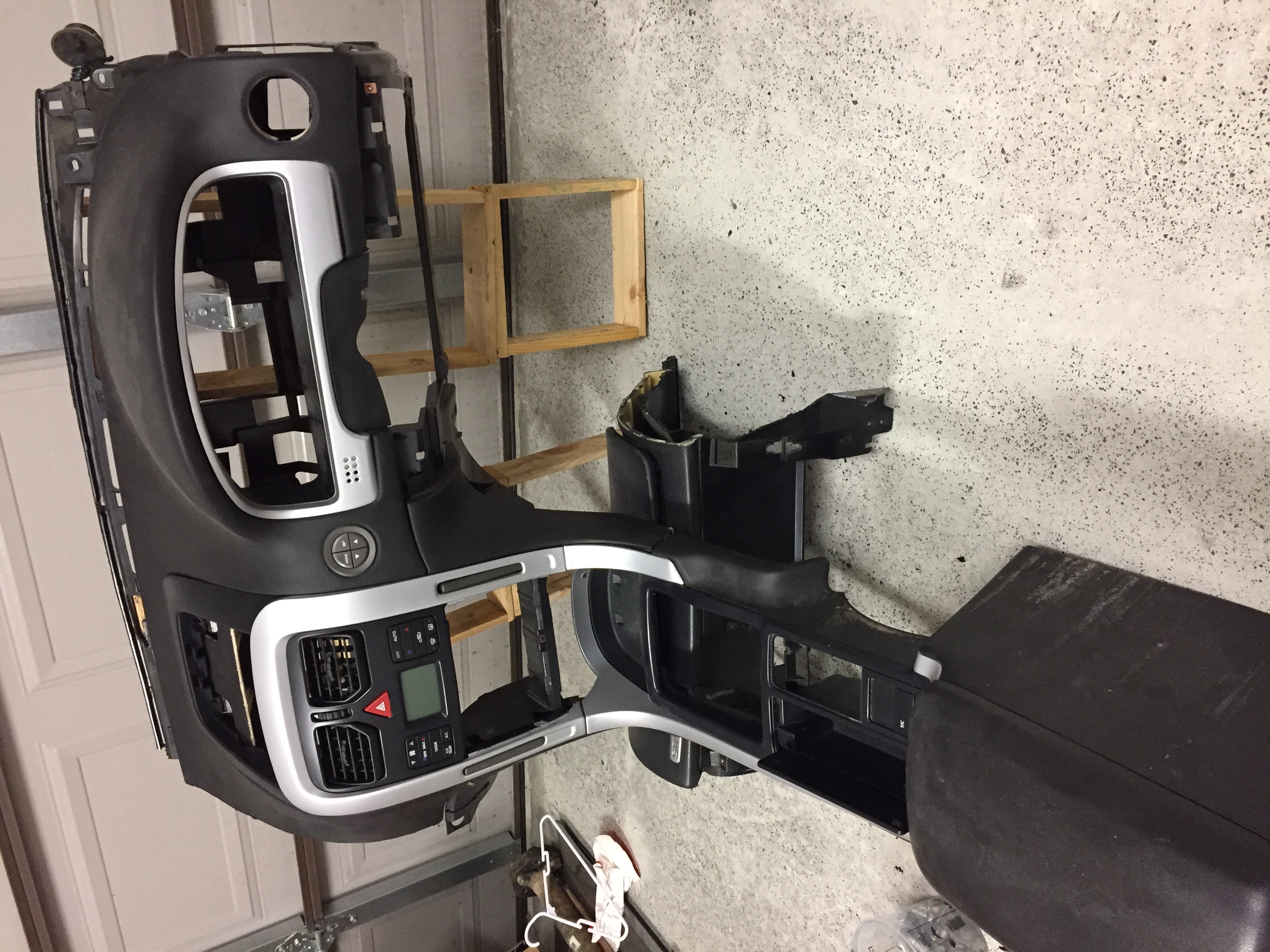

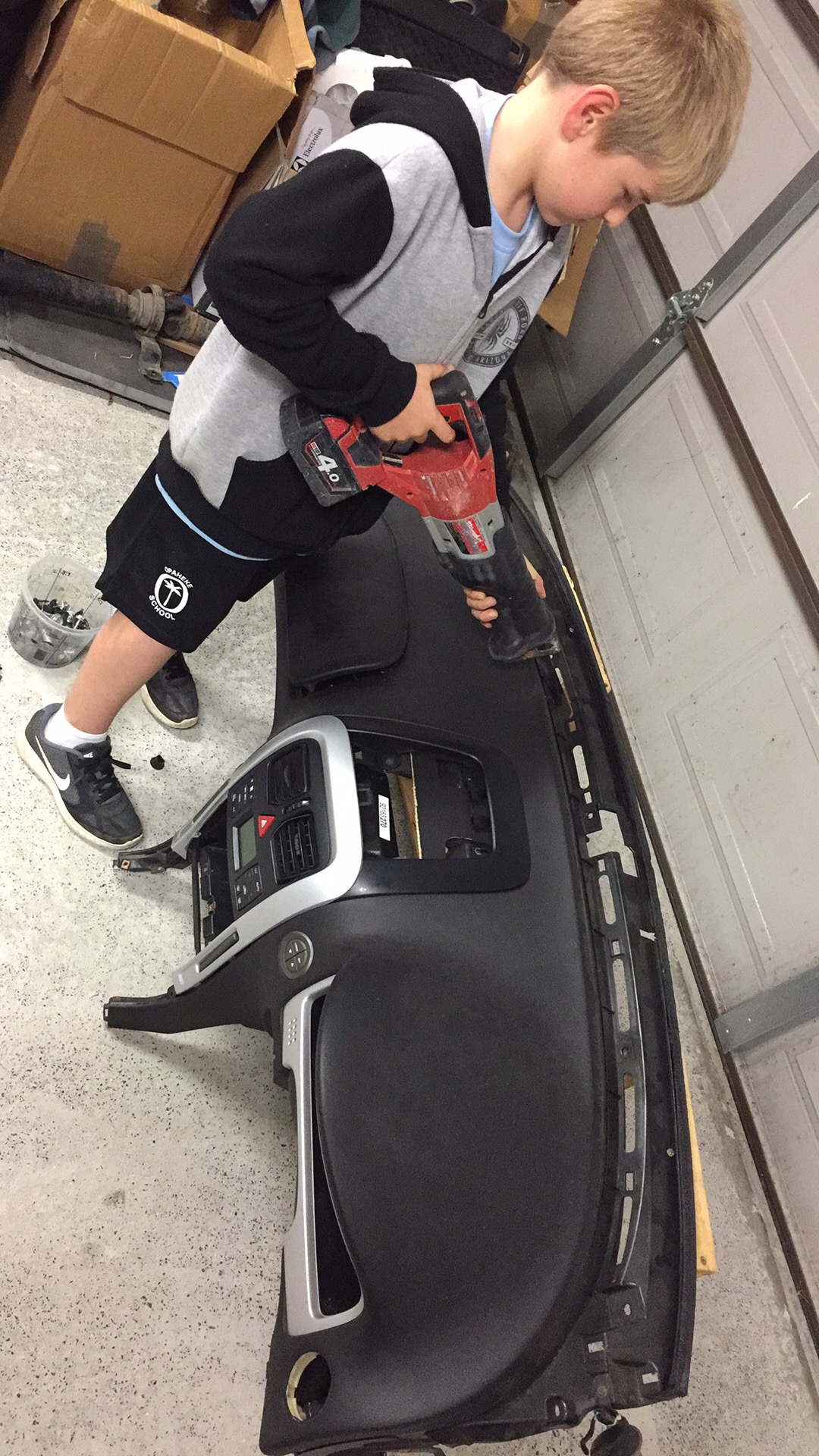

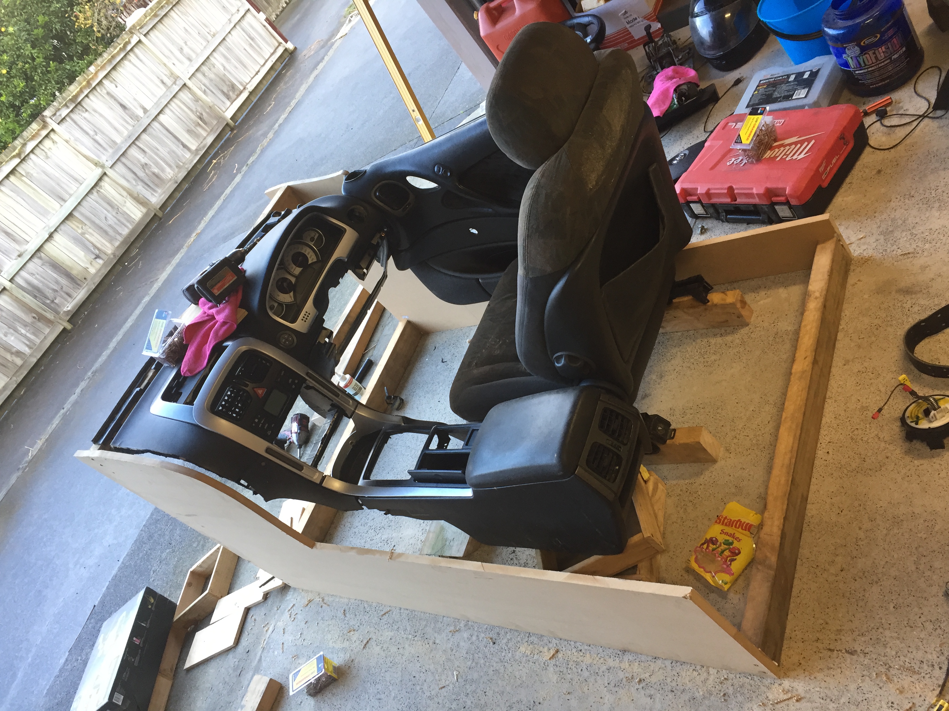

Me and the young fella got to work with cutting it down to a size that would actually get back from the shed to inside. We got everything mocked up to see what we could acheive Went to my local u-pick to find they had just received a Ve caprice.
So I got the steering wheel, colomn indicator stalks for an easy $85

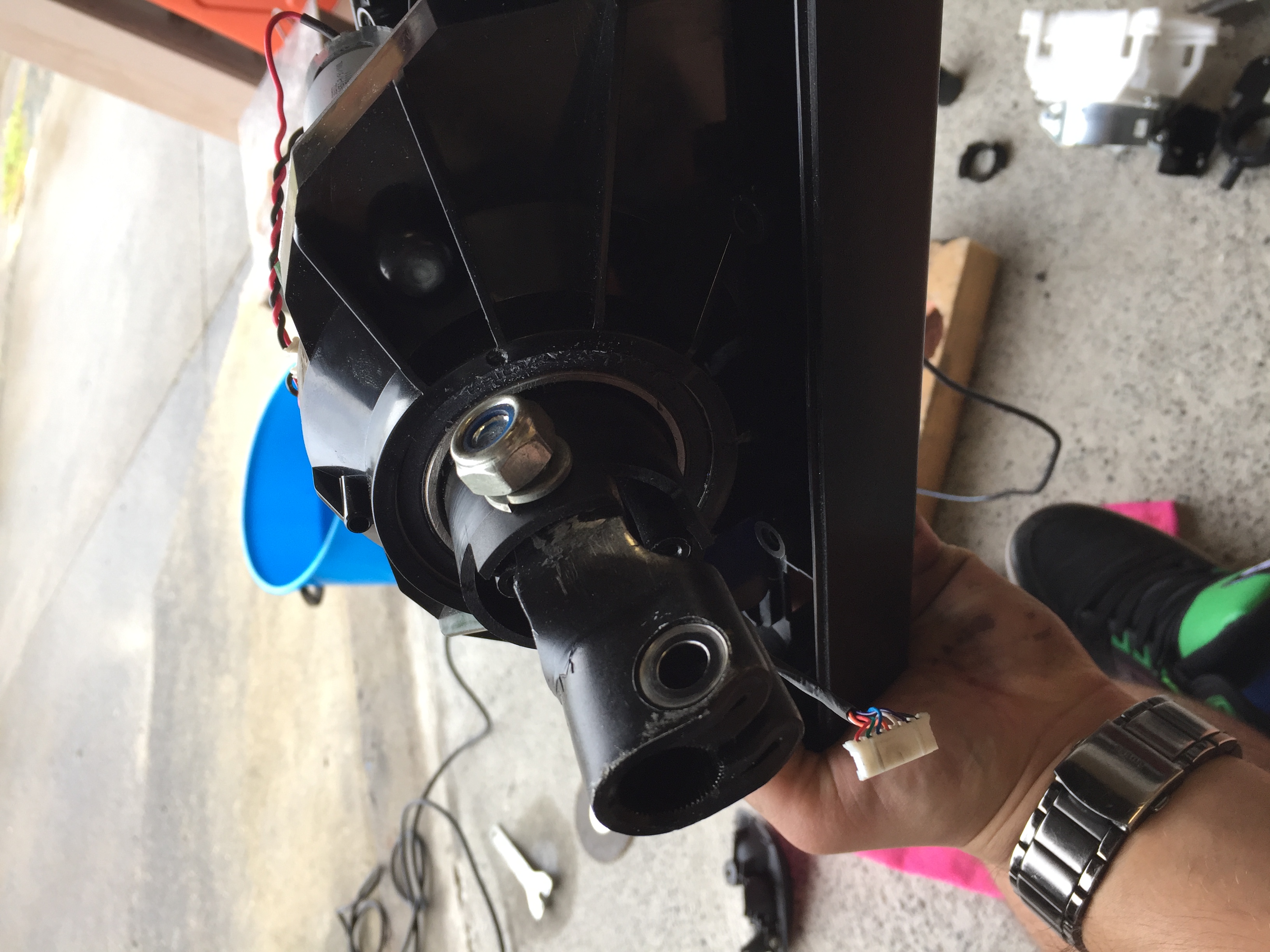

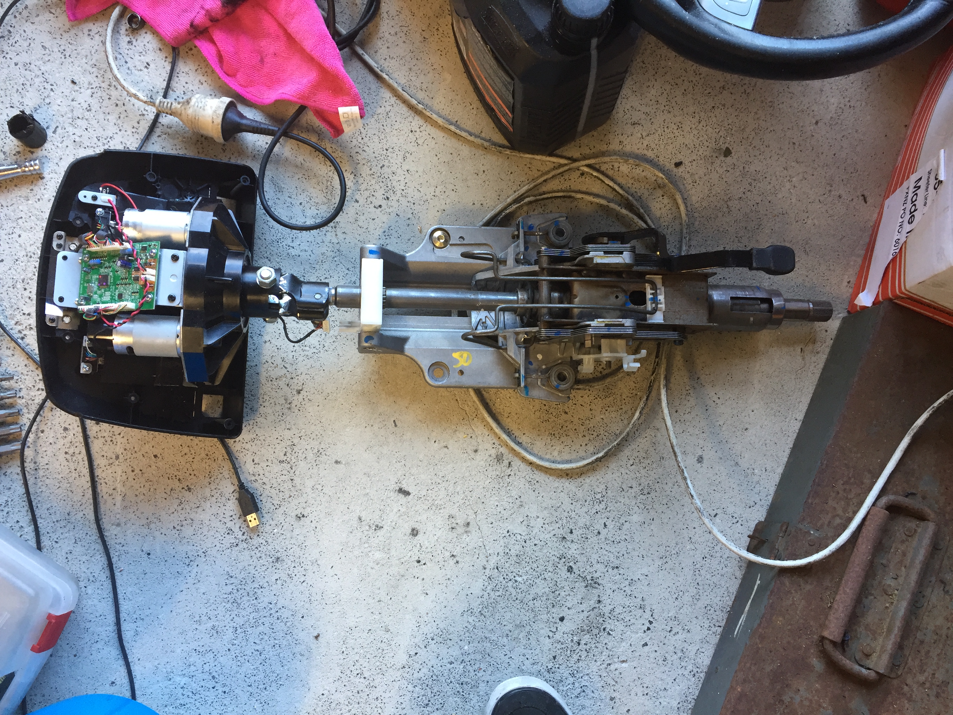

So I got to work with removing the original g27 steering wheel and shafts etc to find a way to mount it.
I cut off the uni joint and ground it back enough to fit snug in the g27s original shaft sleeve

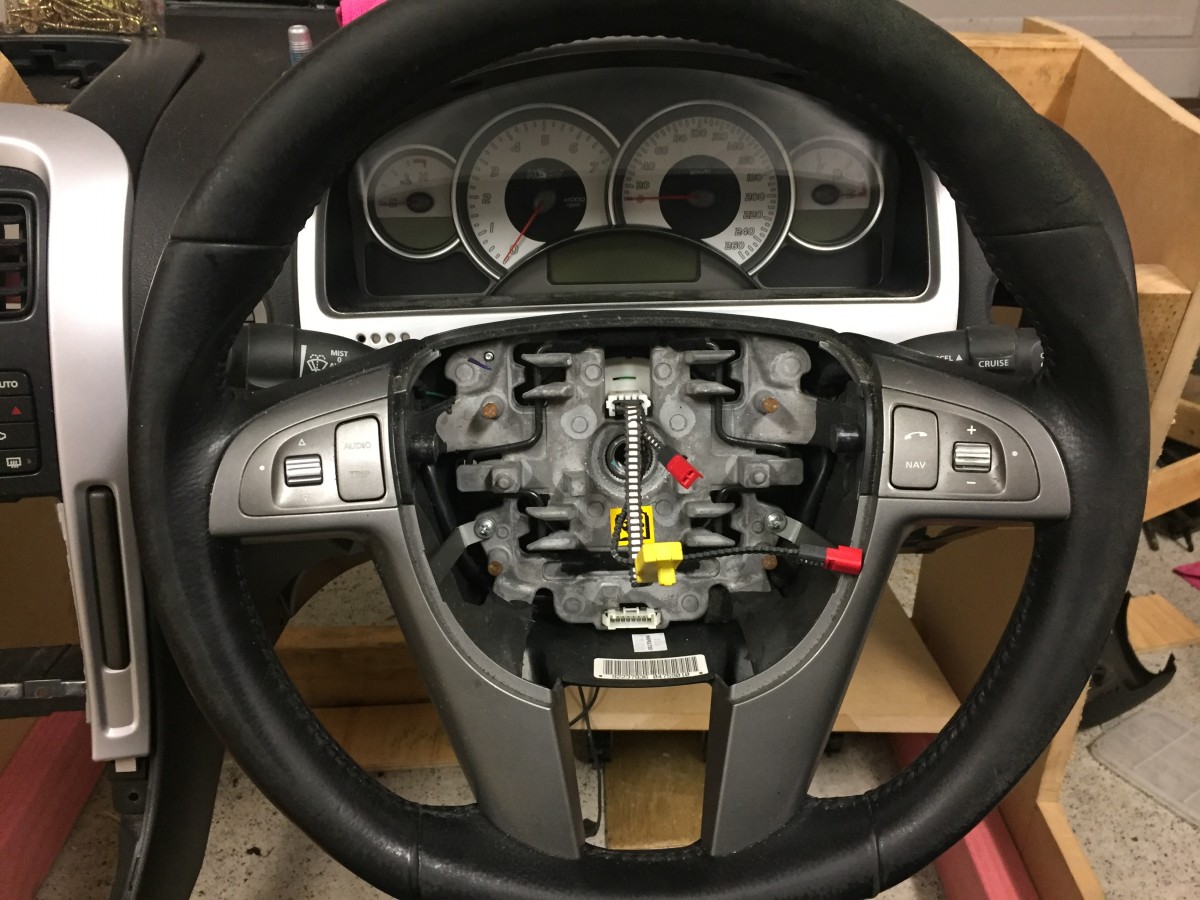

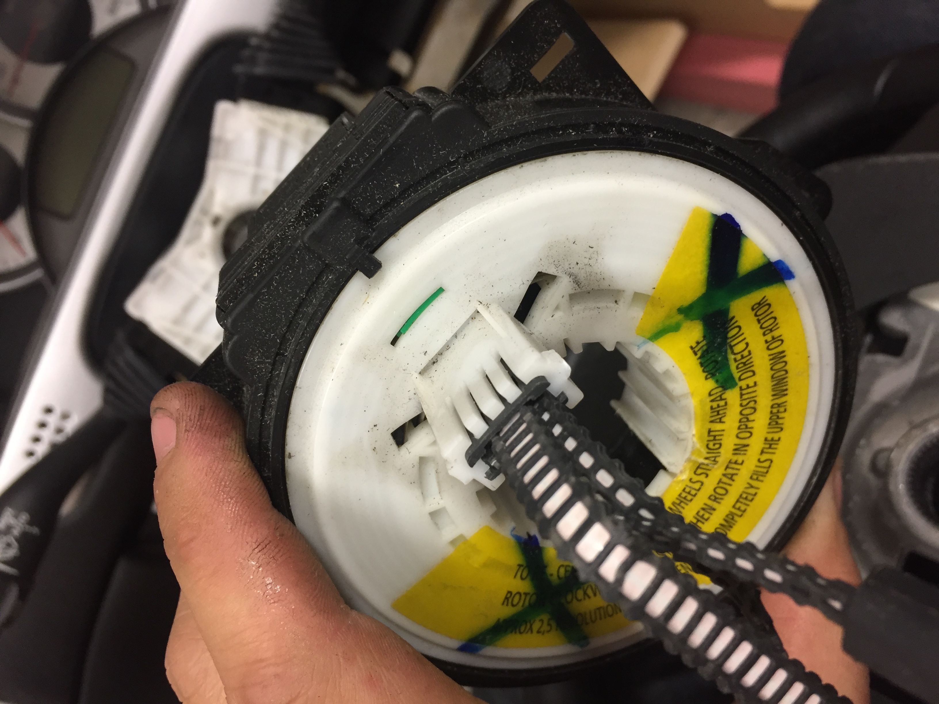

In order to have have the indicators and wipers working and wheel mounted mappable buttons in games like LFS
I needed to have some way to connect the 6 outputs of the original g27 steering wheel buttons to this Ve wheel
So I cut up a vy clockspring to take the inputs to the original ve wheel buttons
The indicators will be remapped to inputs from something like a game pad so the games can recognise them as mappable configurations

I figured this one I want to be as realistic as possible as eventually it will also be running the gauges with the pc games like lfs and rfactor usingbthere outgauge systems and some coding through arduino
This one will be getting a 36" for console gaming like gt6 but have a 3 screen monitor setup for the pc which is ultimately where I want to go with it.
All the cluster and heater units etc will be turning on to give that real feel.
Shifter will be modded and pedals reverse mounted.
Ultimately I want it as real as possible

The g27 pedals have your standard 10k pots on them. So with a bit of fabricating I don't see why I can't get real pedals on there. But that will be one for once it's built.
As for the brake I've looked and loadcells. I will get one once the bulk of works done. I'm trying to find out if a valve spring or a cat converter bolt spring will give me enough tension until a load cell can be brought
Handbrake is also a must. I want to keep it looking orginal so I may hook a detachable hydraulic type handbrake setup an also a normal handbrake both on the same input.
I've also had a brain fart and instead of running the paddle shifters mounted to the wheel
(I'm wanting to not have to cut/drill and of the steering wheel for resale value)
I'm going to run the inputs for the paddles connected to the window washer on left stall (pull back) and the high beams on the indicator to be the other paddle shifter.
That way no hacking up plastics on wheel and also the shifter will always be in the same place so no trying to find the upshift paddle when your half locked.
Looking at using arduino to create a HID but my programming skills aren't that good yet.
So will probably find another joystick or gamepad to hack for their inputs
