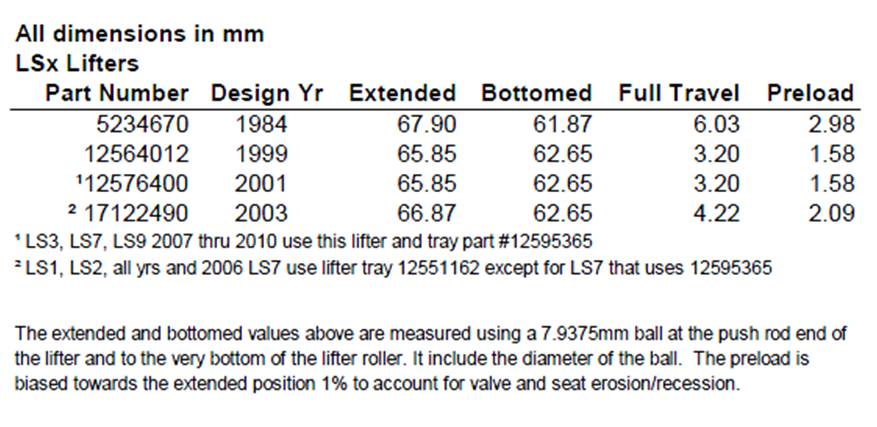

Yeah thats the idea, all you need is adjustable pushrods for length checking and set the preload on the lifter hydrualic to I recall 2.09? mm
EDIT:
Thank buicks for google images. Been nearly 2 years since I found the page with this table.
part number of all LSx lifters from GM now end with 490 so yes, preload 2.09mm on base circle.
LSx Lifter Preload Update.jpg (57.02 KiB) Viewed 3312 times
