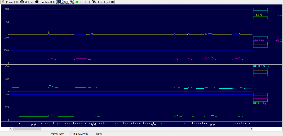

Ive attached a couple of charts which show idle and driving stats. Can add additional graph items if you want to see anything in particular.

I havnt looked at the vid but the graphs look ok. Which point in the graphs do you think looks wrong? Everywhere rpm is holding looks like the car is moving so its probably not triggering idle mode till under 5kph. I noticed similar on mine so i upped the idle kph to 20kph so it triggered when i hit the clutch rolling to a stop and i wanted the rpm to drop.

No the charts look OK to me too but I know little about what it SHOULD look like.
Thats right, its holding revs when moving which makes it a total pain to drive, im waiting like 2+ seconds for it to be at the correct range for a smooth shift.
