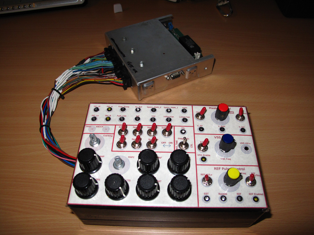

Re: Wanting to build a PCM bench tester??
Ive got a number of tools for simulating on the bench, my actual bench tester for simulating an engine is pretty simple. Its progressed since this shot, as it now has a '424 loom piggy backed and another box to simulate a gearbox. Its missing knobs to send vlads OCD over the edge.
Bench And ECM.jpg (276.35 KiB) Viewed 7334 times
You dont need a full 18x3x plus cam for testing a V6 PCM except if you want to trigger via the ign module. Feed directly in to the PCM and both V6 and V8 really only need a square wave input (plus cam if you want to sim seq/banked injection). I've only got a simulator for triggering a factory ignition module or my custom module, it does stacks of factory triggers using an atmega, but the bench above just spits out a square wave via a 556 timer, one for RPM and one for VSS. Has worked well.
PC side I have an ALDL simulator that simulates either a PCM or a vehicle to test how a PCM reacts in a car or ADX development via TunerPro or a Logger.
Having spent hundreds of hours testing code of the years, having an engine playback mode, while neat, is pretty much not required. A static test bench works for 95% of the cases as you are normally wanting to see how code reacts with certain inputs, its only been a couple of times I wished mine had some smarts to it when chasing down a code bug. For the rest of the time a static bench is actually better as you can test the exact response of how values are picked out of tables, or what a single sensor change does to the spark or fuel delivery. Even for ALDL development, static is the way to go as you can change just coolant for example, will see only a couple of bytes change rather than the whole stream.
