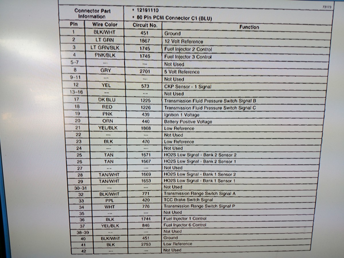

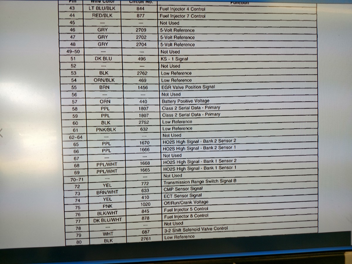

Don't have it in front of me, but I have alldata. I can pretty much pinout any pcm. Best I can remember there is not an oil temp circuit..... Will check tomorrow and get back with you.

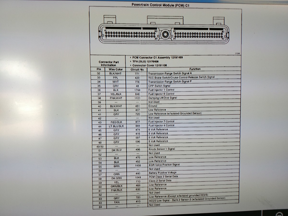

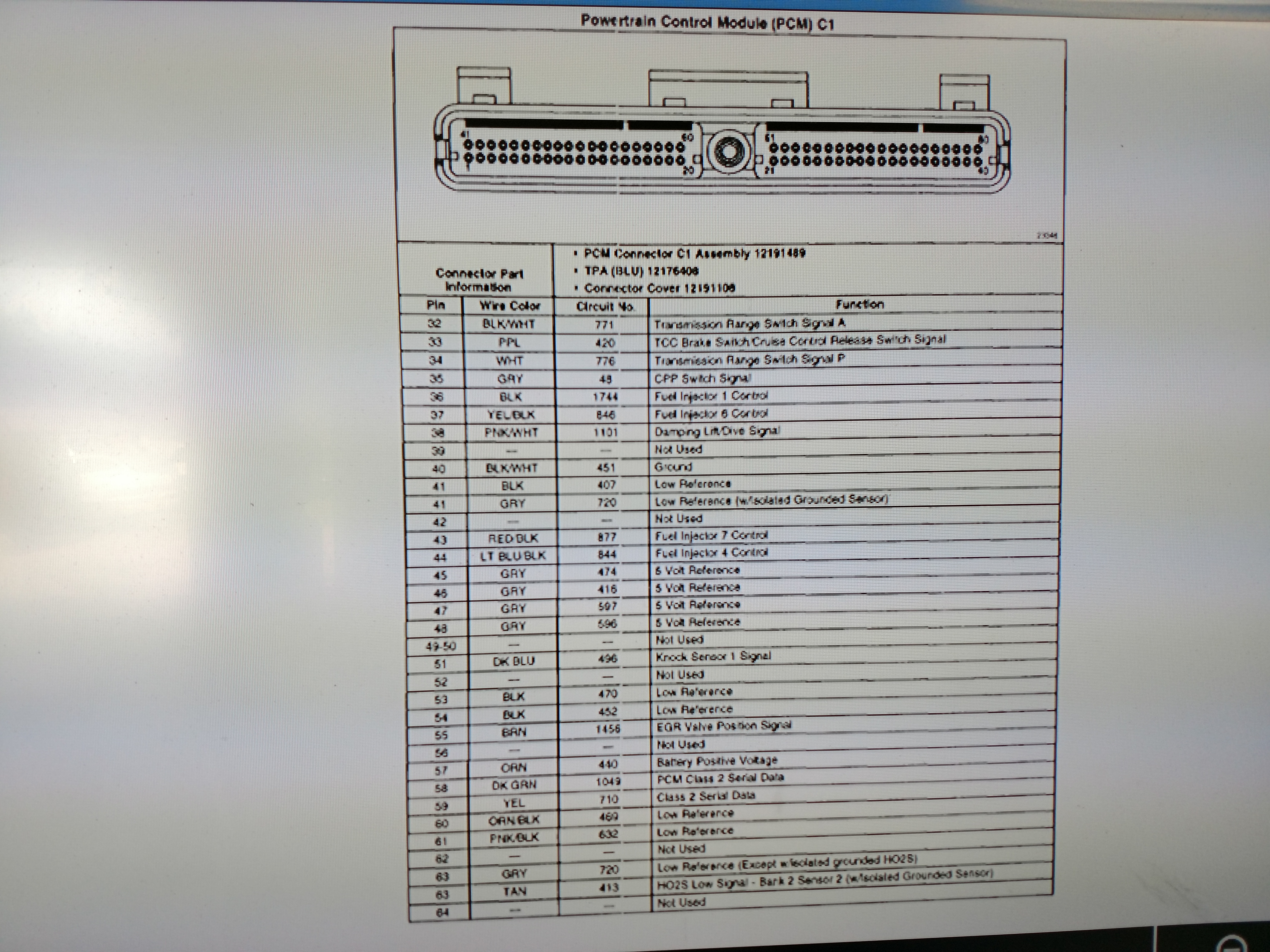

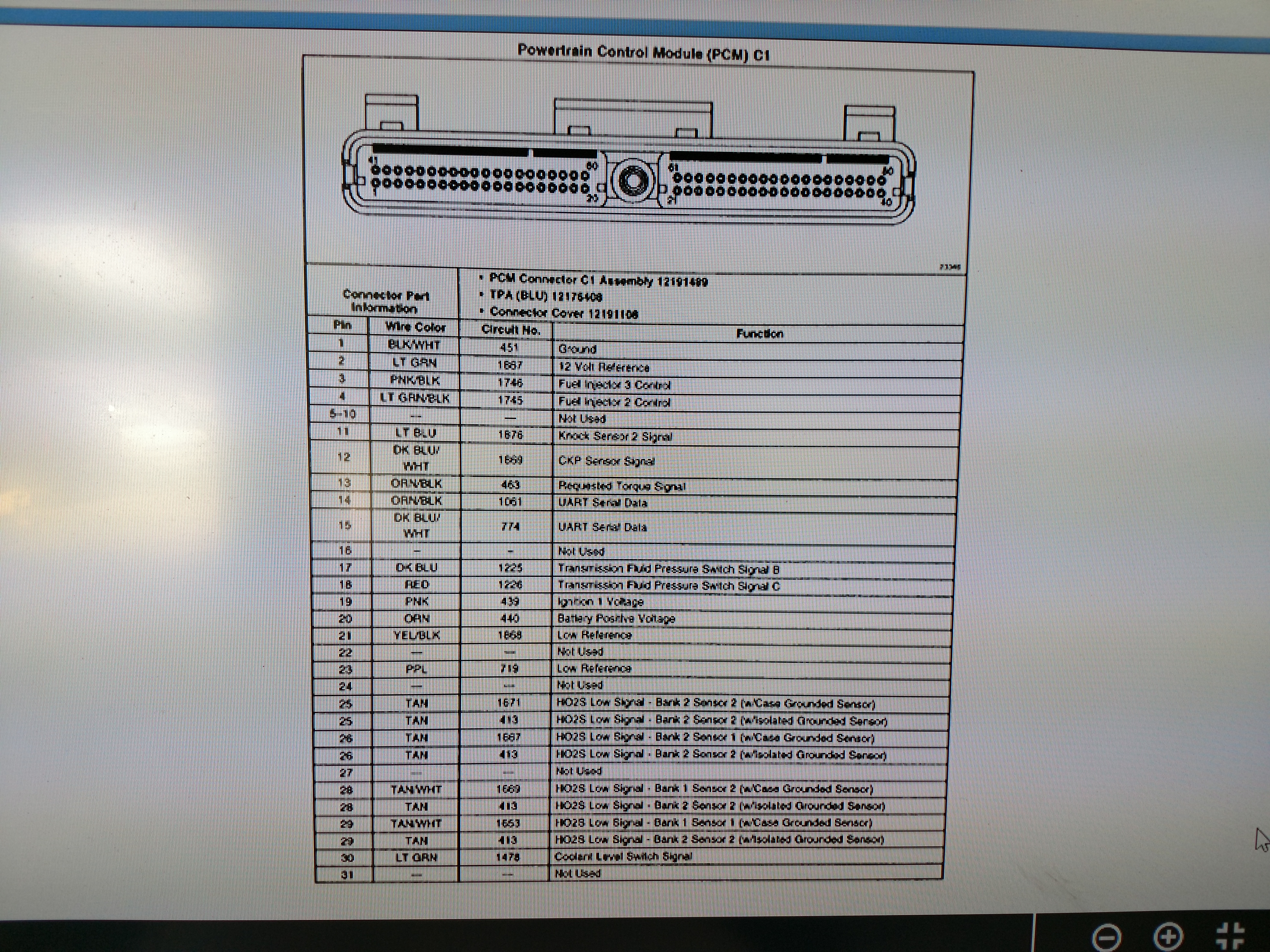

Seems like it matters the application. The first two are for 01 express van 5.7 the second two are for 02 k1500 5.3.
