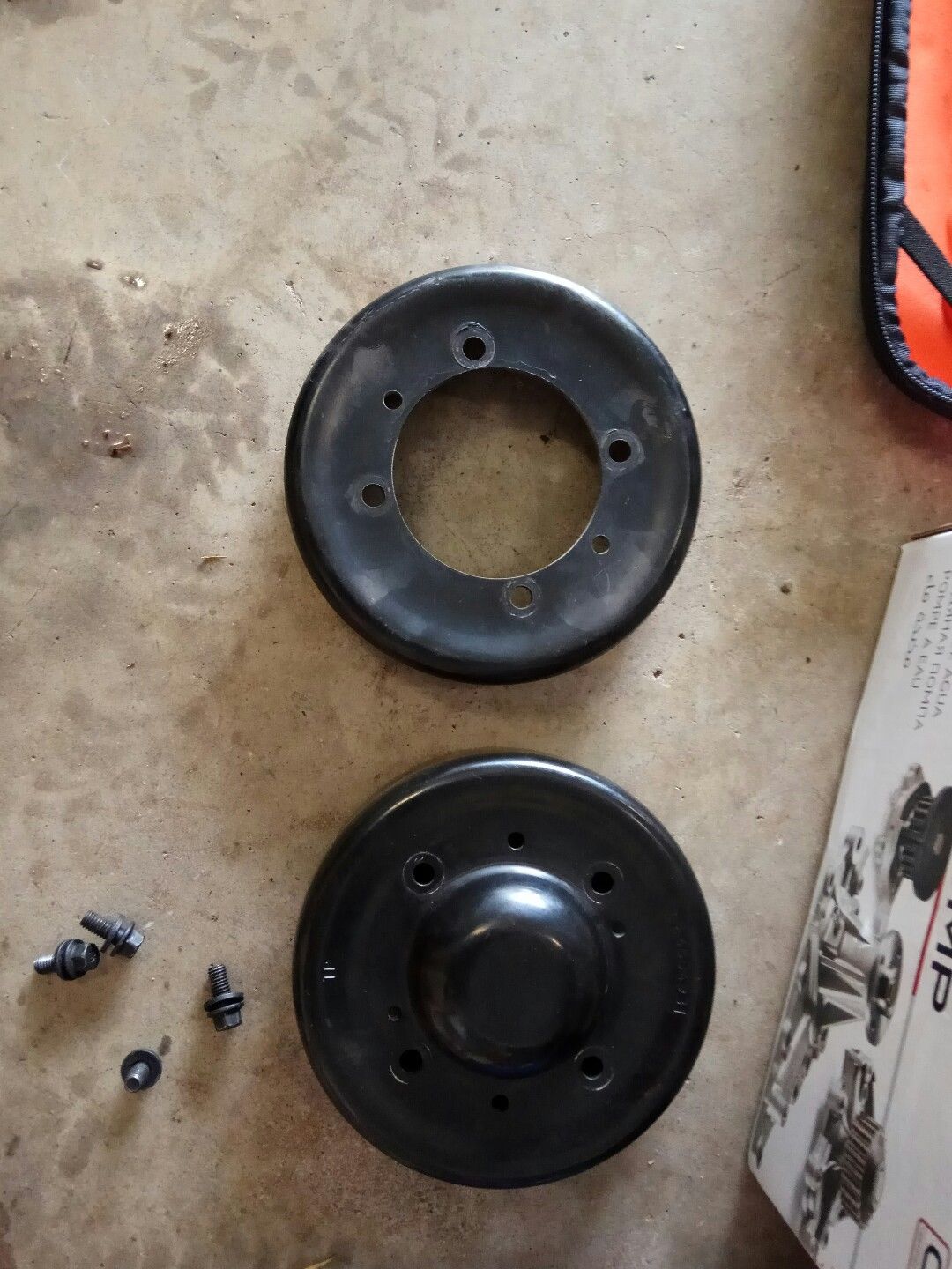

As the title has anyone seen the ecotec pulley for waterpump with no centre hub? i have one on my VS which i had to use on my VX due to the pump having a larger hub in the middle, but im having trouble finding another one, perhaps it was cut before got the car? All other pulleys have the hubs enclosed.

buick ones have no center

I run a underdrive water pump pulley and it has no center and sounds like what your after.

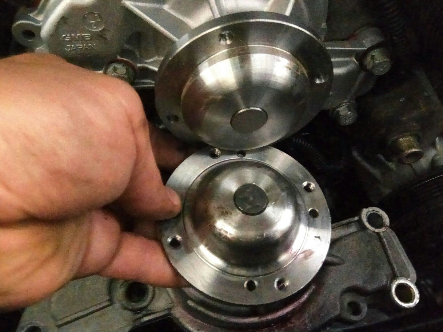

Here's the hubs and also the difference in GMB vs GMB Japan, the one with the hole allow you to run the one with a bigger centre hub.

Just cut the middle out? Can get a nice scribe line to follow.

Like vlad said, I had to use the pulley off my VP buick engine on my replacement ecotec pump... fits perfectly.
Thought it odd too. Sadly it was my only spare sorry.

Yeh might have to buy a holesaw and cut it.
