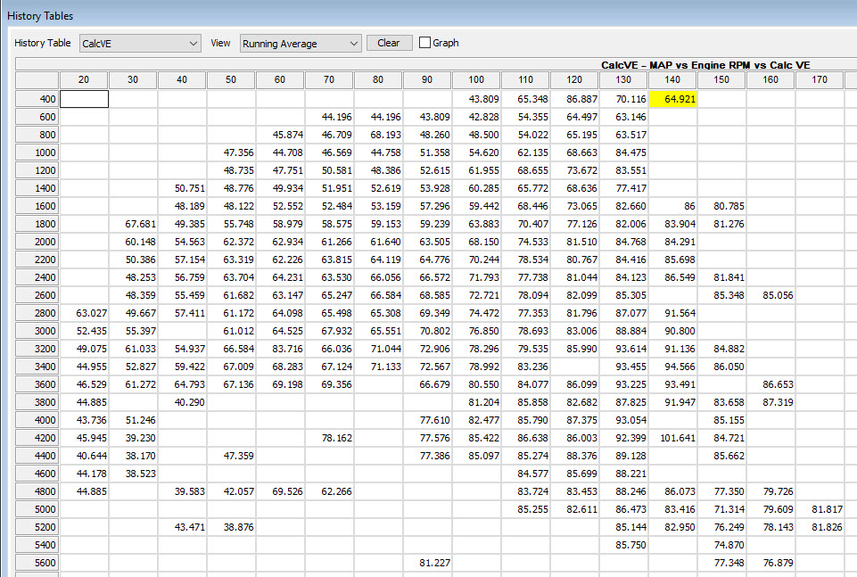

Thanks for the help so far people. Here is the latest copy of the bin which includes some more VE calc data.
Holden202t - is there a VEcalc boost history table? Or is this a 2 man live-tuning job only?

Re: 202 Turbo Tuning Gremlins - Cleanup Help
RedWagonVC wrote:Holden202t - is there a VEcalc boost history table? Or is this a 2 man live-tuning job only?
Edit the ADX and either create a new history table, or like I did, change the BLM/wideband table to use calcve instead of ltft - its setup for up to 200/300kpa depending what map your using.
