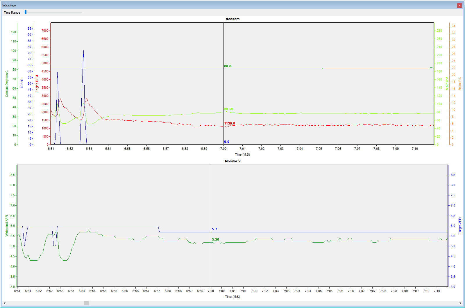

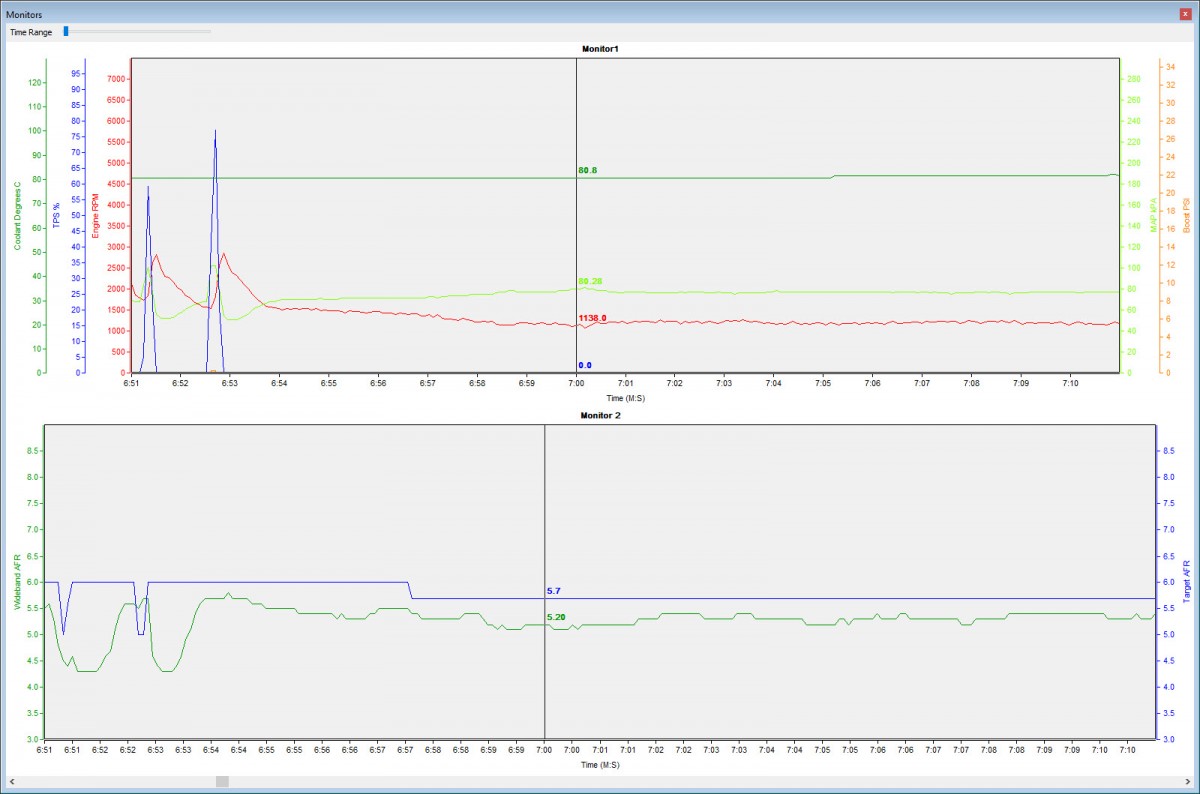

Wouldnt the target AFR in the monitors be the effective target AFR, whether than be idle vs coolant temp, main target afr table or any other?
Re: 202 Turbo Tuning Gremlins - Cleanup Help
that's correct, in as much as its what the ecu is commanding, target AFR will change to a richer value as it moves from open loop AFR table to the Idle AFR table.
you can see in the example below, after a rev at 6:53 it comes back to idle and then 5 seconds later the idle AFR goes from 6.0 to 5.7 (methanol)
