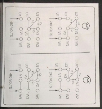

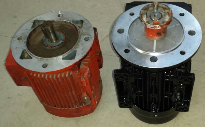

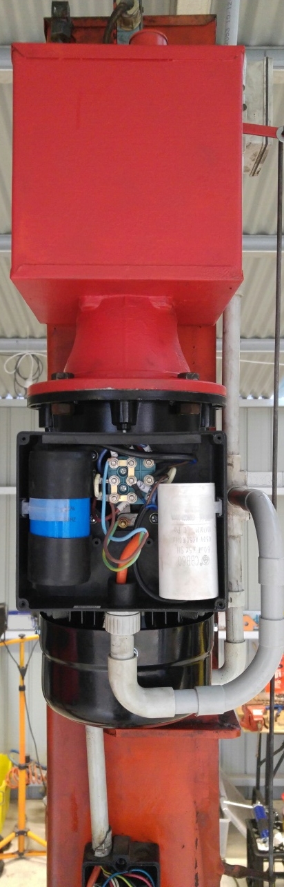

I did score a win with the local engine shop. It turned out the engine was a standard ML90L-2 frame engine with a B3 foot mount, so I purchased a single phase engine. The B3 foot mount had holes 45 degrees rotated from the original engine, but the hydrolic reservoir had 8 holes so included support for both footprints. Once received and opened up it was interesting to find that it still had the same 3 phase coils and a start and run capacitor similar to the mods on the internet for converting a 3 phase engine to a single phase engine. The new one also still had the bridge network for 415 or 240v but also rotation direction. I got the engine shop to swap the coupling over saving me the risk of breaking it not knowing what im doing and the new one bolted straight on. The bridge network needed to be swapped for clockwise direction and a quick test showed all is well.
The other thing learnt is that the coil in the magnetic starter was a 415v coil and not strong enough to actuate the contacts at 240v. That also needs replacing.
bridge network.jpg (62.97 KiB) Viewed 5085 times

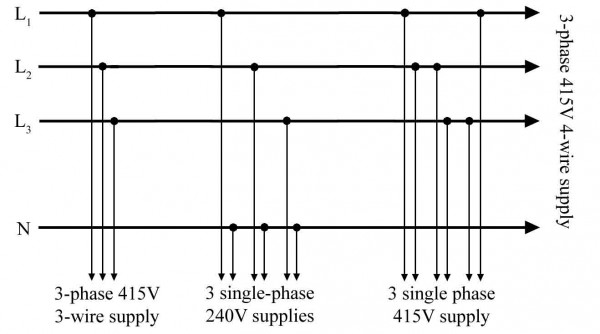

Just to dig this back up, eventually I did confirm that you can get 415v between any 2 phases in a 3 phase system. So, probably, my original engine would have worked just fine with the street 3 phase supply. To illustrate the options for voltages though I just found this image from http://www.itacanet.org/basic-electrica ... -phase-ac/ which shows it quite nicely.
A 3-phase 4-wire supply carrying 240V in each wire.

Thanks for the offer. Yeah I got it going, I purchased a 240v coil for the mag start switch, which almost fit. After a bit of cutting it fit in there and with the original switch is working so the 240v conversion was completed. The gotcha for me was the voltages. I missed the fact that single phase 240v is between neutral and ground, and 415v is the same circuits, but between two phases. The higher voltage is from the difference in phases. My mistake was that I thought residential 3 phase was 240v and industrial 3 phase was 415v. Ooops! The whole conversion would not have been required if got the 3 phase feed from the house run to the shed and cost would have been similar to the conversion in the end. Oh well a working solution is better than none.
