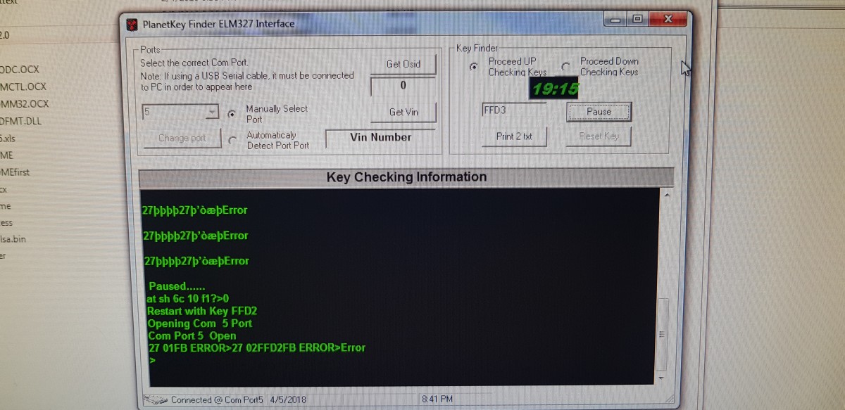

Hey guys will this work with an E67 LSA ecu?
I'm trying it now. This is what it looks like

Re: Seed/Key Osid and Vin retrieval via Elm
Does not look right with all the errors. We have a new tool under development now for earlier pcms but e67 would be later.
