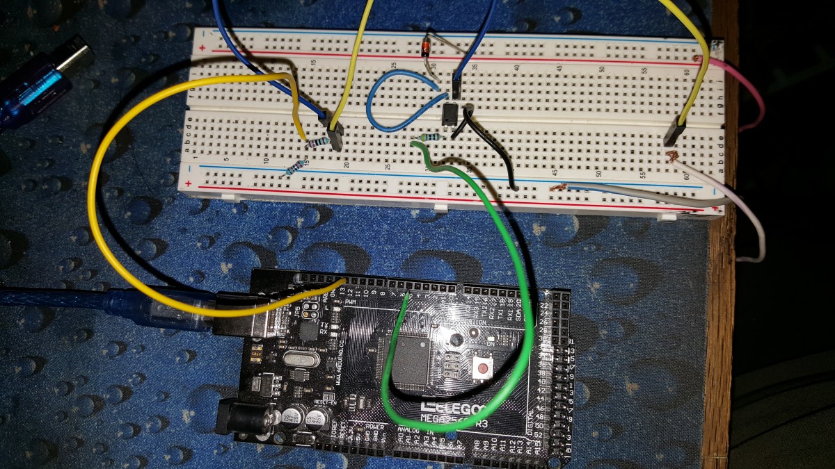

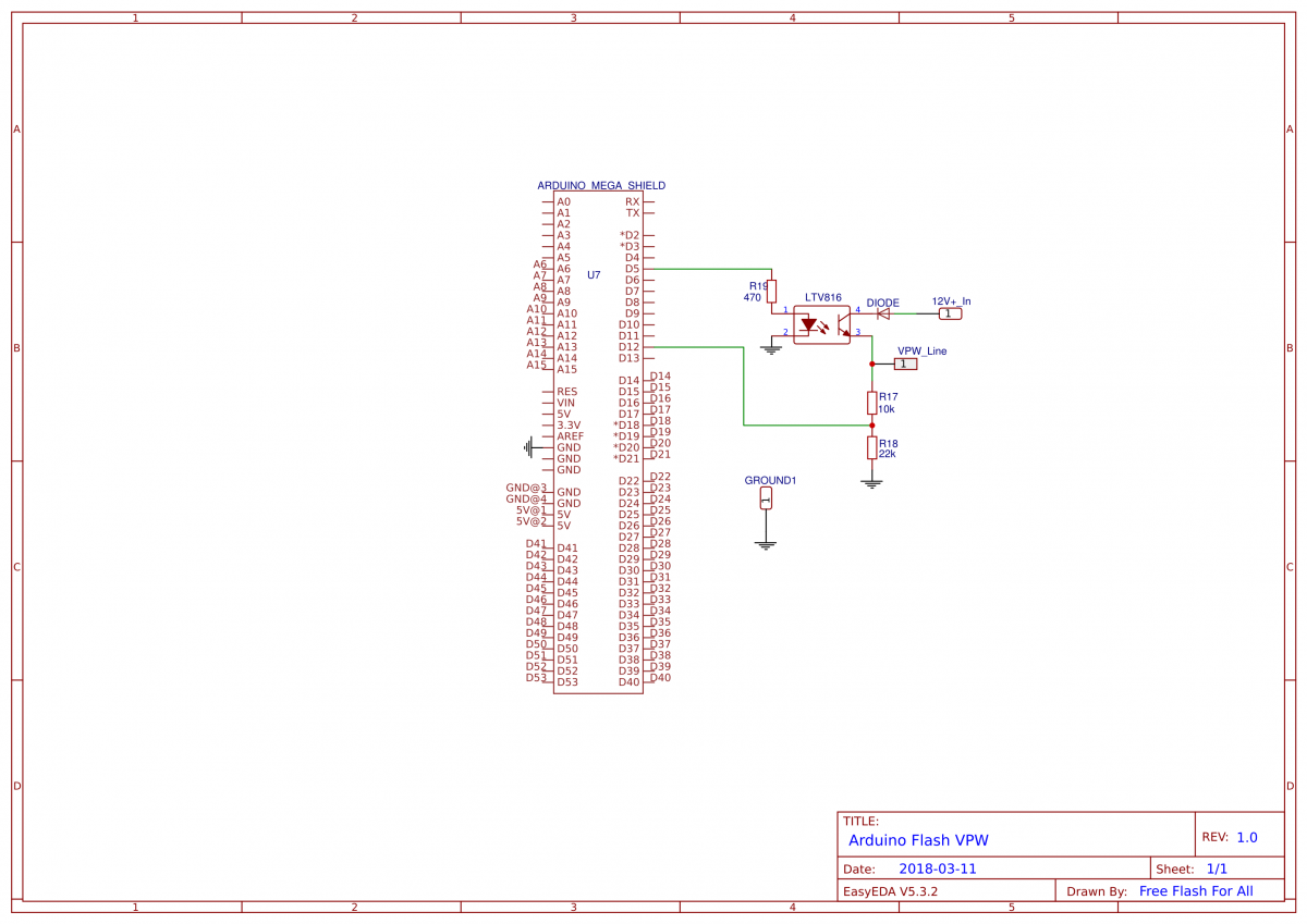

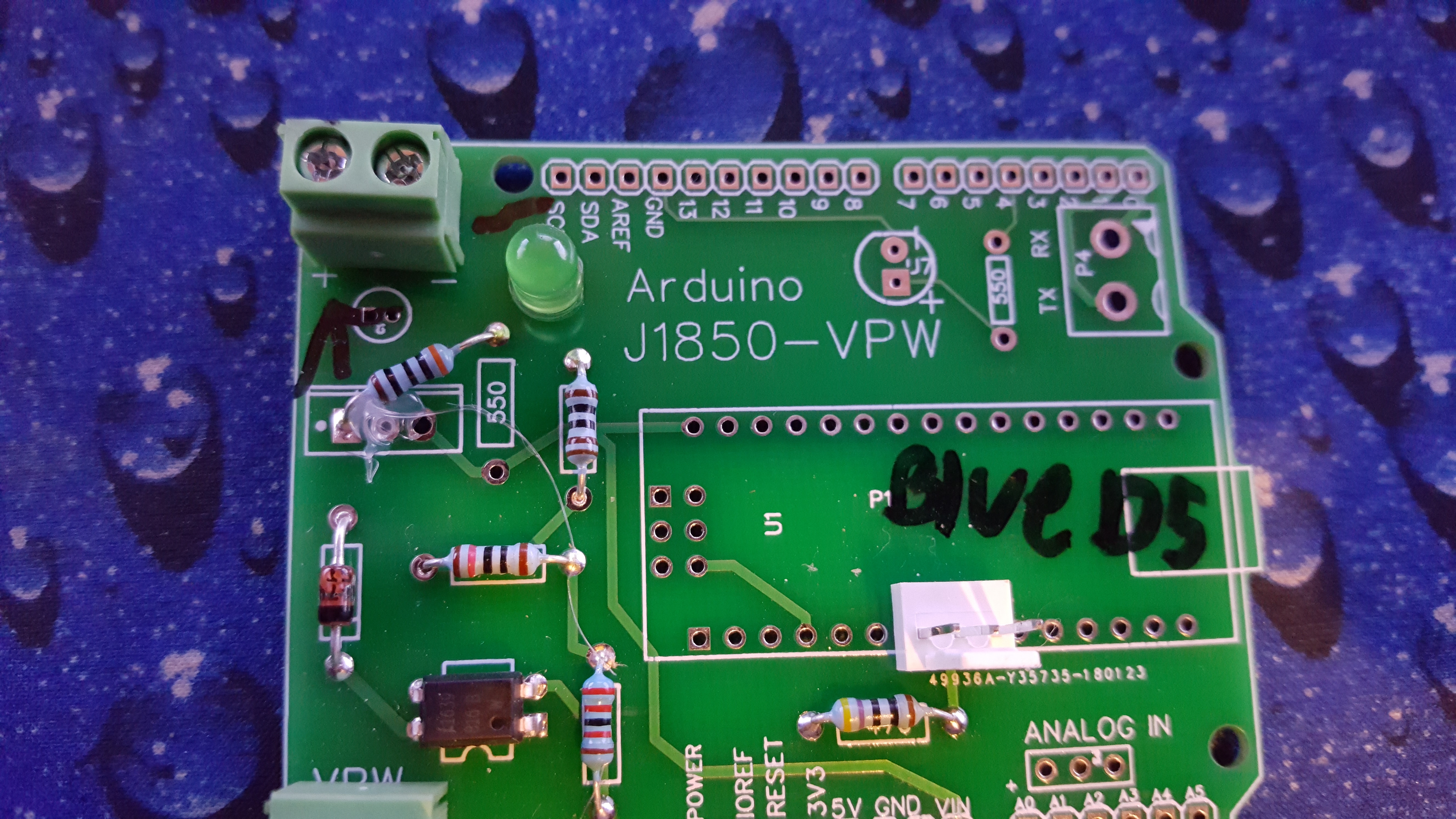

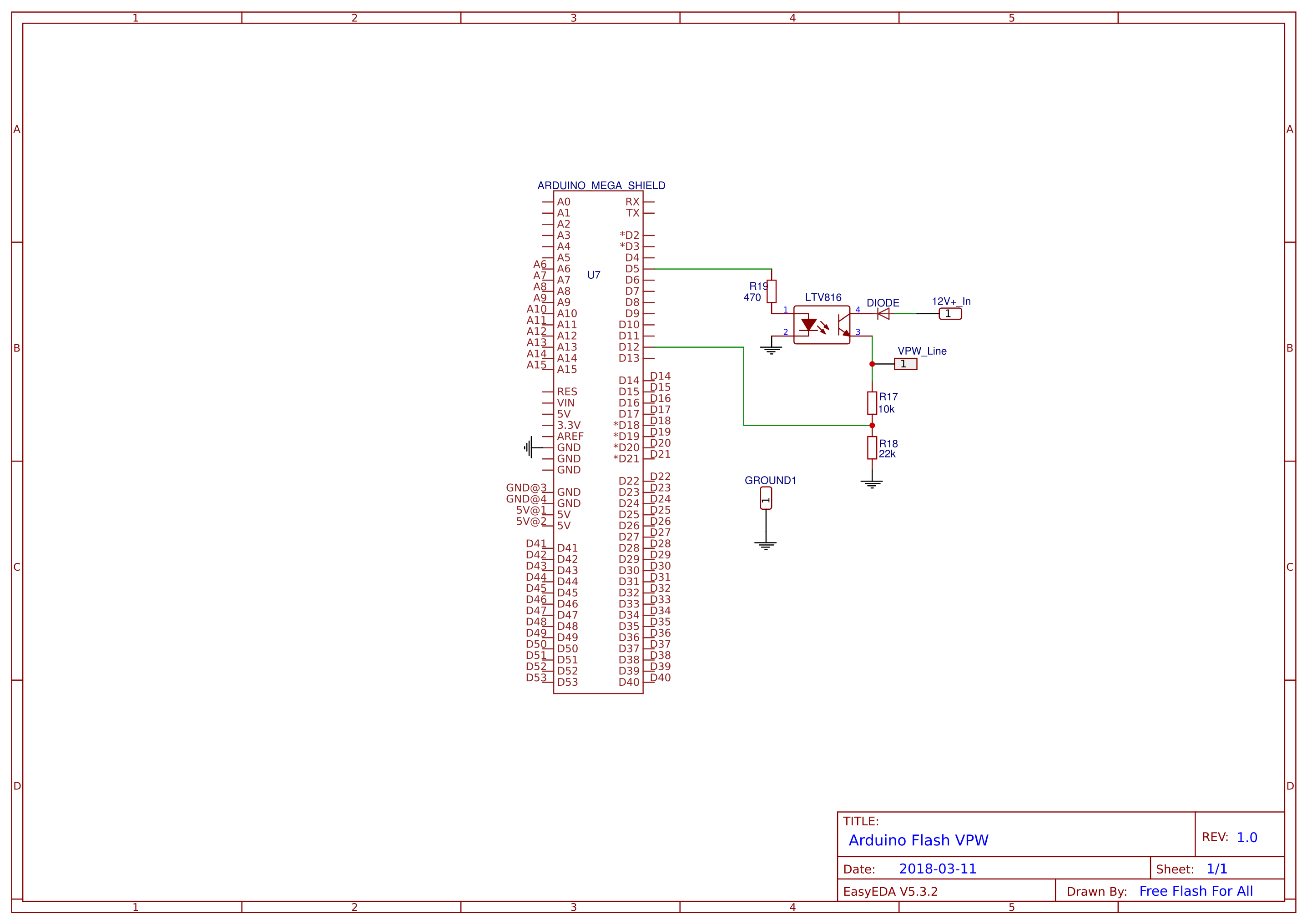

This is a hacked up version of the original 2 Arduino Vpw circuit that I sent Nsfw for testing just so he wasn't using a bread board. Once we have 4x working I'll have another round of pcb's made for people to use while working on this project. We've have somewhere around 40 notable program revisions and some significant hardware revisions over the course of this.antus wrote:Interesting stuff. Got any pics of the hardware?
This was most recent version on a bread board I was working with over the weekend, however the design has changed again slightly since starting on the 4x mode.
The simple version of the circuit

Re: Open source GM OBD2 flash tool using a ELM327 device
This was what I was referring to, where timings become so small and critical, that a single bit that is out will ruin an entire block send as then the VPW crc checksum will be invalid. Whether its the sending or receiving at 4x, its likely both are causing dramas, as your in the low microsecond level of timing160plus wrote: 4X mode is working for monitoring currently but we are experiencing trouble transmitting larger blocks over 4x. We are getting an incorrect byte translation when we send the third part of the flash kernel we've been using. Some more tweaking of the circuit and timings and there's a good chance we'll have 4x working in the next week or two. While in 4x mode we can "Poke" the pcm so to speak to keep it in 4x mode and even after running for quite sometime the smaller blocks are still working fine so we figure it's close.
Id rather wait 8mins, then risk reliability for 4x.
