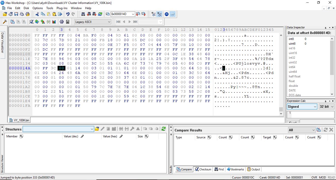

So I'm trying to turn on the digital Speedo in my VY Series 1 Cluster.
Here are 2 screenshots of the hexadecimal location to turn this on:
So my question is pretty simple: what would the hexidecimal command be to change that bit from 00 to 01 using OSE Flash?
Cheer's guys!
Posts: 9004
Re: Turning on Digital Speedo - VY VZ OSE Flash
I cant give you the answer your looking for because I dont know, but I believe it'd be a security challenge then something like an aldl write with a length of 1 to that address with payload of 01. To get it though you'd probably want to set police mode with a tech 2 while logging with the oseflashtool then post the logs up here for us to pull apart. There probably would be a lot in common with the security challenge of the vy pcm, and probably the aldl write too. It probably wouldnt be too hard to figure out.

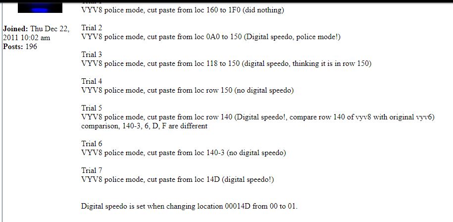

Post by Tazzi »
If your happy looking at hex and bins, then youll go better and faster by just making the change direct to the eeprom and following the locations Iv posted up in that thread you took a snippit of. :thumbup:

Posts: 3547
cars: VE SS Ute
Location: WA
Post by Tazzi »
Unless that floppy disk cable has some sort of logic/device connected to it.. its not going to be of much help.
Eeprom programmers are dime a dozen on fleabay, they also pretty cheap for basic ones. My first ever one was $12.
When it comes to playing with electronics, trying to cut costs will almost always cause misery. You'll want to also purchase an eeprom clip so you don't end up melting half the board away trying to remove the eeprom.
At no point should a soldering iron need to go near a board. Just clip on.. and away you go. Thats how I did it back in the day. :thumbup:
