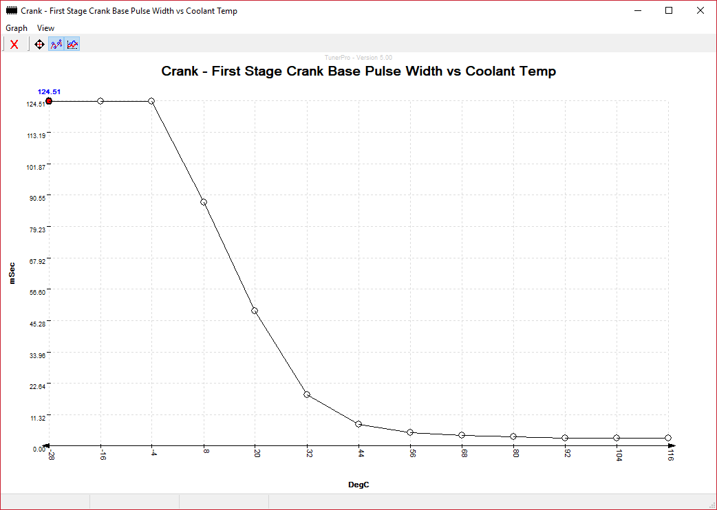

And actually I didnt mention it in my post, cold start is difficult to begin with. Was thinking it must be wrong needing to add so much fuel. This is for winter, summer 'cold' starts are pretty much just using petrol cranking numbers. So I am talking < 20deg ambient temp, seems like a switch where things are good then all of a sudden cranking fuel requirements sky rocket. This is my cranking table, a few seasons in the making to get here...
