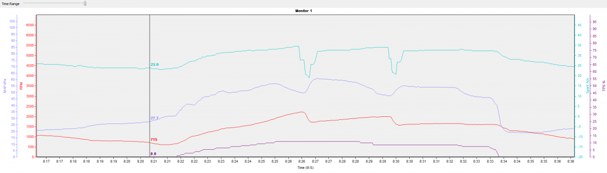

There is no spark retard on shift in 11P V104. But it can in the beta version I run, light blue is advance...
