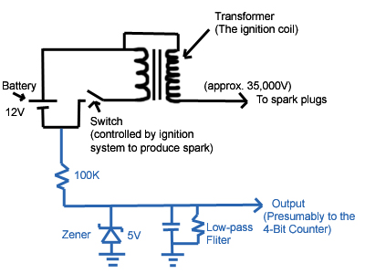

You could easily just use a high value resistor and a zener diode for whatever voltage you are wanting to clamp to. also a low value capacitor may be good to filter out noise and the flyback voltage. You don't want too high of a value for the capacitor that it start distorting the signal.

I agree with fl0wfl0w - there is a such a design documented here: http://www.dgp.toronto.edu/~mccrae/proj ... ignal.html
Its probably overkill for you but a clear writeup for the less experienced so ive mirrored the content here in case it disappears.

Re: Coil negative signal conditioning
Thanks for the help guys.
I was thinking something like that would be enough, but pretty well everywhere ive seen online has used an optoisolator. Is that just overkill?

I spoke with my sparky mate and we both come up with;
Coil -ve -------> 100K resistor ------> 5v Zener diode ---------> to PCM
will be testing once i get the materials, using a VS PCM (16176424) with 4L60e standalone.

My understanding is the zener diode needs a minimum amount of current flow to function, so even though its a tiny amount and for a short time, the PCM could see well over 5v until the zener breaks down and starts conducting. I'm no expert so I could be wrong

I'd suggest a TVS diode and 5w resistor, that's worked well for me in the past. Zeners are designed for regulation, TVS (transient voltage suppression) diodes are designed to clamp high energy spikes from things like ignition coils.
Another method that is better in some regards is to wind ~100 turns of thin enamel wire on a small bobbin core, and slip it over the #1 HT lead to make a 100:1 torroidial transformer.
Add a rectifier, and play with the number of windings to get a pulse voltage level that suites your application.

Not really, you'll just get an under-voltage, not an over-voltage, if the zener current is too low.pman92 wrote:My understanding is the zener diode needs a minimum amount of current flow to function, so even though its a tiny amount and for a short time, the PCM could see well over 5v until the zener breaks down and starts conducting. I'm no expert so I could be wrong
