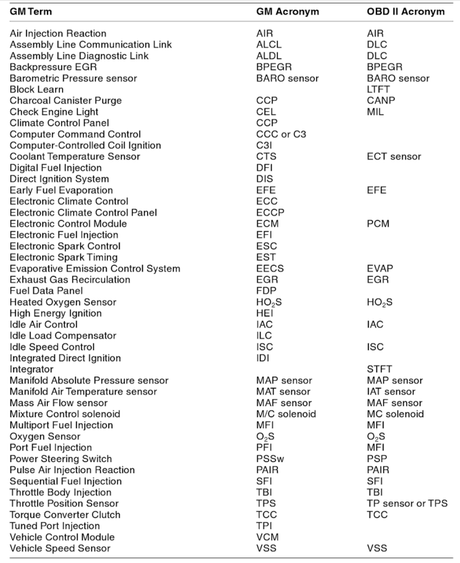

antus wrote:Edit: Claimed ESC is Electronic spark control, but its not..... Thanks delcowizzid for the pickup.
Yeah that does get confusing, I was sure the abbreviation "esc' meant electronic spark control from when I did tech, though it was a fair while ago.
So what does it stand for in this case.
EDIT: How come the esc in this case doesn't stand for electronic spark control when GM refer to it as that.

Posts: 8991
Re: OSE12Pro A/F Maps
Ken wrote:How come the esc in this case doesn't stand for electronic spark control when GM refer to it as that.
The great thing about standards, is there are so many to choose from! :lol:
ESC = Electronic Spark Control = Knock Sensor.
EST = Electronic Spark Timing = ECU controlled spark advance.
Its always been this way in GM land, and 12P and 11P use the terms/standards above as defined by GM in the 80s.
